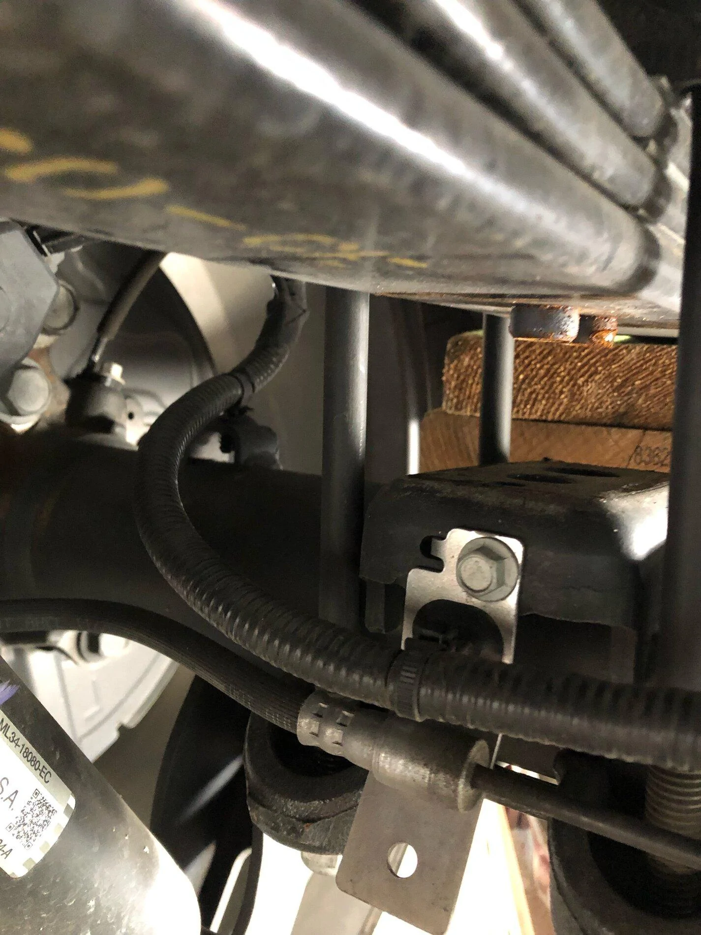

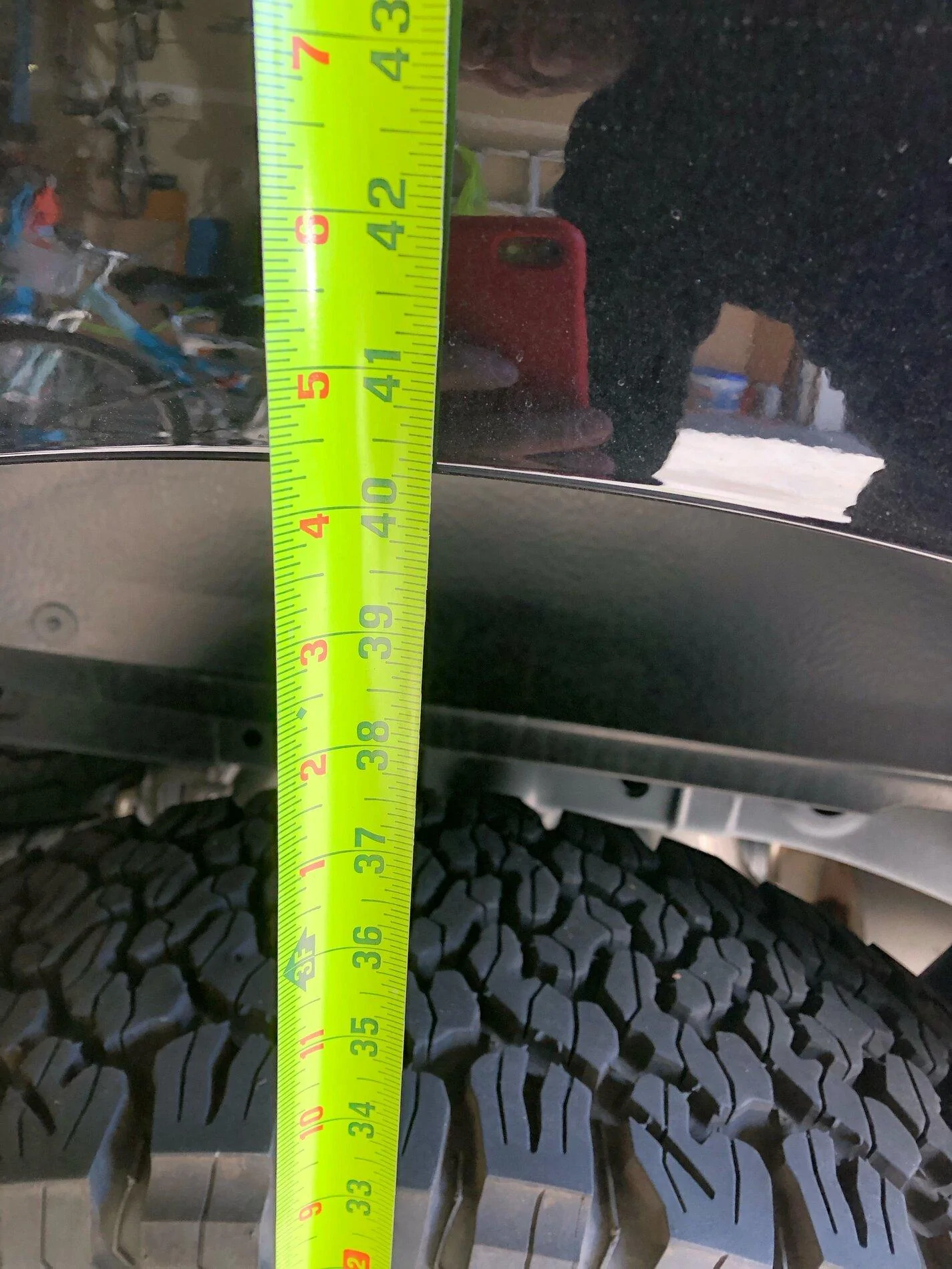

Removed the blocks and added a lowering shackle.
Looks nice. Has the ride changed much? I removed mine and the ride seemed too soft so I decided put them back in the next day.

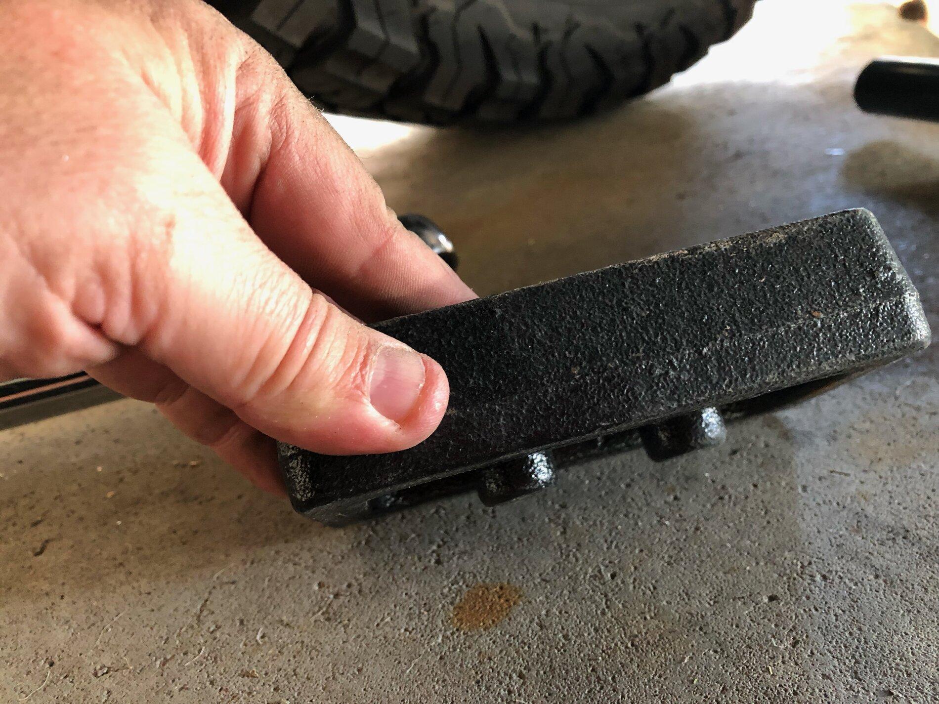

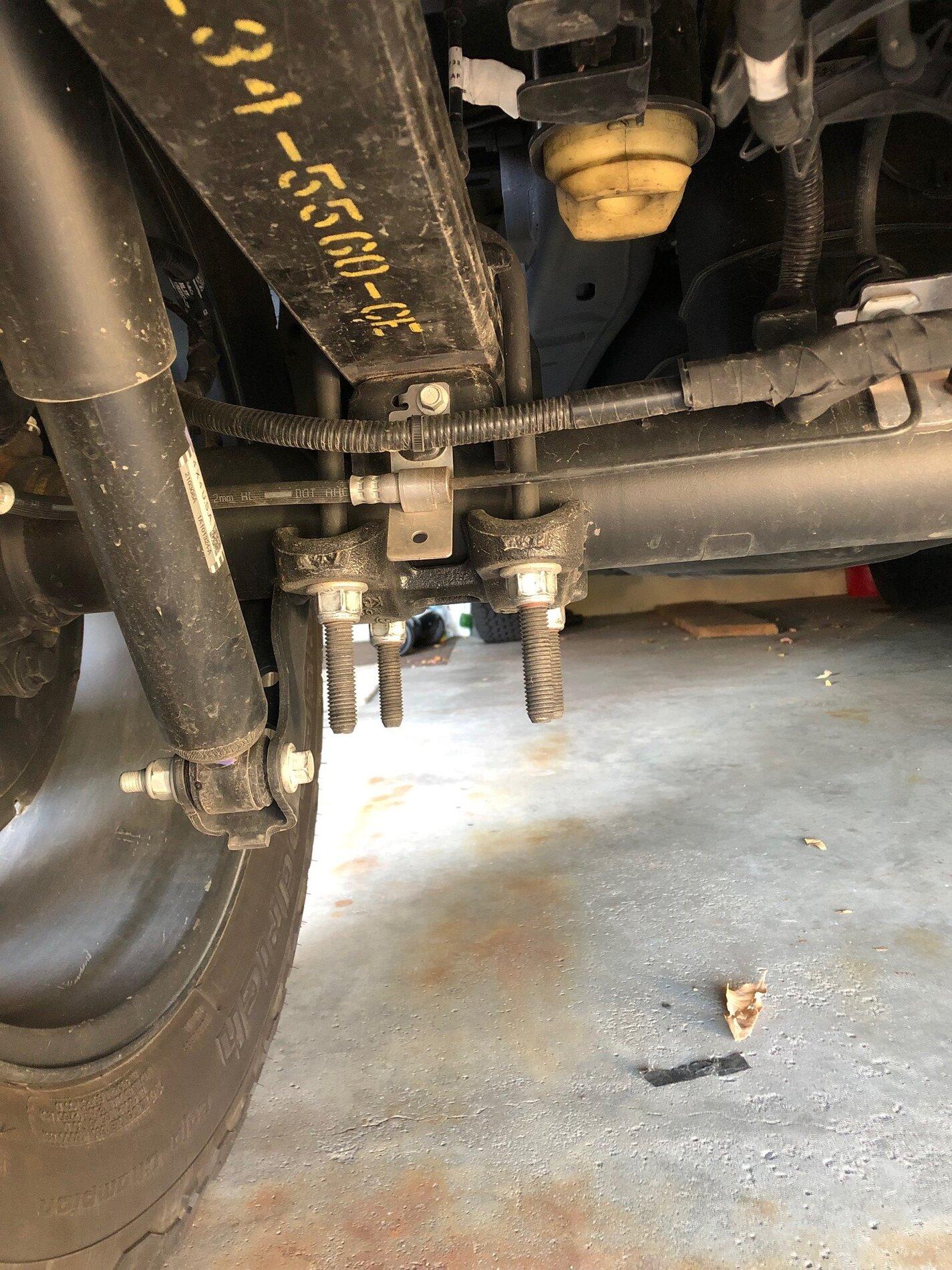

I didn't have to modify the bed
ribs. I also removed the axle blocks. I did add a 2degree shim after taking out the blocks.
Thanks, I think it rides the same.
