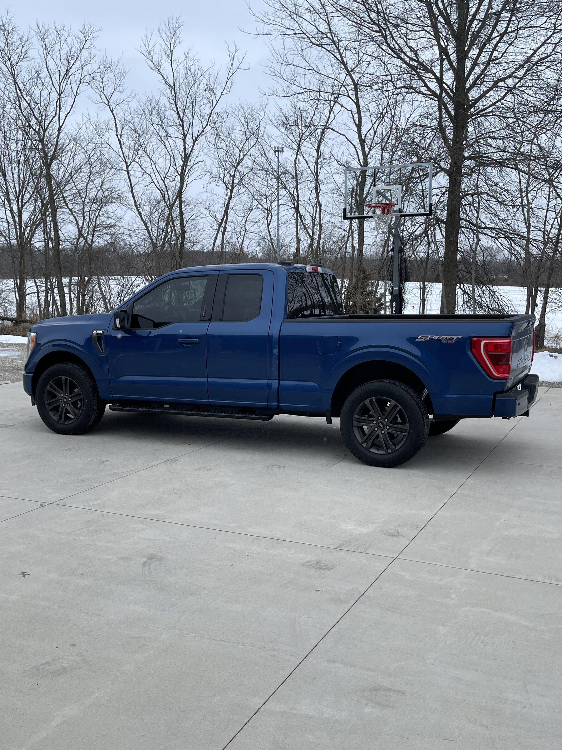

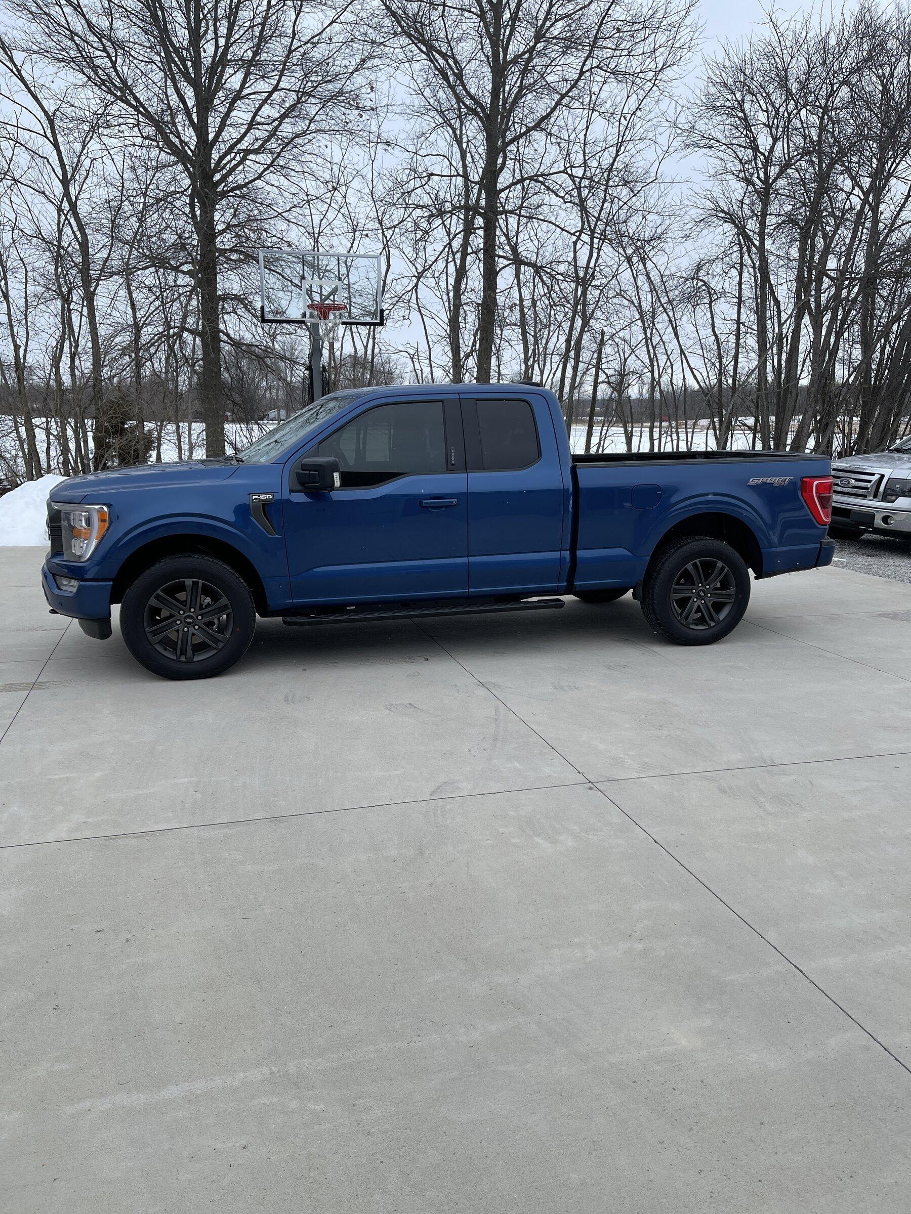

I haven’t had a chance to get pictures yet, we’re in snow town right now! But I did remove the rear blocks also. I had about 3.75” rake on a 2022 SCAB, 4wd, sport model. I think it looks a lot better, truck won’t be towing or even hauling too much so I’m not too concerned about squat later. So I removed them, bought 2wd u-bolts, and at the same time replaced the factory shocks with Bilstein 5100’s. Also torqued down with above specs, thanks @Zyvin !
Here’s a few pictures I snapped this morning. I’m happy with the looks now, still has same rake.

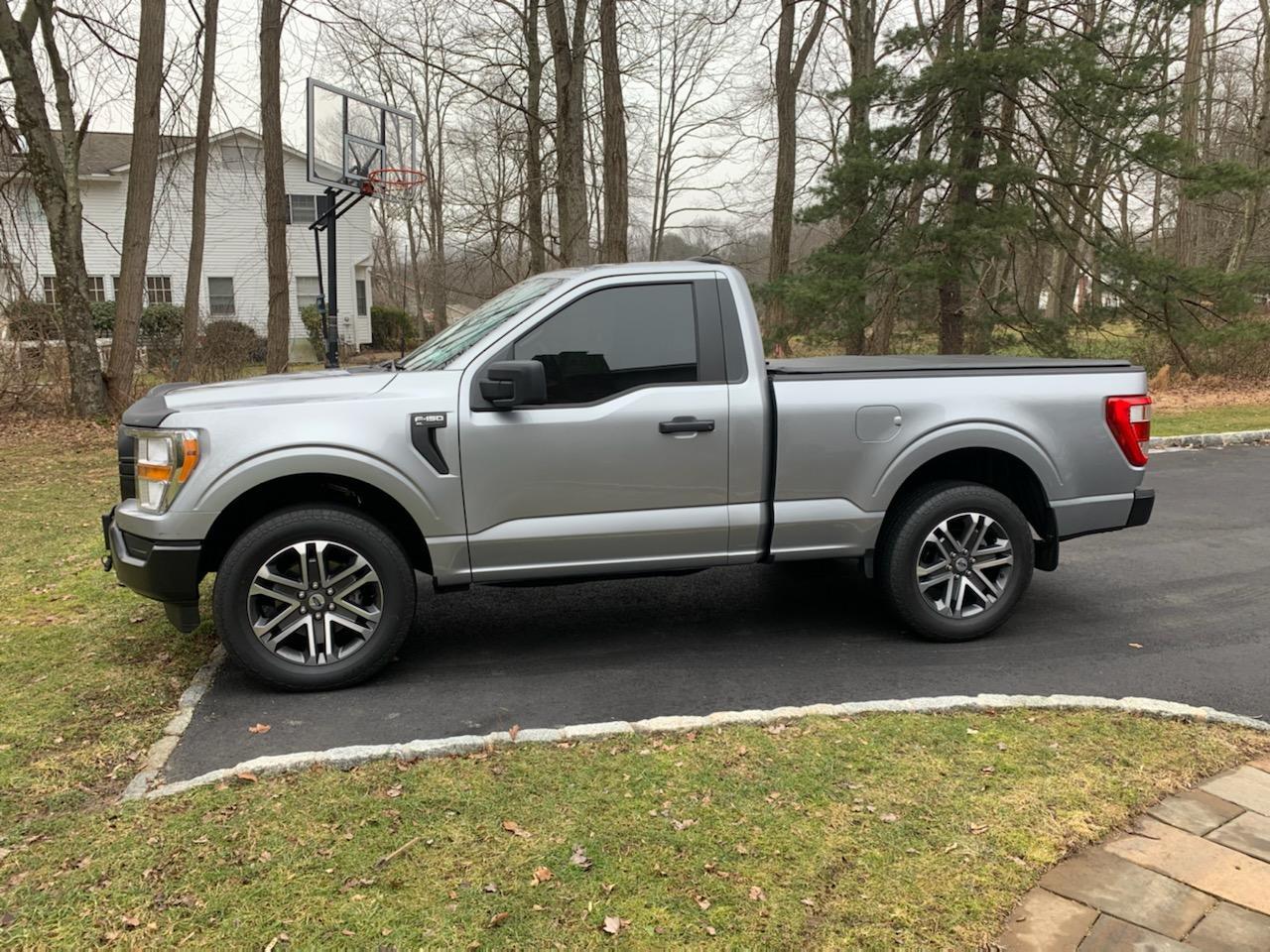

Wondering if anyone has tried removing these on a 2021 yet, and if there's any issues? Does the 2WD not come with these 1" blocks? I was thinking of removing them and adding Fox 2.0, set to 1" to retain 1" of rake and improve handling. My 4x4 Sport w/o FX4 has 3" of rake stock.
