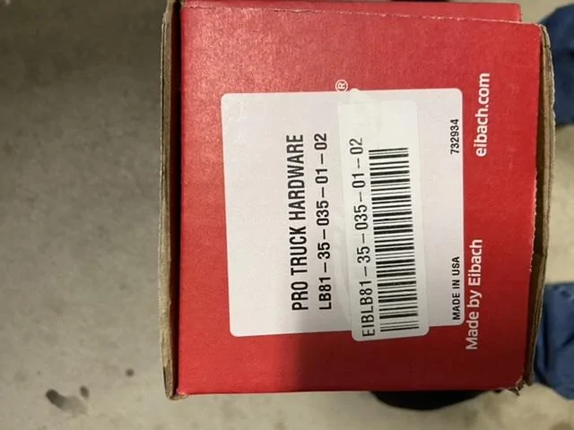

Here ya go
Have you installed these yet? The reviews on the website have people complaining that the provided u bolts were too short to install
No, I went ahead and got the rough country kit instead and am just going to use their rear blocks. I'm out the cost of the Eibach kit. Plus the rough country 2" kit including the font spacers was cheaper.
Yes I installed the RC rear 1" blocks. The Ubolts are correct with the RC kit (rounded top) and incorrect with the Eibach rear kit (Squared off Ubolts). +1 in the rear makes it look much better. Went on super easy.
