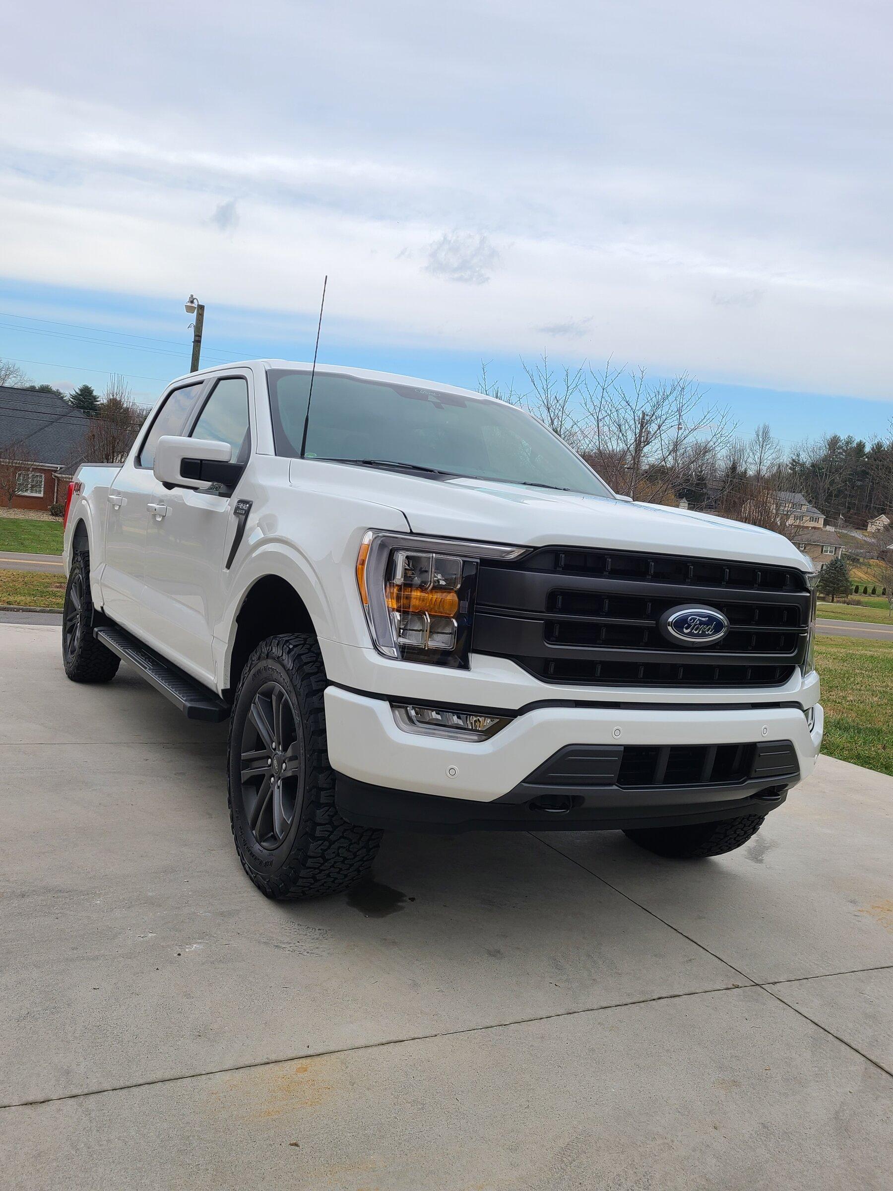

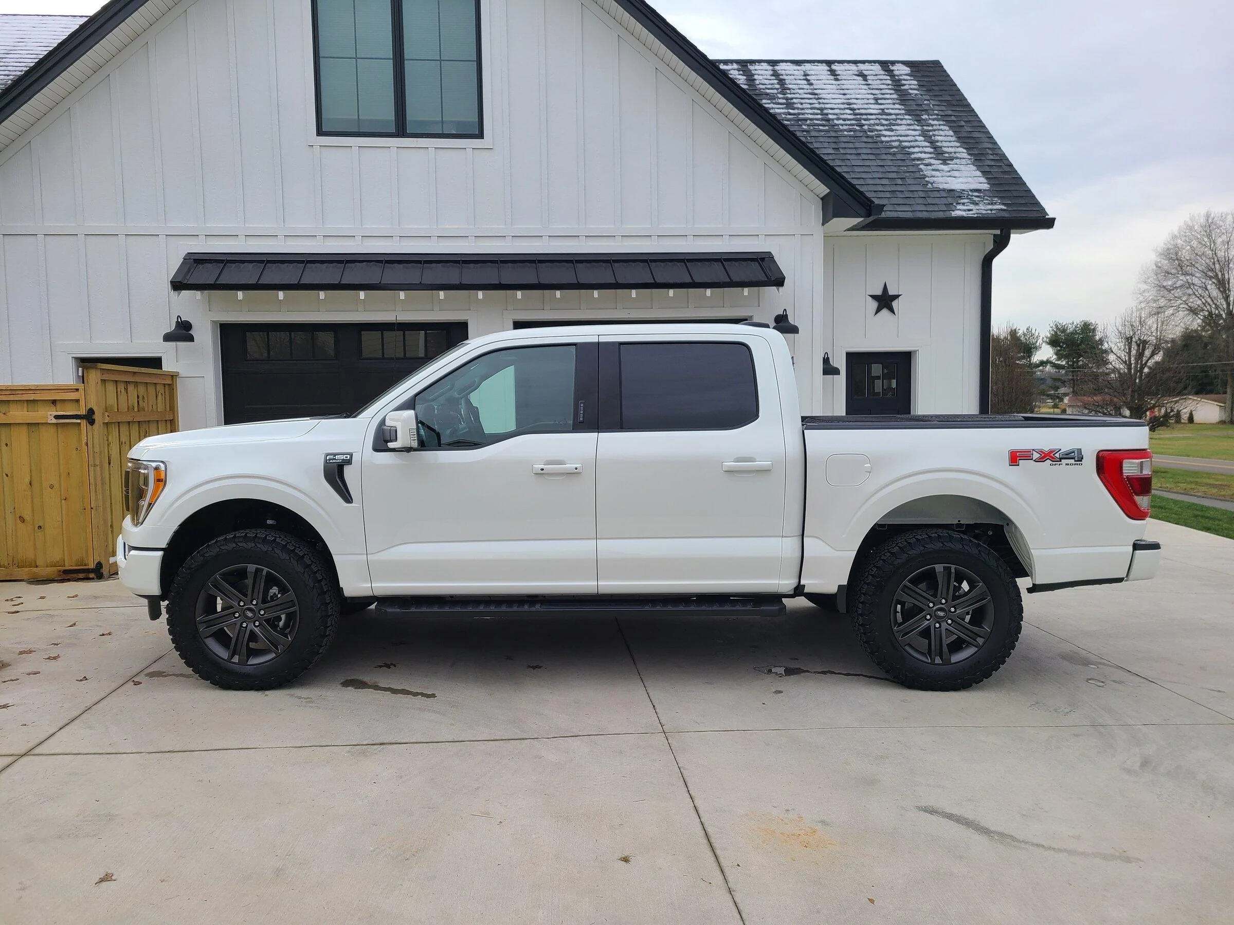

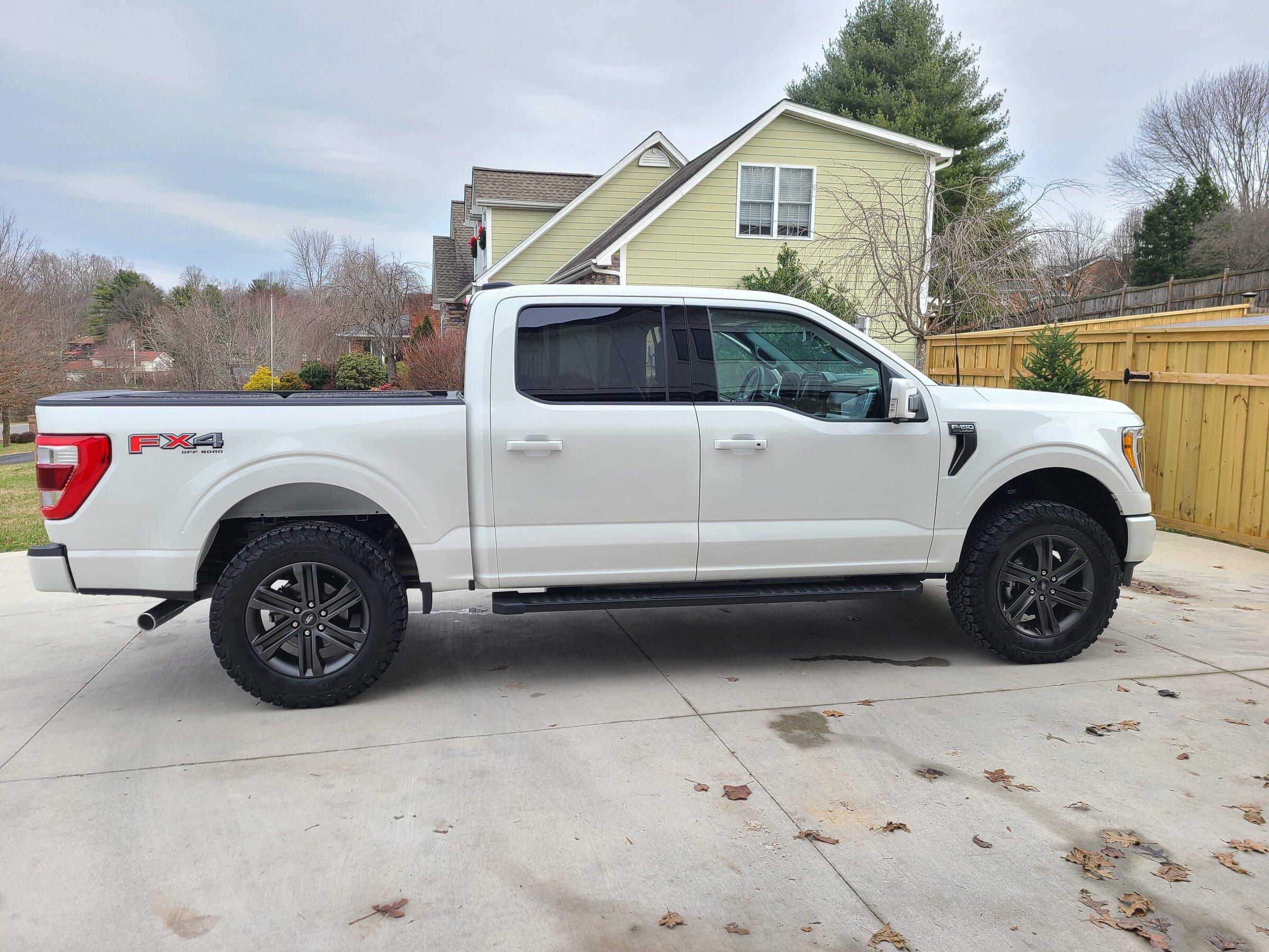

OK 2.5 inch Motofab leveling kit and 285/65/20 BFG K02's
Rear blocks are still in, a little over an inch rake, I'll probably keep it how it is. I love it and glad I went with the 2.5 height, brought the front end way up and the air dam actually looks good now.
Looks great and matches your house. I think the rake looks good, for some reason when this model has less than an inch of rake, they look nose high. Probably some visual trickery with the body lines.
