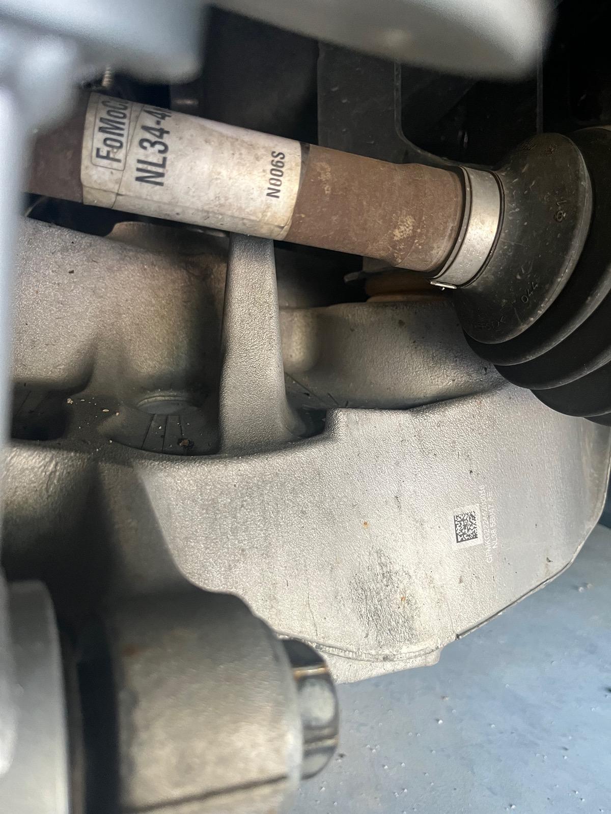

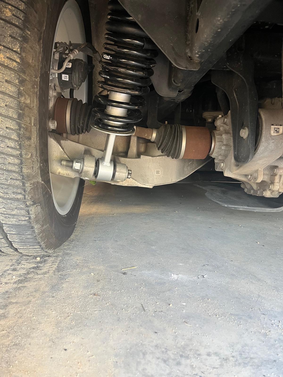

Appreciate the response. I did the beltech struts in conjunction with the eibach springs. Stance looks great but think I have to raise it. Half shafts are on upward angle and ride is rough (it appears I’m on the bump stop…)
Yeah. Definitely are. The struts should never lower more than 1" inch. The suspension just can't handle a deep drop. The Eibach kit is much better. You also risk binding the lower suspension bolt. It's rigid. The Eibach kit has a ball and rod setup
