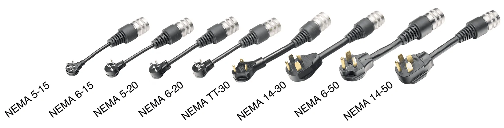

It works on my truck. You need to use a tt-30p to 14-30r adapter that's made for EV charging (parkworld makes one) and an EVSE that can be set to 24 amps or less.

That looks really, really nice! Some of the other, cheaper, Amazon options are missing either the 40a or the 12a options in addition to the 24a.
Biggest hurdle is a 50' extension cord. I'd rather the adapters go first, then the cord, then the EVSE. This could be a winner if they make extensions for their connector. If you go to their European website, they do make extensions!
Also it looks like the $800 price only includes two adapters of the usual flavors. Per the Q+A on the Amazon page, the other adapters aren't even out yet.

The NEC requires that the plug-to-EVSE-brains be very short, because it's the EVSE brains that provide much of the safety (ground fault, etc.) That's why every mobile EVSE has such a short cord between receptacle and unit.

I saw this article yesterday. Haven't tried it but I am impressed with the number of adapters available:
https://www.jplus.world/jplus-booster
https://www.forbes.com/sites/edgars...cing-range-anxiety-reaches-north-america/amp/
Has selectable amperage right on the front of it as well.
I haven't tried it but thought I'd share what I saw. $700 is a bit steep, but it appears to be very well built.
Finally a flexible J1772 EVSE! The Forbes article mentions it includes all the adapters of them, but the Amazon link only shows it with the 5-15 and 14-50 adapters. I couldn't find how much their adapters cost or where to buy them.
The Tesla UMC is $200 (if it ever comes back in stock) and a 40A TeslaTap is $140. Adapters for various plugs are $35-$45 each, or get all 7 for $245. The whole shootin match would set you back $580. That's still a fair bit cheaper than $700 and you get the adapter to plug into a HPWC that's set to 40A or less. If you only need one or two oddball adapters, the gap widens.
