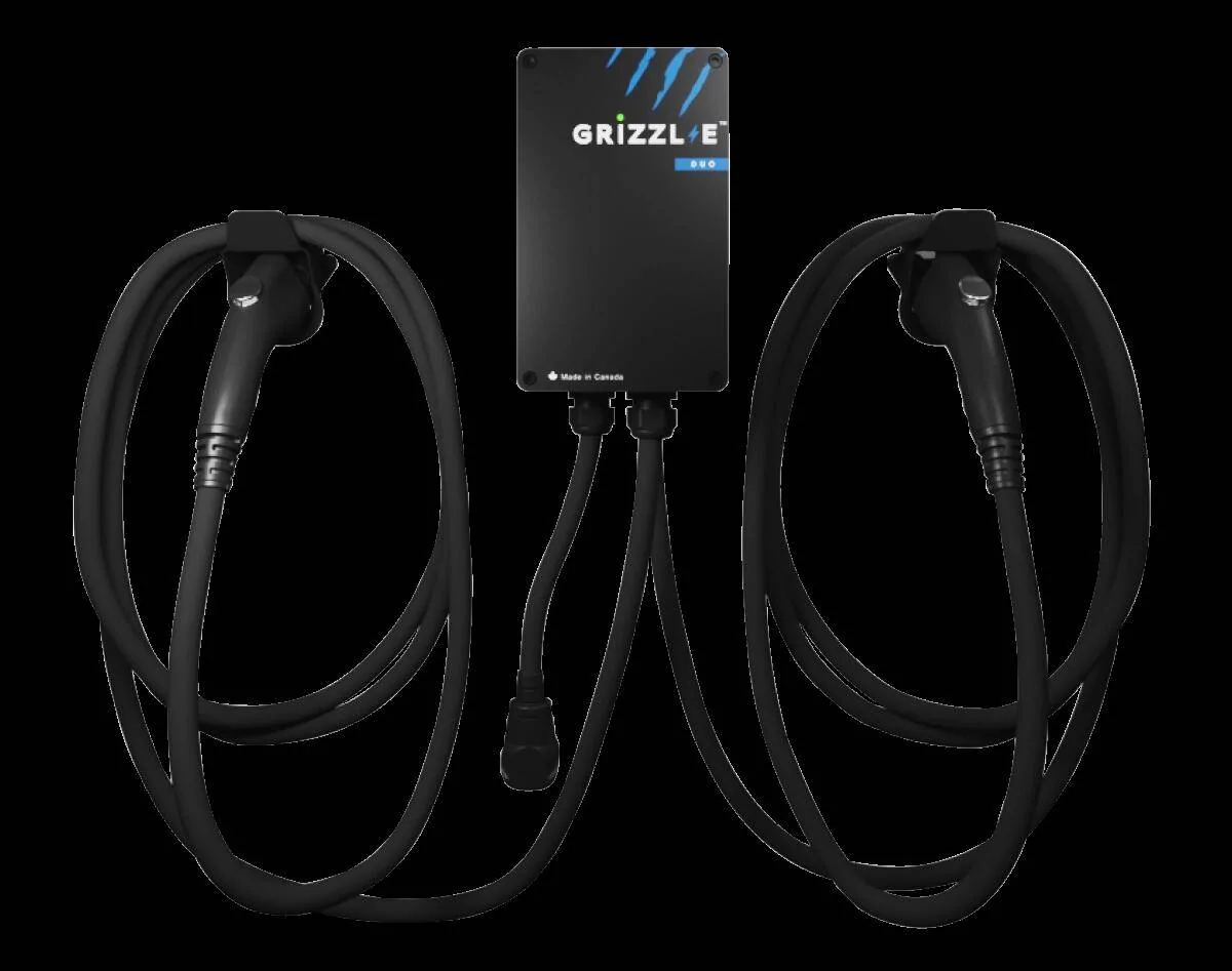

I had the Grizzl-E Duo on a 50 amp ciruit but it didn't work reliably with my Lightning and MME. It errored out most nights and I'd have to go unplug the EVs, flip the breaker on the EVSE and replug them. When it worked, it was good. I worked with United Chargers for a year with two separate DUOs to iron out the bugs but in the end, they couldn't stabilize it and refunded. I wish the Duo would have worked.
Now I use Emporia (set to 32 amps) and a small 16 amp for the MME on a 60amp subpanel. It does the job well enough and I can bump the Emporia up to 48 amps if I don't need to charge both.
