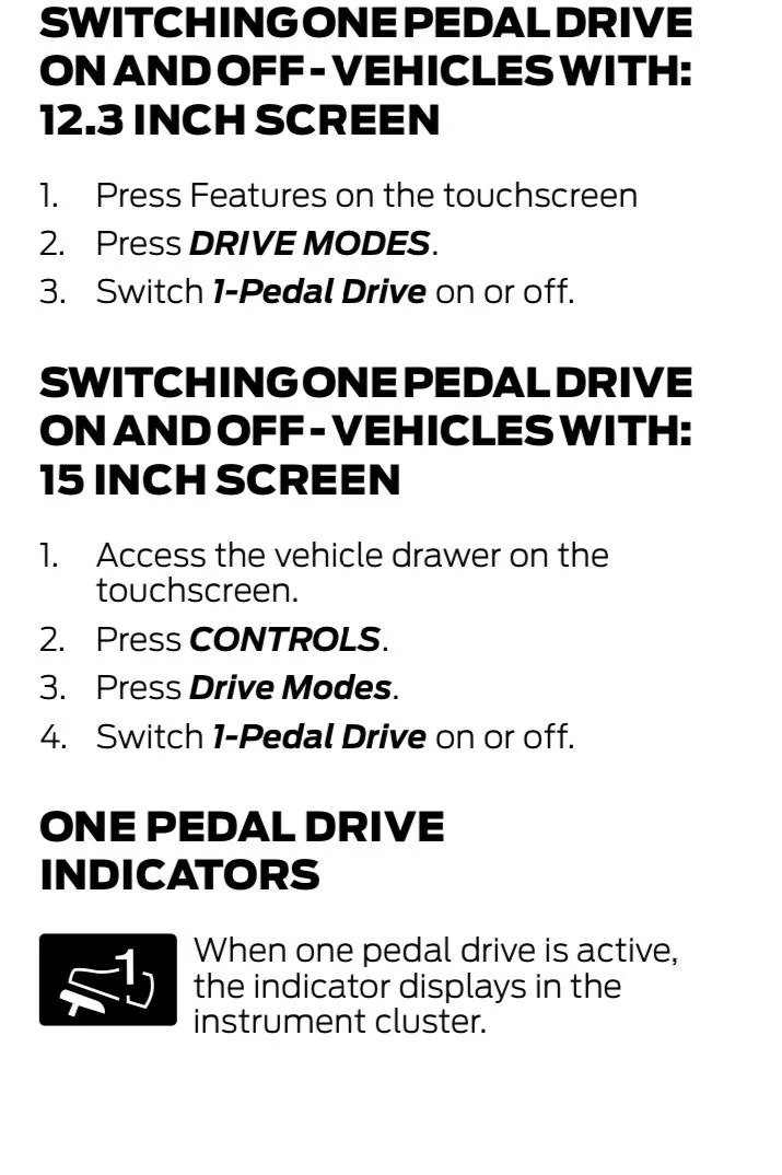

Need help: What does this brake pedal symbol mean? How does it go away? I can't find anything on it in owner's manual. Lower left-hand corner of the dash.

Just found my answer to my question. It's "one Pedal drive" is active. Page 306 of owner's manual

The "BRAKE" illuminates when the truck is on an the parking brake is on. The one pedal symbol is separate from the illuminated parking brake.

There will be a different symbol if auto-hold is on, in conjunction with one-pedal drive.

You are correct - that is the One Pedal drive icon. It can be turned on and off through the menu. Some drive modes turn it off automatically.
@onebadjon
page 296 ‘22 manual
