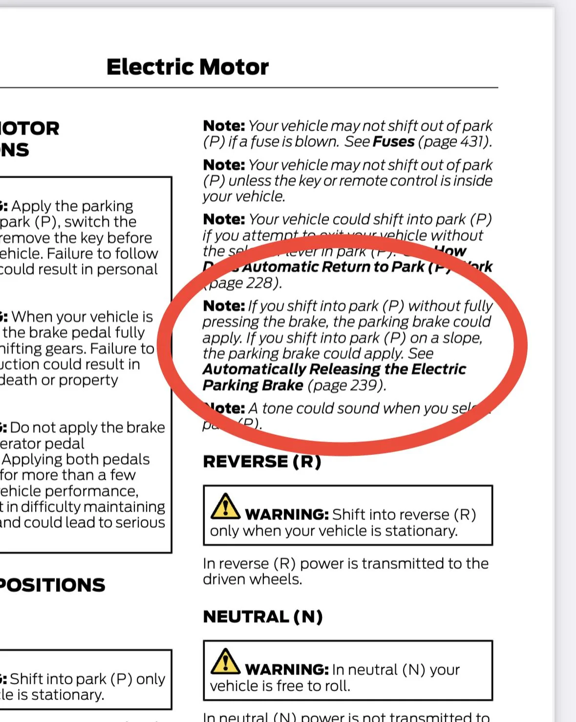

I’ve discovered it only sets automatically for two reasons…
1. Your foot is not on the brake when you shift to park. So if you use 1PD this is easy to accomplish. This sets mine 100% of the times I tested it.
2. The vehicle senses your on a slope when you park.
This is referenced in the manual. See pic.
On a slope is the only one that works for me, accompanied by 500 dashboard notifications.
Would love to have this as a standard feature though.
