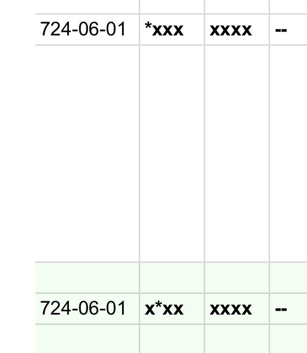

I’m currently looking at doing a heated steering wheel retrofit and came across the below Forscan lines. Has anyone looked at these to potentially solve this issue. They are the heated wheel timer and temp value. If someone has their vin I can look up the asbuilts to see what can be changed.
Ford F-150 Lightning Cabin Departure time heated steering wheel glitch 9A8E5D7F-E383-44C3-ACA1-ACDC2751637F
