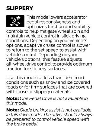

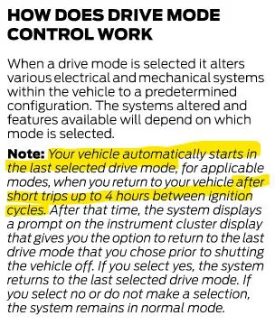

I saw a photo that shows that Slippery Mode has been added to the 2025 Lightnings, so I confirmed by downloading the owners manual. I see too that the previously selected Drive Mode will automatically be enabled for up to 4 hours after ignition off. I'd love to have both of these in my 2024 Flash and I'm wondering if it's possible to enable those items via FORScan. It would be even better if we could change the amount of time that the previous Drive Mode would be active.

You can try. THe 25 runs a new ABS module. I had already looked into this when I saw the slippery mode in 25s.
The modes are activated int he ABS> THe 25 runs a new firmware and runs a new Expedition ABS module versus the F150 ABS
The change that would be made int he ABS module is
760-04-03XXXXXXXX6Xxx
The 25s run a new PCM firmware also. Cant promise this will enable the mode but this is what you would change to try.

I made the change with FORScan. I didn’t get the desired result - Slippery Mode didn’t appear as a choice. Is there anything else I need to do with the change for it to be effective - reset/calibrate, etc.? Or is it just a no-go with the 2024 ABS module? (I updated all modules with FDRS a while back and there are no updates available, so I’m running the latest available 2024 PCM software.)
If it didnt populate then it isnt there.
If the ABS change was made and didnt show then the ABS module is not programmed for it. These are different abs modules that what the 25 Lightnings have.
