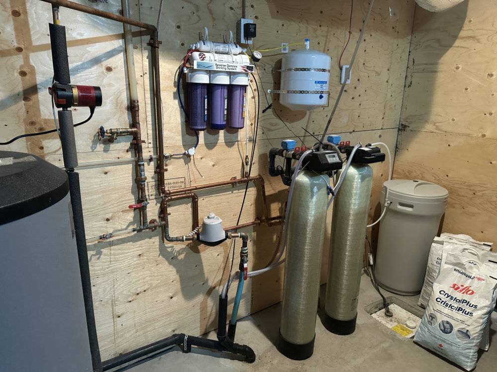

@Altivec great setup! How did you do your soft water setup? I'm considering it to avoid having to spend time drying off the truck after washing.

I built a new house about 5 years ago so I had everything customized the way I wanted it. So the soft water is set up from the perspective of plumbing done at the time of construction rather than a retrofit. I have my plumbing split up into 3 lines. Regular tap water, soft water, and Reverse Osmosis. All the systems are in my furnace room in the basement. RO lines go to separate faucets at the sink locations and fridges, Soft water goes to most of the fixtures, and regular tap water mainly goes to exterior hose bibs. Reason being, the salt used to make soft water is very bad for plants and lawn (unless you use very expensive potassium)
Most softeners are single canister where they can't be used during the time they are changing the ions. This is about a half hour process that happens every few hundred gallons. To avoid being without water, a time is scheduled during the night where it does this. The problem with this, is it must empty its contents and start from scratch even if it's still good. Very wasteful. I got a unique one where it has two tanks that just alternate when they are empty. No waste and no down time.

Awesome! A well thought out setup. Appreciate the great details.
It's far beyond what I'll need, but it does give me some ideas for a retrofit to use RO. Thanks!
