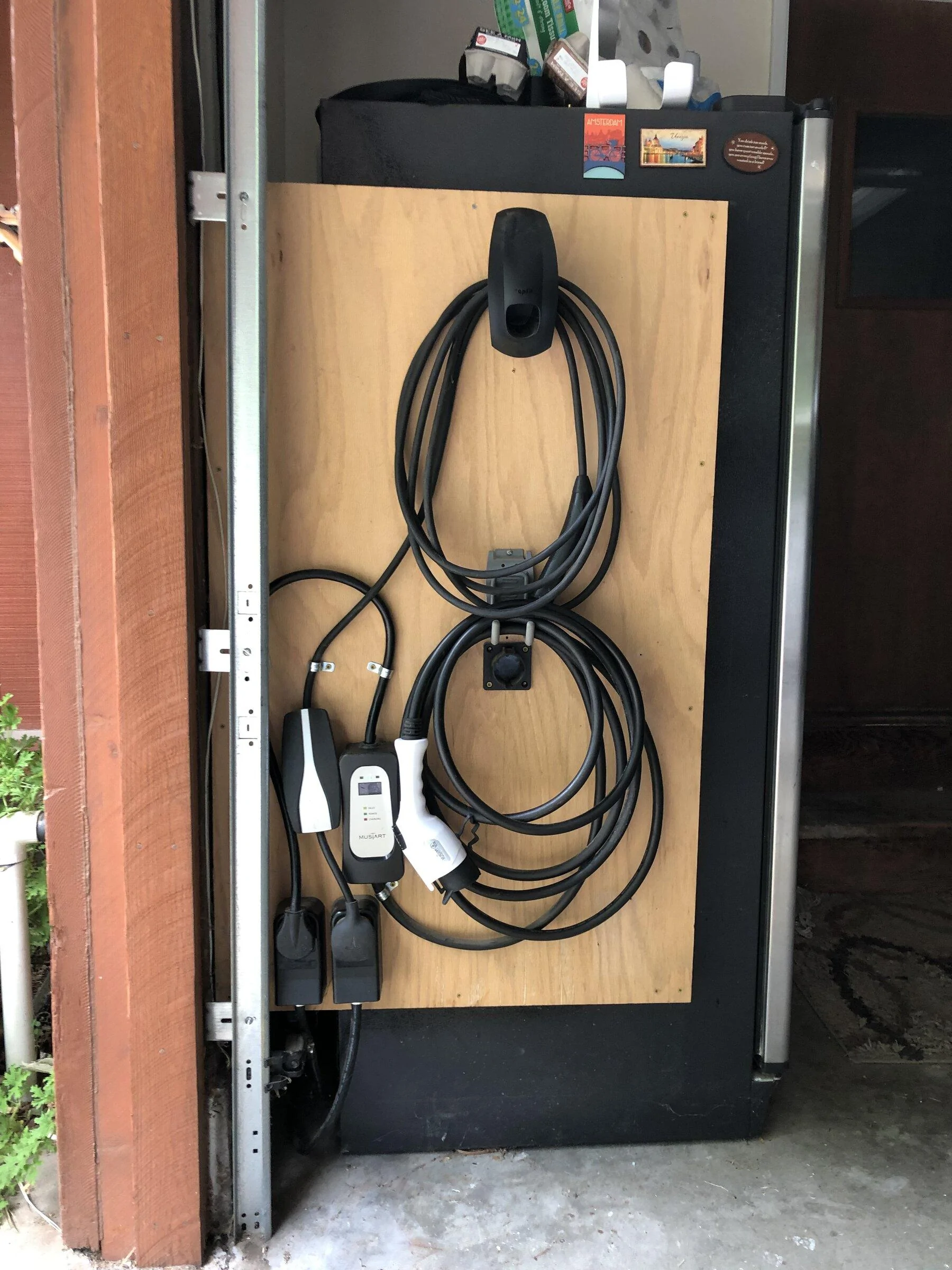

I installed a plywood board next to the garage fridge and mounted a j1772 mobile charger for the BMW and a Tesla one for the model 3. I had spare 240v dryer and RV outlets in the garage (both on their own circuits) so I just ran 10/3 extension cables to the board. Charges each car overnight, haven’t ever needed more than that. We’ll probably sell the BMW after the Lightning gets here (because the range is quite low) so I’ll just use the same setup to charge the truck…don’t think I will need more than that. If the truck doesn’t fit in the garage I’ll just run the charger cord under the garage door.

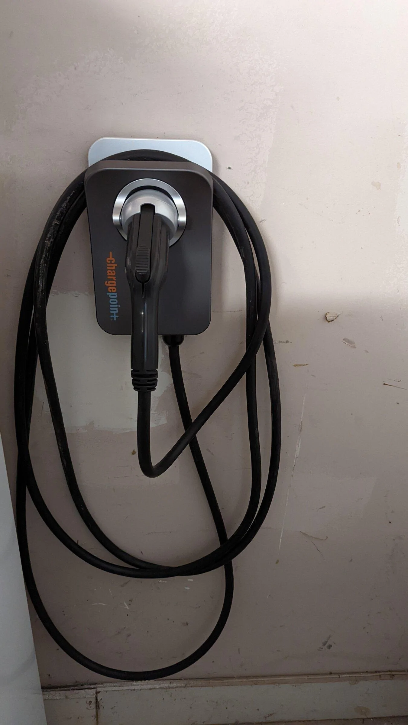

Here’s the ChargePoint plus I installed for my wife’s Tesla last year.. should do the job just fine. Charges at 48amps on a 60amp breaker. I had sunrun come out to see about installing the Ford package but honestly I have solar and 3 tesla power walls so I see no point. I’ll be selling my Ford charger when it arrives.

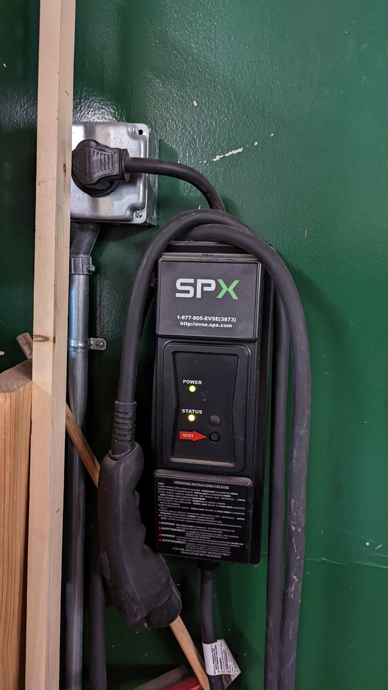

24 amp SPX running off house meter/solar, 48 amp Chargepoint running off separate EV meter

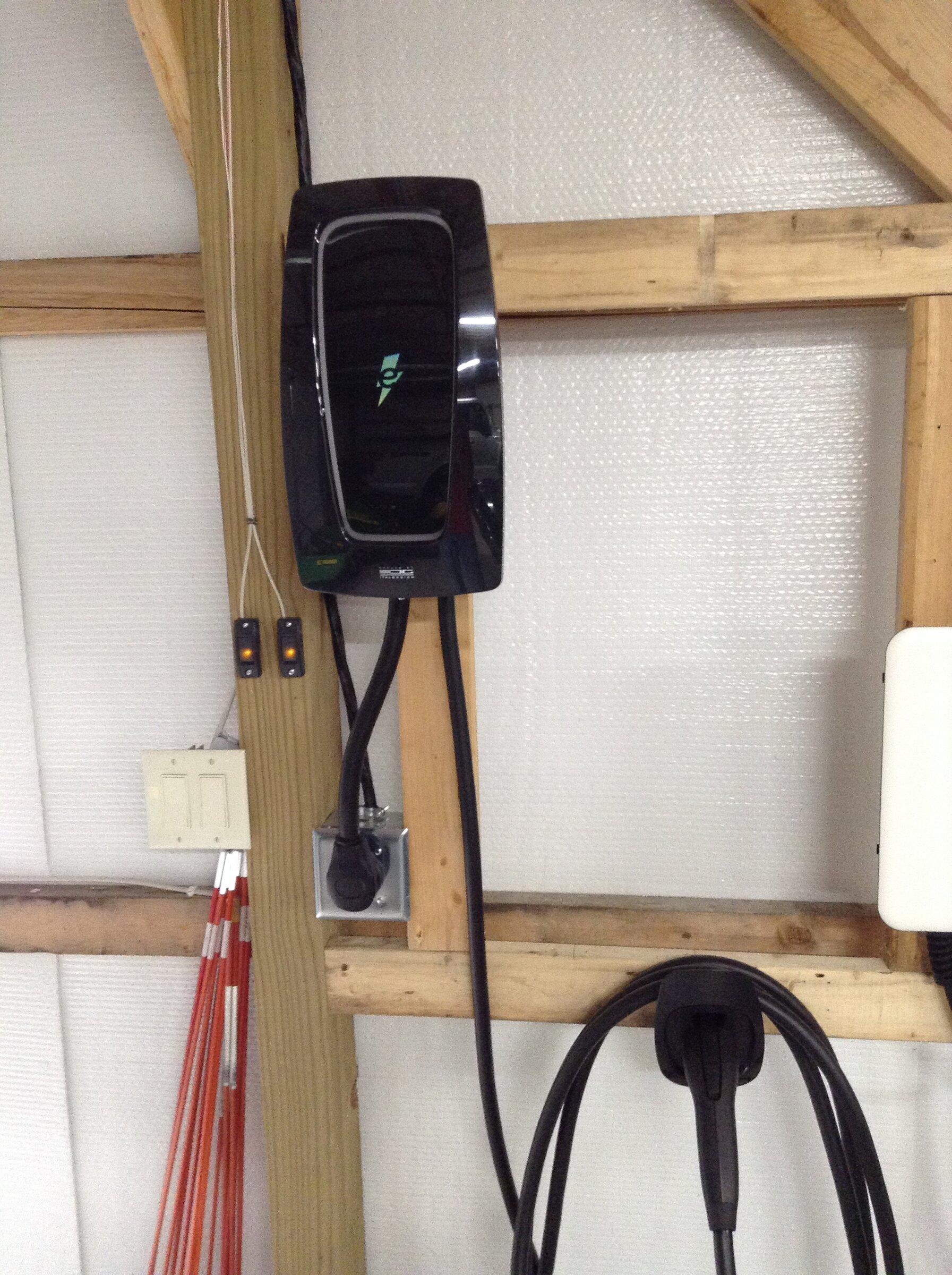

The Ford Pro charger will go in my garage when I can get it from sunrise . My pole barn will hold my lightning this is the charger I have with them . is a electrify America home.
