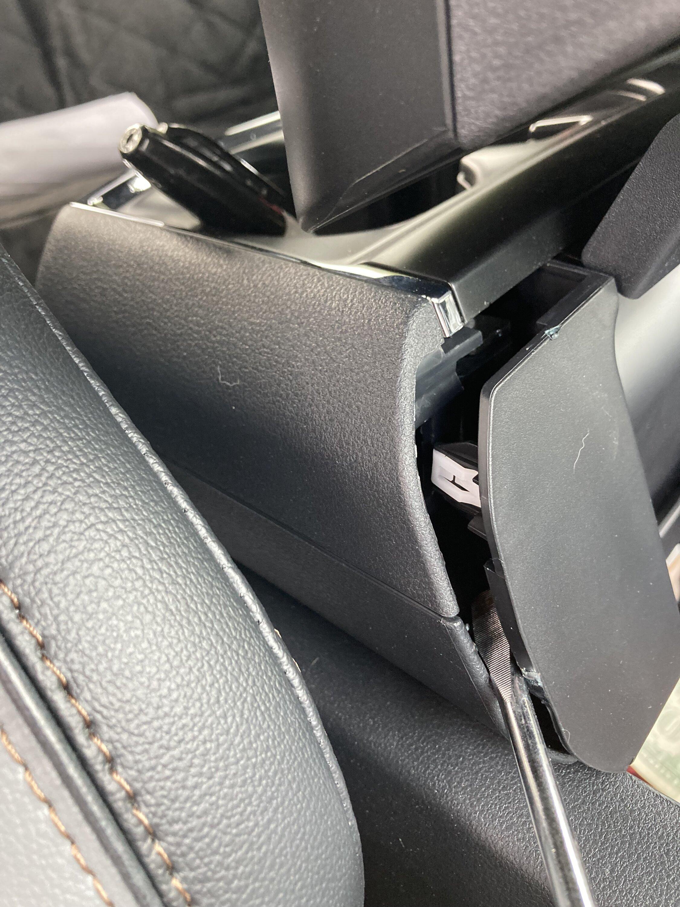

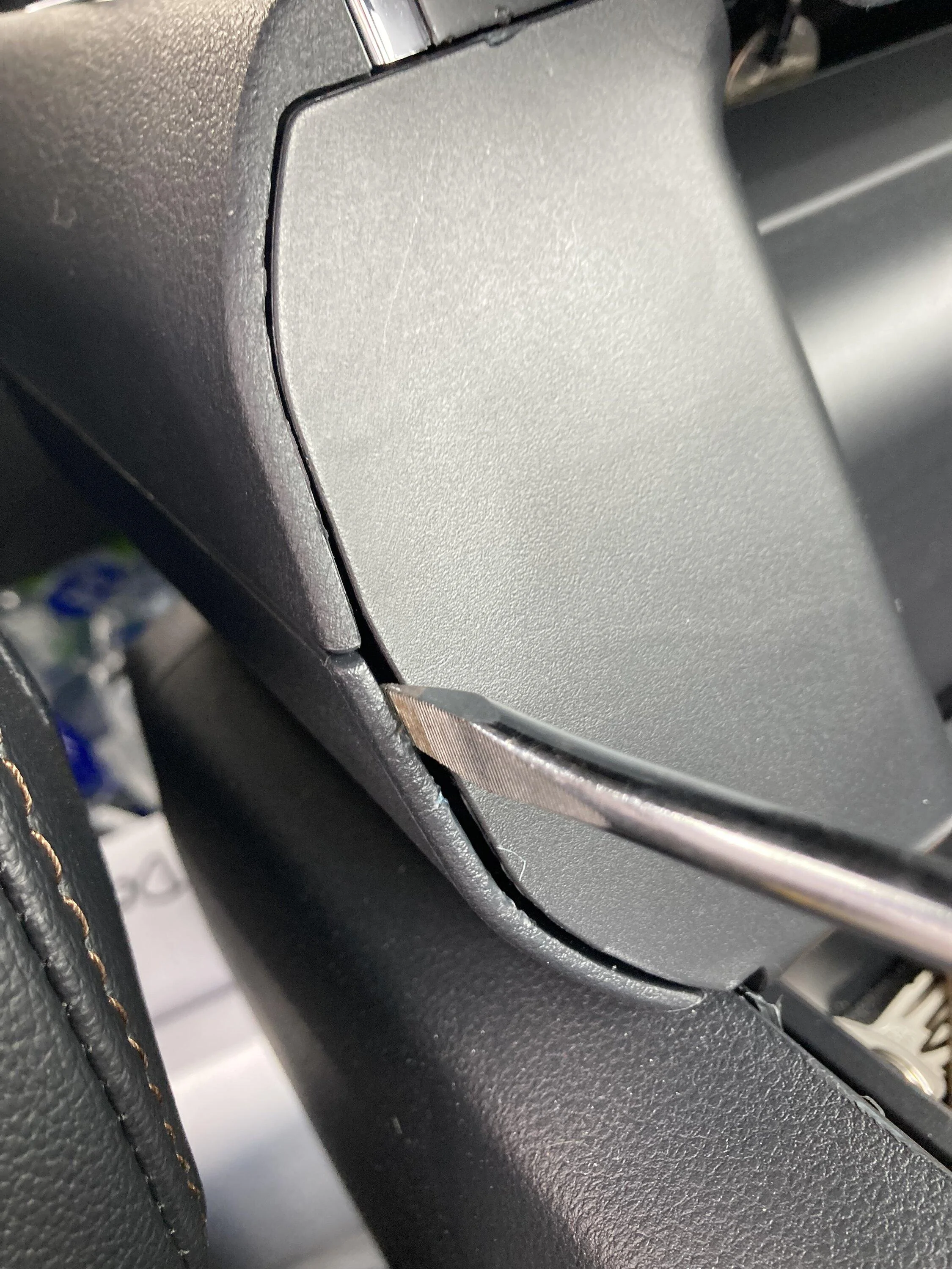

Man I love the internet. Got the panel off in 10 seconds prying the edges with a flat head screwdriver. Used vice grips. I’m in and out of that console all day for work and it was making me f’ing crazy. THANKS.

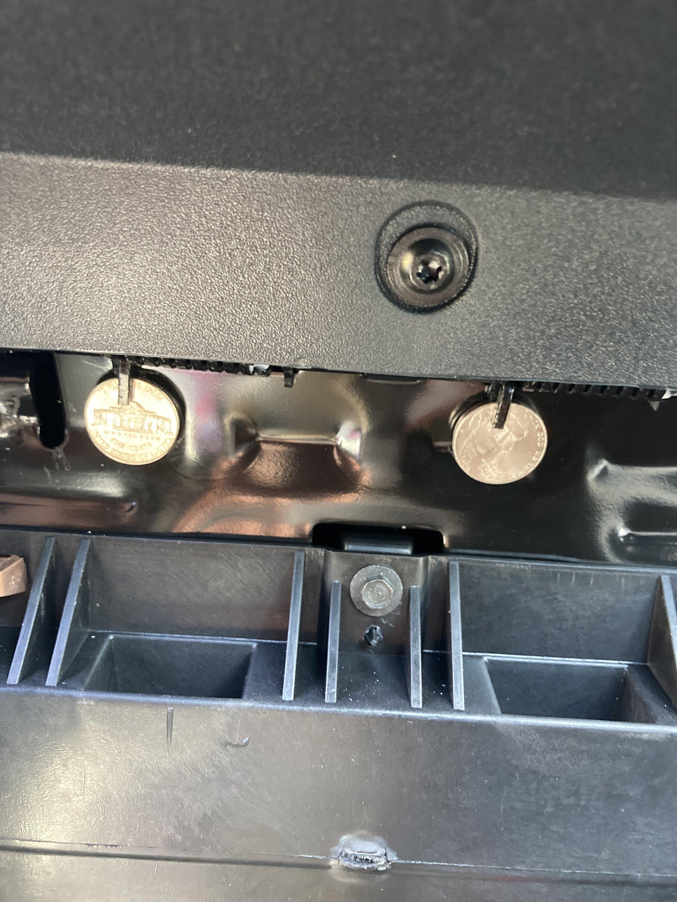

1. Open the center console.
2. Working carefully using a trim removal tool, remove the trim panel located right below the hinge on the inside of the compartment. (Optional, but I recommend it for better access)
3. Now with better direct access to the hinge, locate the exposed ends of the springs.
4. Using your hooked metal plastic retainer removal too, gently lift up one of the spring ends and slip two nickels under it. Hold the nickels in place while slowly releasing the spring until the spring pressure is firmly holding them in place. Repeat for the other spring.
5. Replace the plastic trim you removed previously (if you did)
6. Enjoy a center console that finally isn't plagued with impotent spring tension ;)
please tell me how to pry it out with a flat head screw driver without breaking plastic

Thank you will try it

finally had some nice weather to get this console fix done. works much better than before but frankly still not what I was hoping for. it will still fall down but gentler than before.
Try 3 nickles under each :ROFLMAO:
Or just something a bit thicker. I have seat covers that also have a cover over this lid. I used a quarter and a nickle cause I didn't have 4 nickles. With weight of the cover on, it's perfect, with the cover off, it's a bit too much spring. So maybe even just an extra dime's worth of thickness is what you need.

Am I the only one having difficulty trying to move the spring enough to allow insertion of the coin? I’ve tried every tip suggested, but just can’t seem to get it dislodged
I certainly did at first, but the needle nose vice grips method did the trick. The tips grabbed on and clamped just enough to allow a second person sitting in the other seat to slide in two coins on each side. I was was parked on a slope pointed down which didnt help at all at first, but now it works great. Three coins each side was too much and made it hard to close, two is good.
