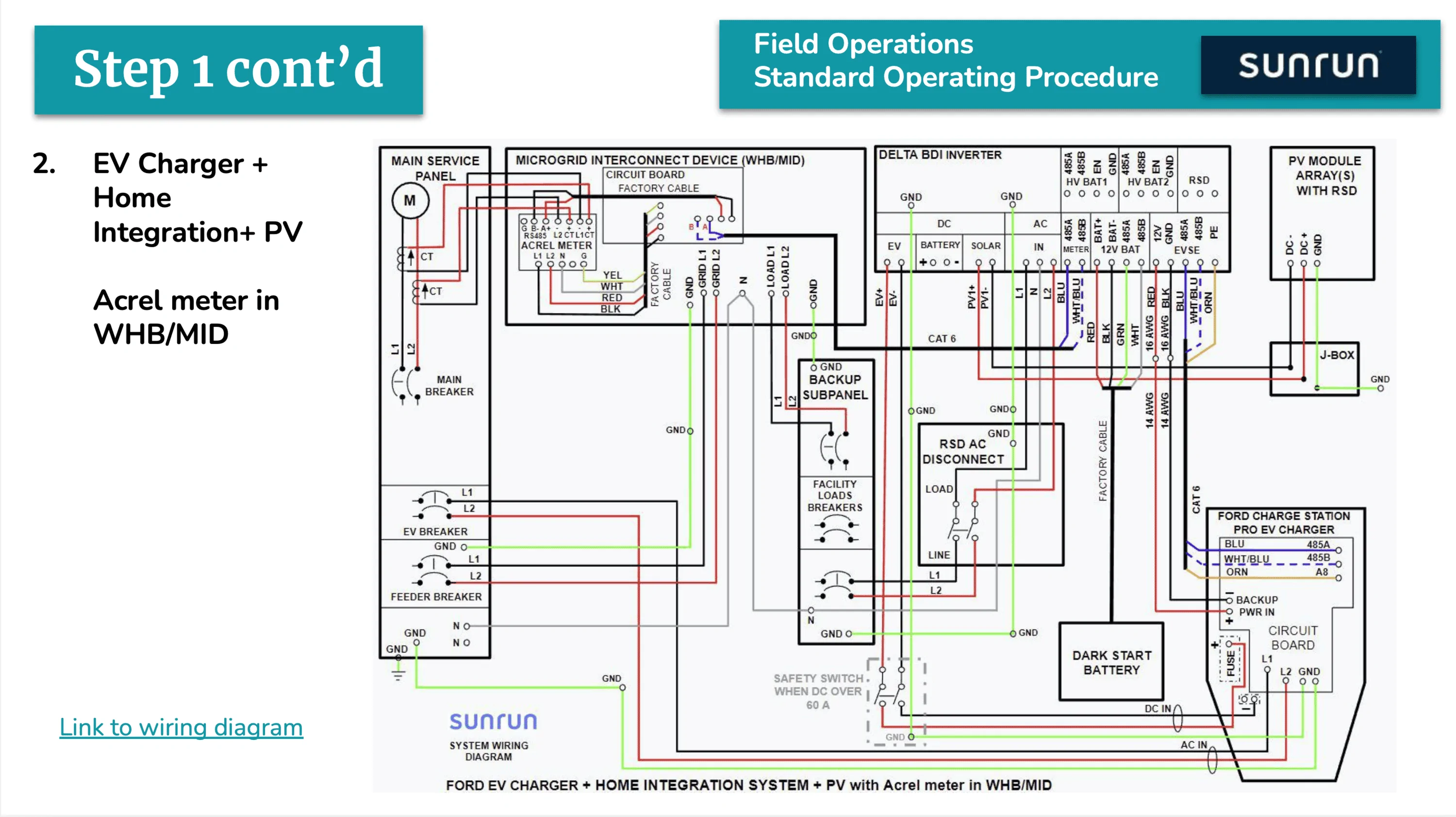

Hi, a few comments -
1) I think the issue is that the Ford charger has to be fed from grid and if it loses power so does the charger. So you can't have it hooked into the panel that you backup with the HIS. Sunrun doesn't do whole home backup due to the 9600watt (40Ax240) capability. You would choose the critical circuits to be powered. A long as your sub panel goes to the main panel that is disconnected when power is down I think that is fine. The HIS would feed a critical loads sub panel.
2) I believe there are few extra wires for communication and backup power from the inverter. See schematic below - There is one cat 6 cable (I presume they want it shielded so reason not just cat 5) that goes from FCSP to BDI inverter. There is also 2 DC 14AWG wires for backup power to the FCSP. The DC 8AWG wires you mention are the 400V from the Lightning battery that are fed though the FCSP.
Ford F-150 Lightning Charge Station Pro and Home Integration System self-install 1664418511149
3) There is probably no issue doing what you say but the backup panel connected from the HIS would be separate system than the Enphase solar system. Right now the HIS and Enphase do not communicate. There is some firmware enhancements that Enphase is working on to somehow integrated the two but no details yet. Something I learned recently is that the Enphase System Controller 2 has a 16Kw limit for PV which has been a problem for me since my system being designed is 24kW. I've been going back and forth with enphase on this and no solution yet.

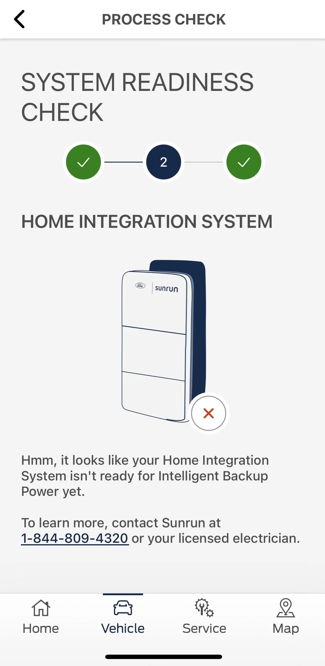

Well, I got this far.
@Wombat, We are at this step as well. Is there an activation needed from Ford/SunRun/Delta? Did you ever get through this step?

Hi, we've posted many documents on this thread earlier but there may be a few new documents on the link below which might be helpful in additional help setup section. The page is meant for installers so maybe what you need is in there.
https://sites.google.com/sunrun.com/sop/sops/ev-chargers/ford-ev-charger
Yeah, here’s the issue. Electrician has followed this and things just are not exactly working. I can get the truck to charge. I can add the station to my account. I can even add the HIS to the truck as an enabled Intelligent backup. The issue comes with the Fordpass app and trying to enable the intelligent backup there. Anyone get through that step?
Wombat
Jul 12, 2022
Lodi, CA
F150 lightning
It’s still on the back burner, I suspect Sun run or the power company needs to activate something.
