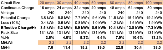

There is basically a flat charging curve for AC charging until the very end. I will post mine shortly. I charge to 90%. It's flat.
Ford doesn't make the charger.
Not charging to 100% except for trips is basically an industry standard.
Your math is not right. 48 x 240 = 11.52, less 10% loss is 10.37. Open the Ford app while charging and you will see 10, because it lops off the decimal place. You won't see 12 or even 11.
Ford F-150 Lightning Charging Lightning ER on 50A Circuit with L2 Charger charging curve.PNG
Hi, Rick. I see your point on amps x volts. But my calculation is not based on theoretical amps delivered by the charger. It's just based on energy actually taken up by the battery, according to Ford's software system, as relayed to me by the FordPass app.
So, a small part of the apparent discrepancy that you point out is that the figure in the FordPass app is only accurate to TWO significant figures and might be rounded up. The percentage charge increase might have been 30.51% and rounded up to the 31% number I used. Or even worse, maybe Ford's rounding scheme is anything above 30% gets rounded to 31%! IDK. ?
The other unknown is when I'm on an 80-amp hardware setting but a 48-amp software limit, do I really only get exactly 48 amps all the way up the charging curve as the resistance is changing, etc? And is the 10% loss figure constant all the way up the charging curve, or is that an average figure covering the whole range, and do you actually do better in lower parts of the range with less charging loss when the input resistance is lower and the applied voltage is lower? Maybe I benefited from that by not going up the last 10% of the range to 90% SOC. (and I'm charging a vehicle whose battery is cool to start over a much smaller range than 15% to 90% (only 49% to 80%).
Using 31% charge added as a good figure, my actual calculation, carrying unwarranted significant figures, was 11.78 kWh added per hour. If I assume that I really only hit a 30% charge increase in 3 hr 27 min, the kWh/hr figure becomes 11.40 kWh/hr. So, either the amps delivered and/or the charging rate loss are off if I can make it from 49% to 80% SOC in 3hr 27 min...
