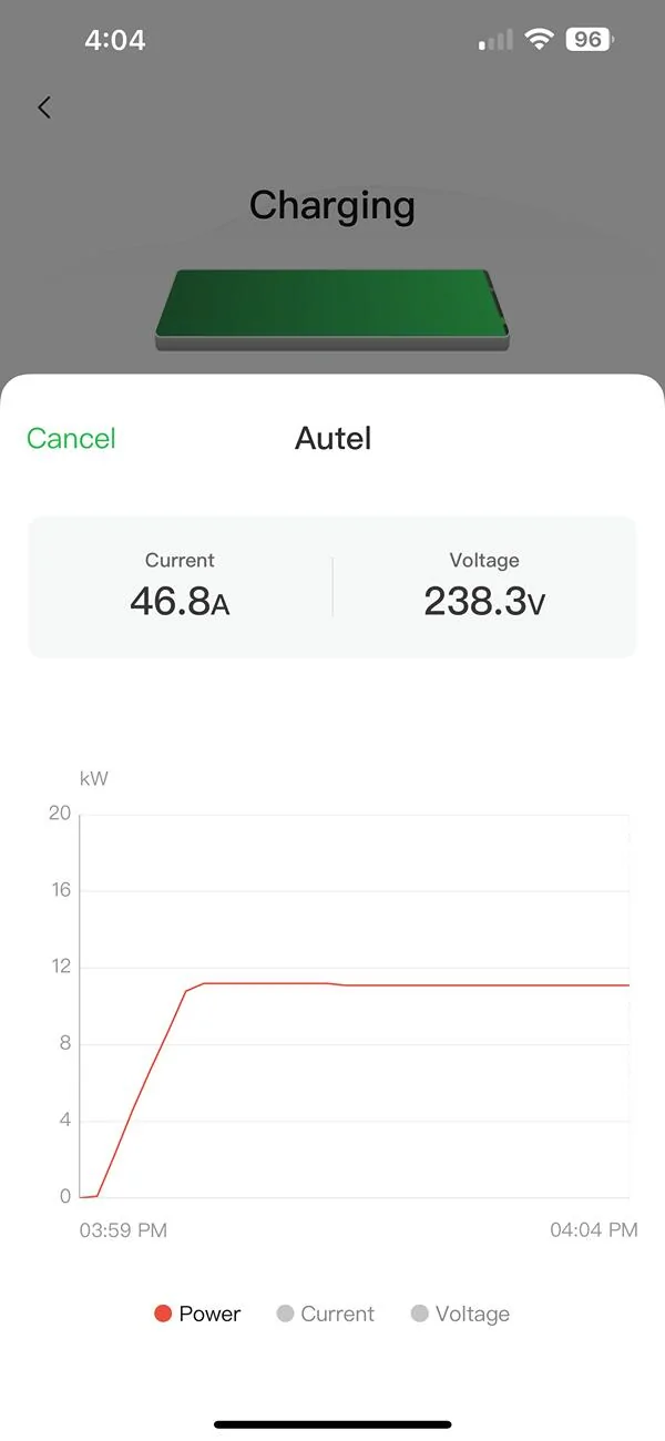

What does the charging curve in the app look like? Has it ever gone over 3.7kW? That will show you the voltage and current measured in the Autel unit.

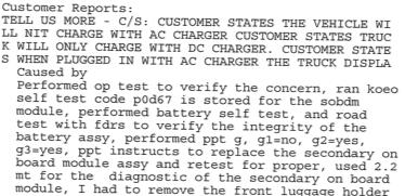

When I first tried to charge the truck on a level 2 charger, the truck faulted and the wrench icon appeared on the dash. When I tried it again, it faulted again, but no wrench. When I called the dealer, while on the phone with the service advisor, he was able to remotely see the codes the truck was throwing. From there, we scheduled the service with a hunch that the truck was having an issue with the AC charging, especially since I was able to use DCFC to charge. If it would help to show what the technician did to diagnose, let me know and I'll be happy to post it here.

I was also charging right around 3 kW before the truck was fixed. Here's the info from the the paperwork the dealer gave me after the service was complete. It mentions code P0D67, which may help your dealer if they hook it up to an OBD2 module. I hope this helps them get to the bottom of your issue.
