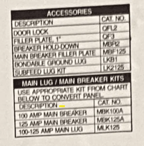

If this is your only electric panel for the house, and all you have is a main disconnect breaker in the meter box, you need a licensed electrician look over your panel and ignore sunrun.
You appear to have 2 spares that may allow a 240v breaker for your charger, but you need to have this panel & it's incoming wire inspected for capacity. This may be a 100 amp panel, or smaller, and you many not have wire and/or panel capacity for the 50 amp breaker needed for a 40 amp charger.

Looks like your due for a service upgrade just to acquire a panel with more space!!
Your main disconnect is up stream of this panel, possibly next to the electric meter.
Looks like it's not more than a 125

If the main breaker is not in this panel, Sunrun (or an actual competent and attentive electrical designer) should at least consider connecting the charger closer to the main. This most likely isn't the right panel to cram your charger circuit into.

Many of us have the same issue. My house has a 200 amp main feed from the street. But my detached garage where I do all my charging has only a 50 amp sub-panel.
@Jmurraytravel has two choices: Either they can install the Ford Charge Station Pro on their existing 50 amp circuit and derate it to 40 amps maximum. That's obviously the least expensive option.
Or they can upgrade the service to their garage sub-panel to 100 amps and install the Charge Station Pro at its full 80 amp charge capacity.
The latter choice may require significant and costly upgrades to the garage service. I have an electrician coming out to determine what I'd need to do if I want to install my Charge Station Pro at full capacity.
