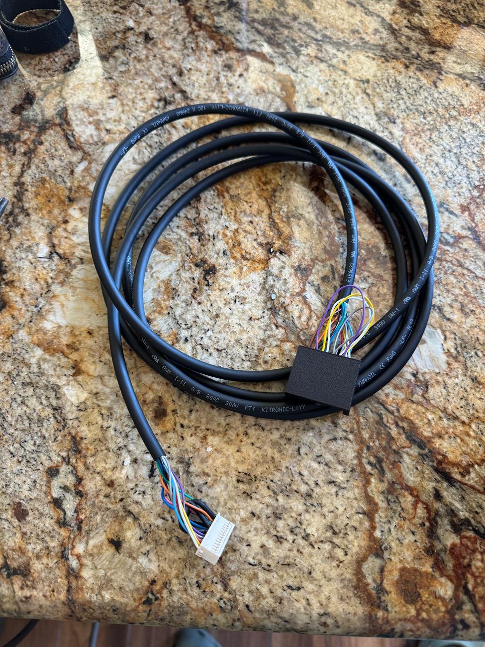

@Ajzride you are amazing! Do you plan on having an updated video or pin out diagram? I can send you the connectors I bought as I will no longer need them if you have any use for them.
I don't think a new video is necessary. It's the exact same process, except there are no more passthrough wires in the harness, so you don't have to loop back those extra 4 wires on the backside of the extension harness (comma basically copied that concept when they made the new harness and now those 4 wires just go straight from the grey connector to the black one).
