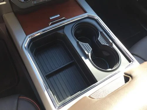

If I had to point to the time Ford interior engineering was at its peak, was when my prior Super Duty that had the column shifter, then this nice storage area (where the folding shifter now is) and a sliding cup trim that allowed the storage area to convert into quad cup holders if needed.
It was simply marvelous and would work great in newer trucks with the work surface! I still don’t know why Ford went to a motorized shifter that takes up usable space, is more complicated/expensive and is one more motorized gadget that can break.

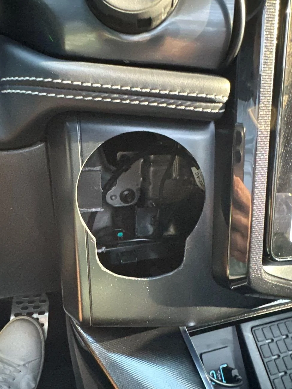

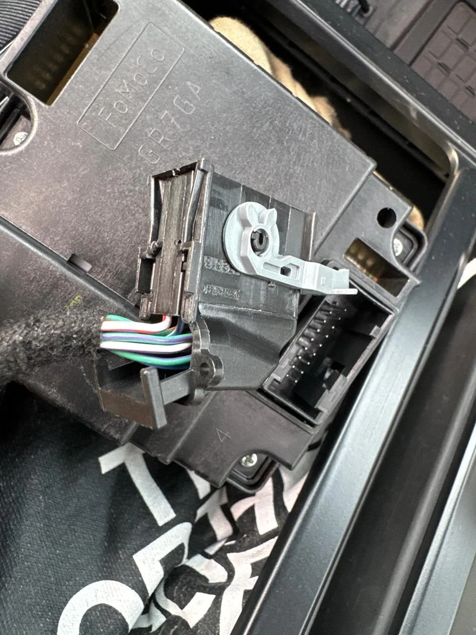

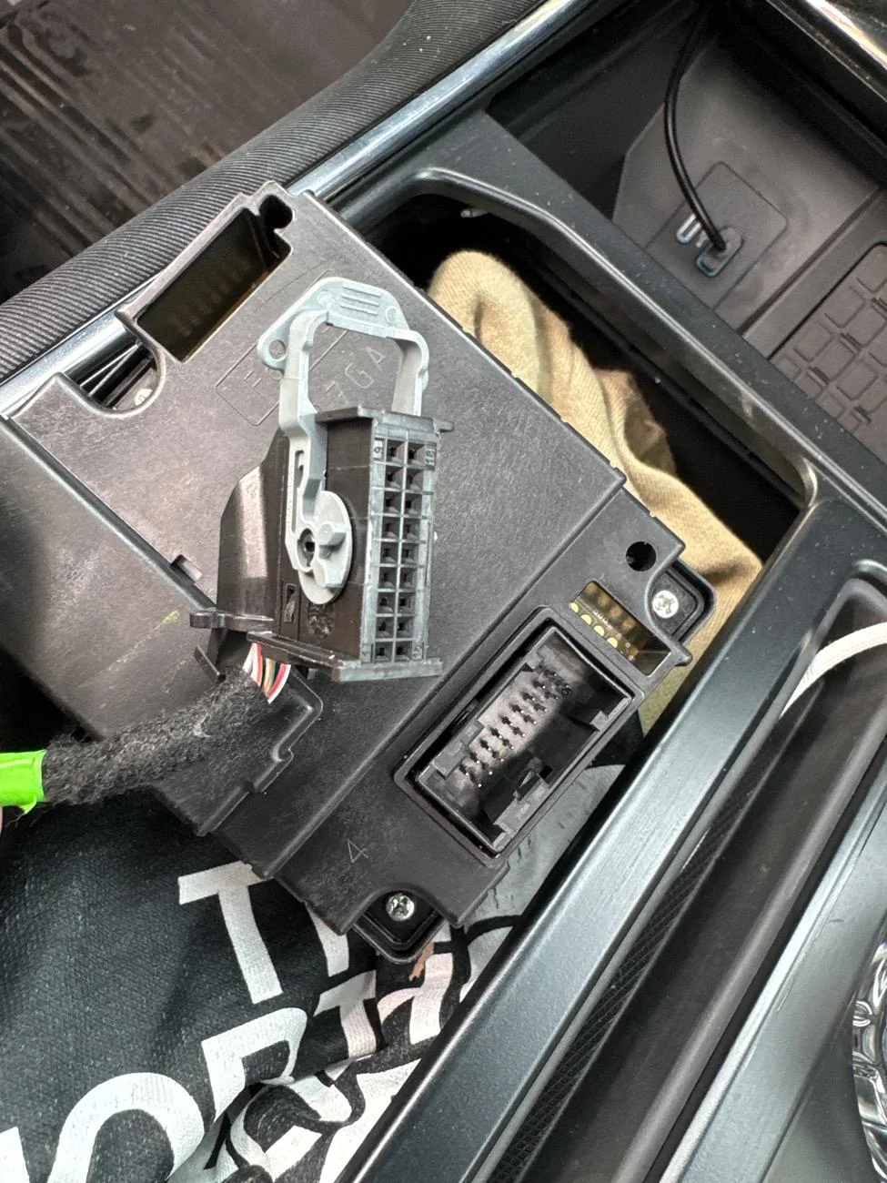

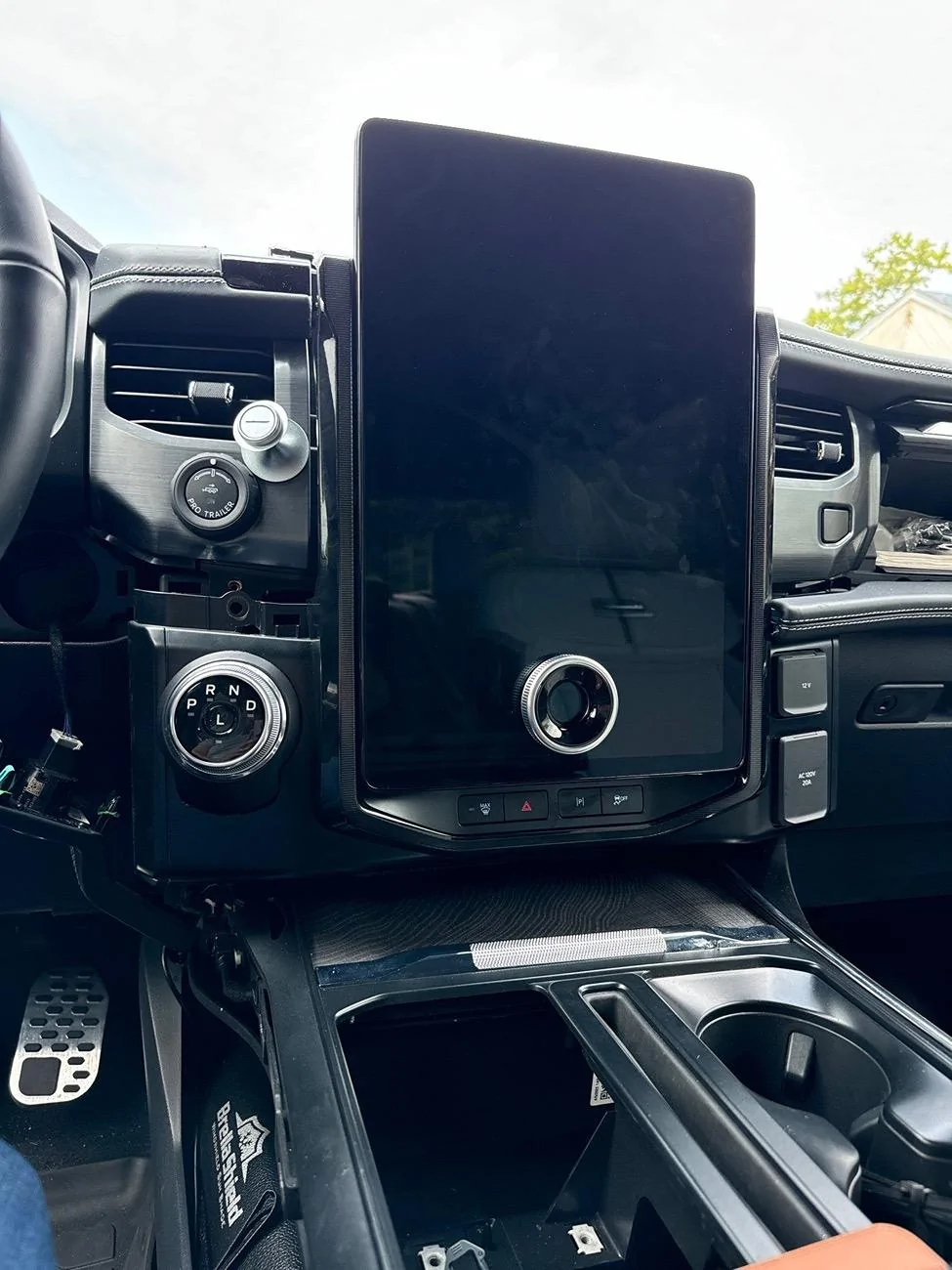

Quick update on this. The dial from the Ford Escape is plug and play. The L button acts as the 30 min neutral button. I was able to make the shifter fit where the trailer brake controller is. The dial housing is larger than I had anticipated. I don’t ever tow anything so I just threw the trailer brake behind since there’s plenty of space back there. The only problem now is the wire doesn’t reach. I’m working on getting an extension cable from the company that makes the column to console swap kit. They don’t seem to want to sell one without selling the entire $500 kit. If anyone has any info on how I could get that harness or even make my own please let me know because I definitely don’t want to cut and splice the factory harness.

WOW, I admire your courage.
:like:
Trust me it wasn’t easy to make that first hole in the trim haha. I called ford first and found the part number. $250 if I totally butchered it but ended up being ok
