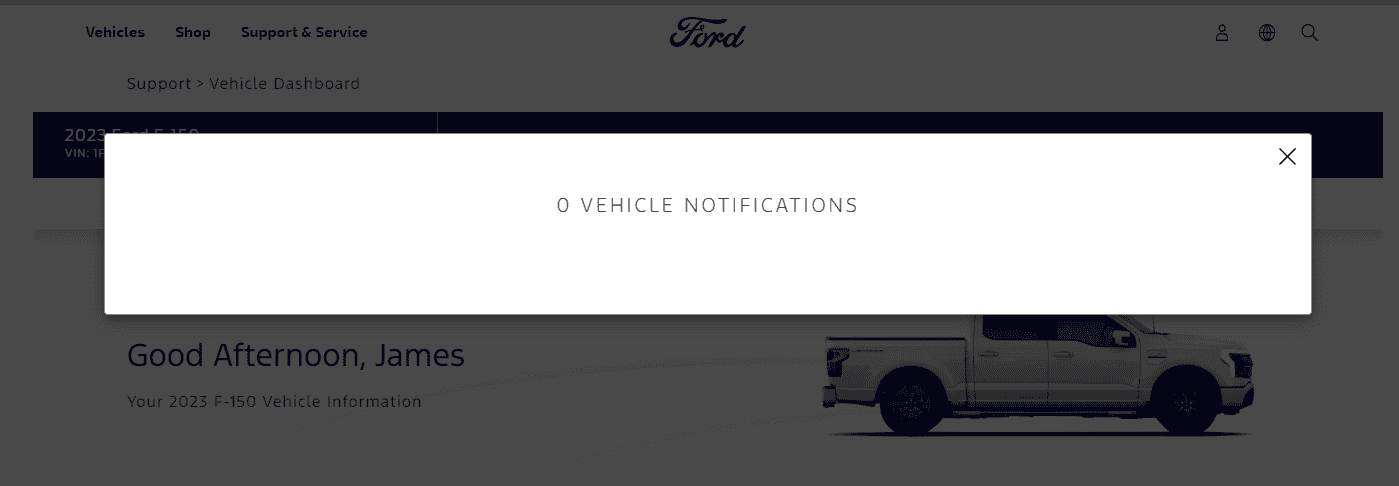

My dealer service was on 1/11/23 and the NHSTA Sync recall and both CSPs, the BSM and the BECM one, have now been cleared from my Ford account, even though the BSM is on order and hasn't been installed yet (the hardcopy service order was also written up as if it were installed but an e-mail afterwards from the SA confirmed it has not been).

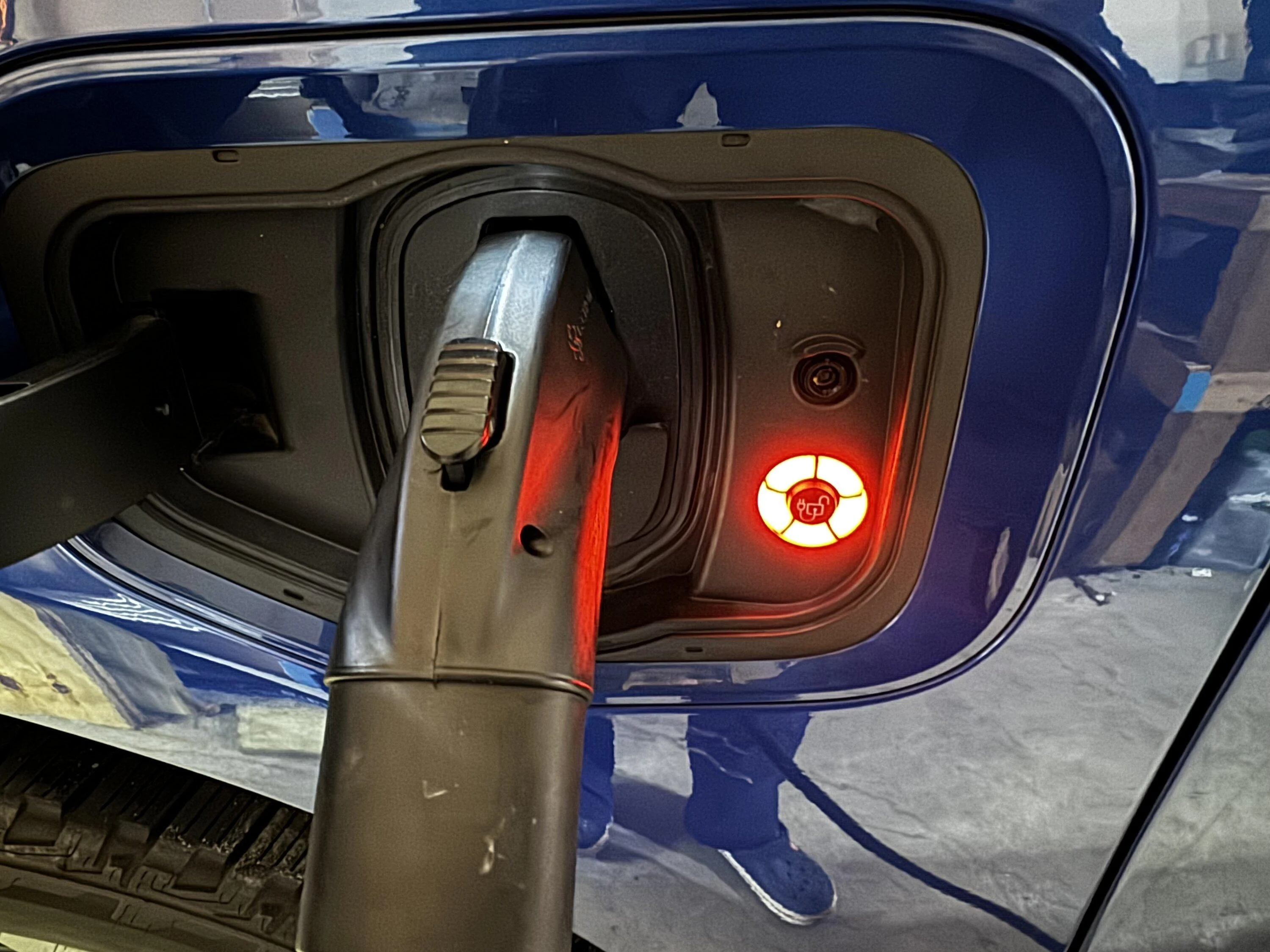

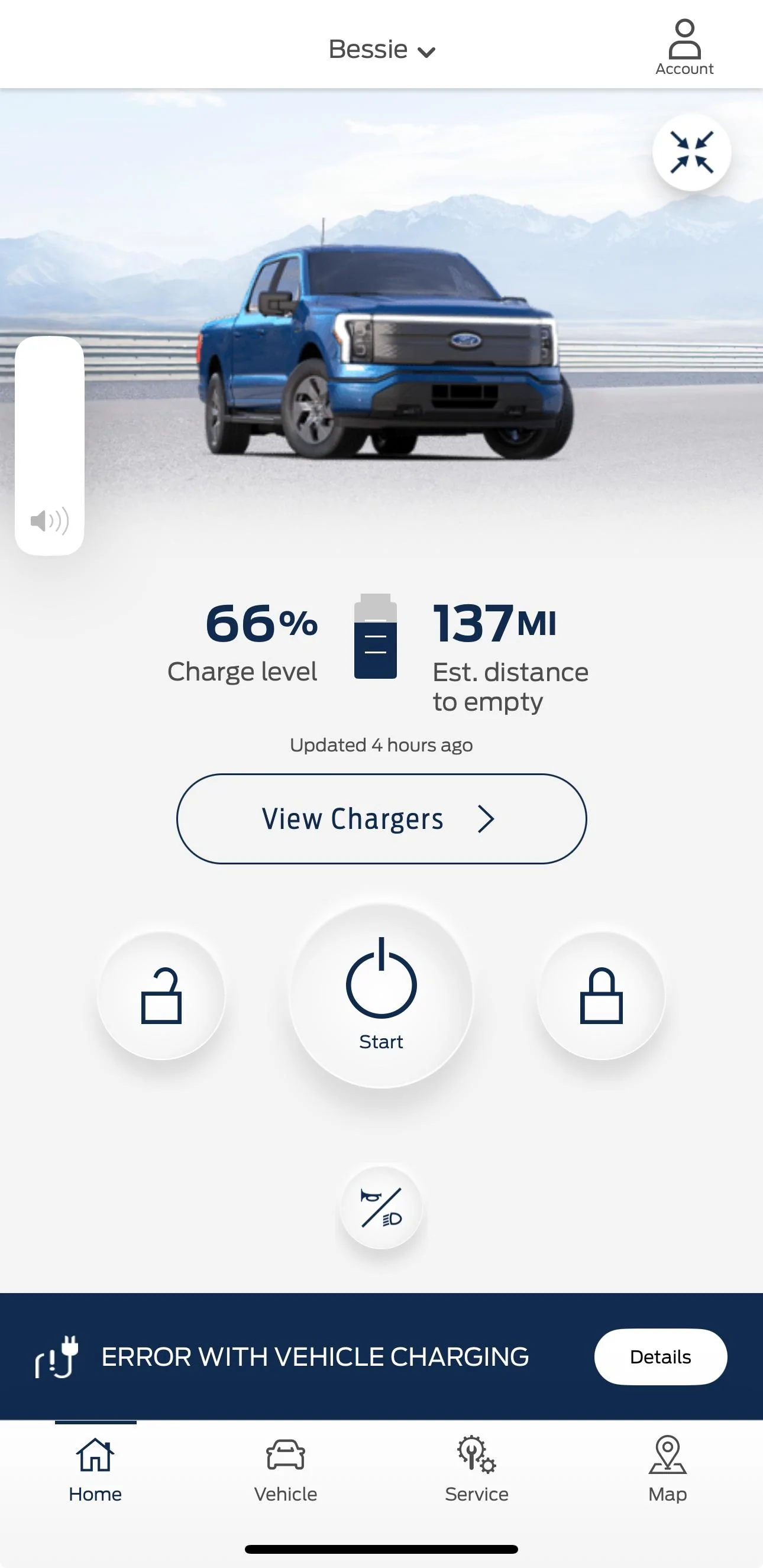

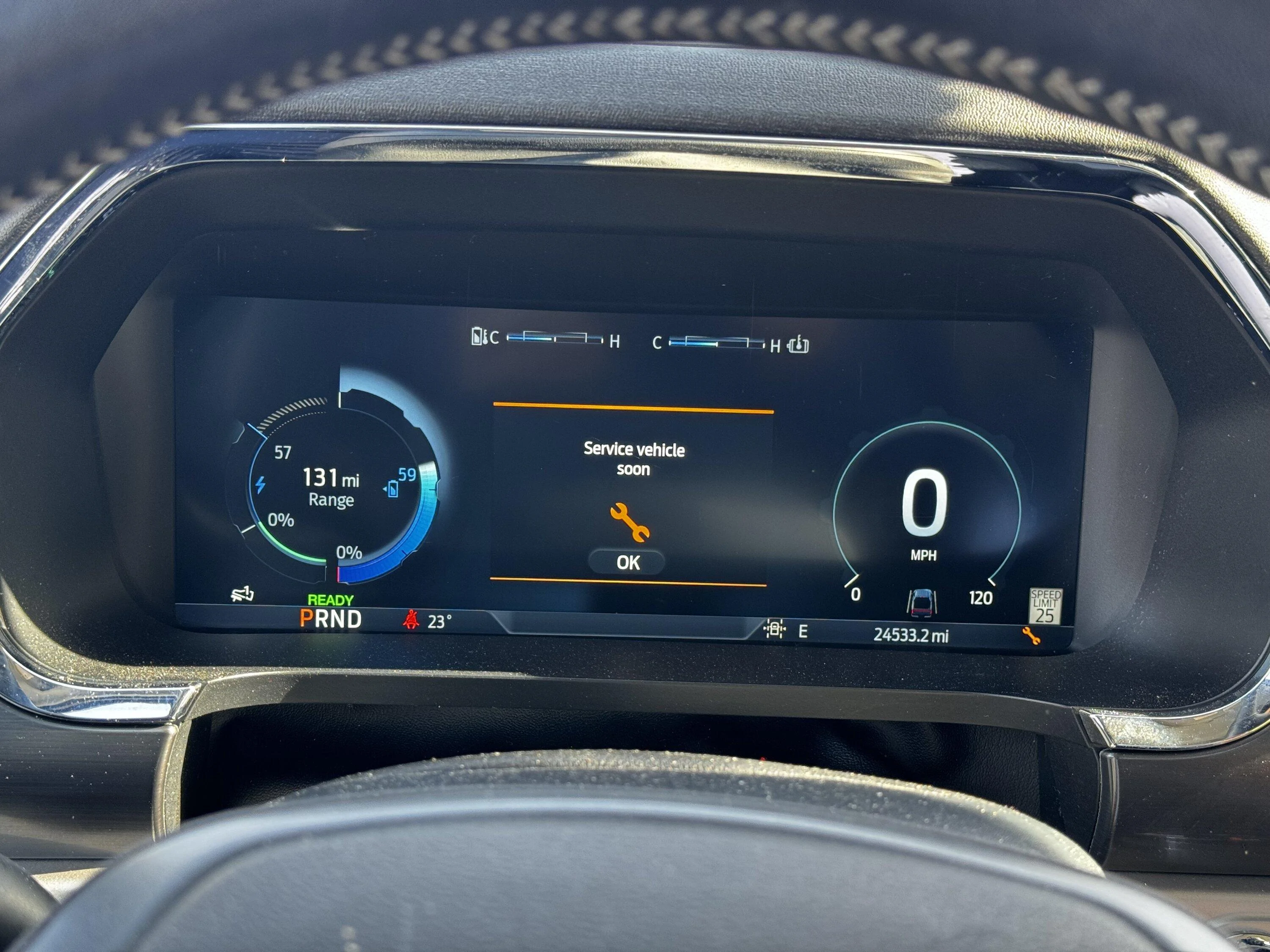

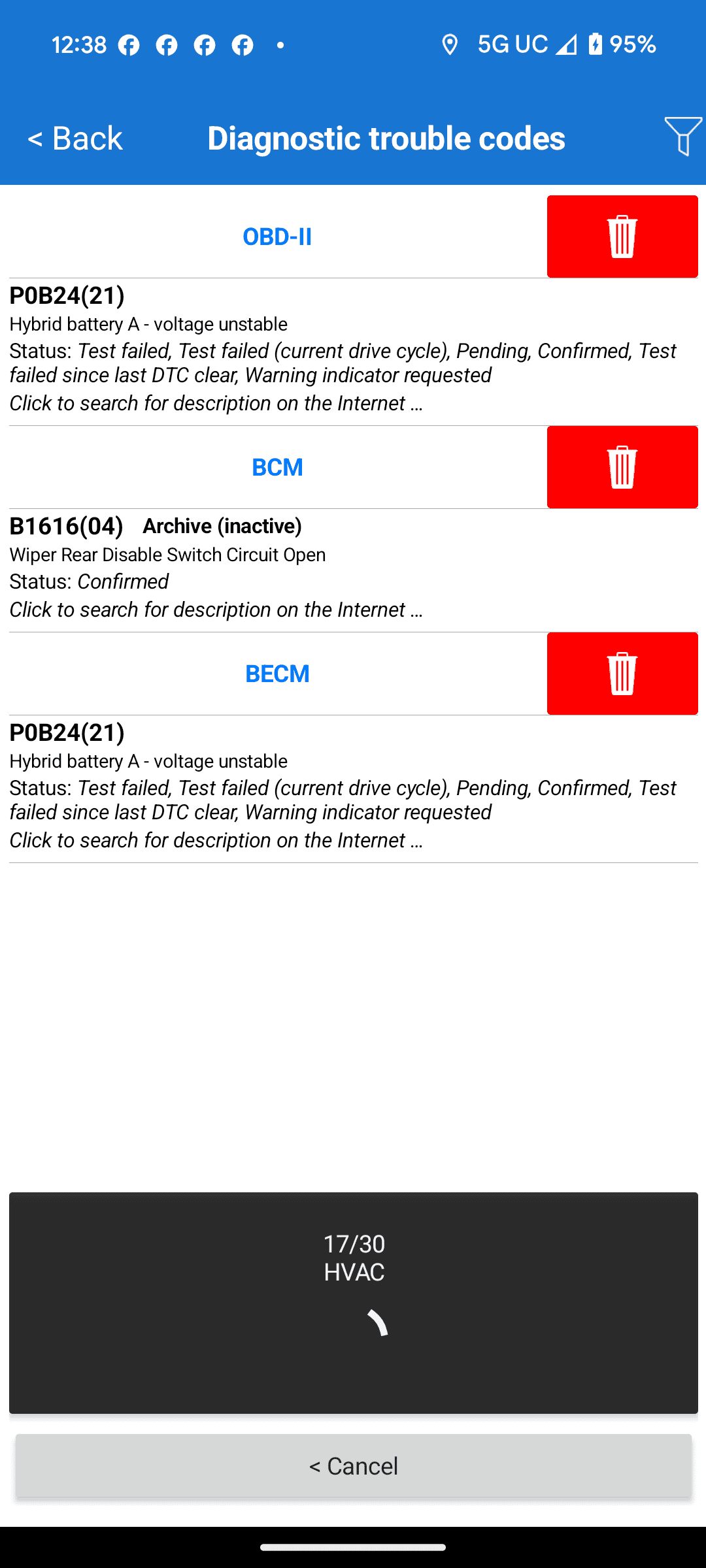

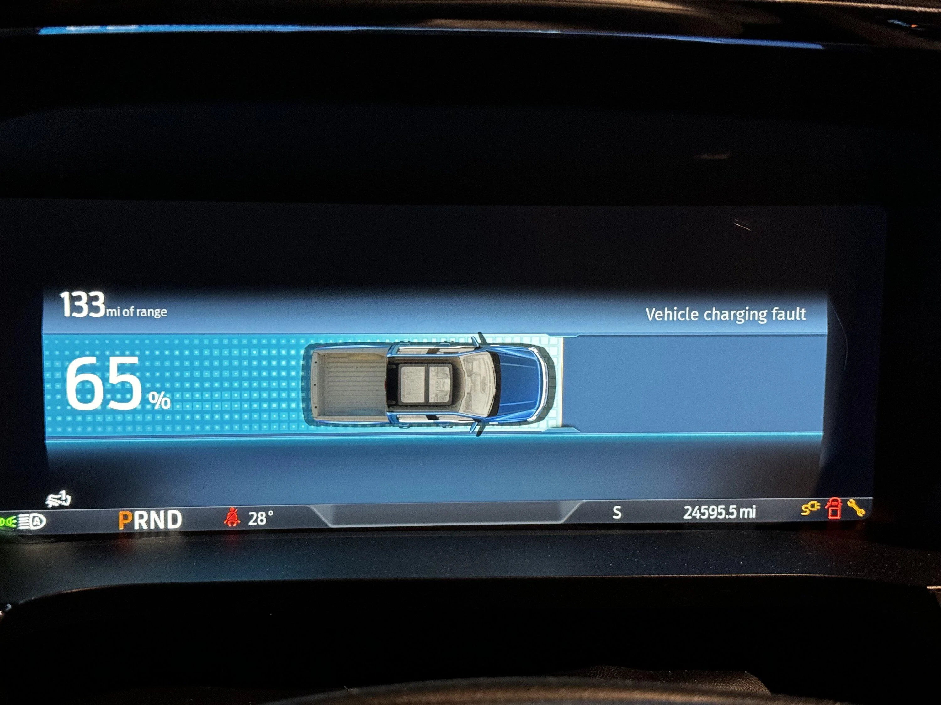

Nope. She’s dead.
I plugged it in last night and started charging normally. It gave up sometime in the middle of the night and absolutely refuses to charge. I just get orange lights at the charge port and an error on the dash. I can probably drive it to the dealer like this, but that’s the only place it’s going.

With that fault it imposes a charge limit so you can't charge to 100 or 80. So you can still drive and then charge again, just appears to be limited to 65%

Well dammit. My anecdote above may not have been positive.
Is this the error code related to this campaign?
To answer your question: Yes.
You have an unstable module that is reflecting an out of range charge level.
Sorry to see you have to deal with this, but it is time to return to your dealer.
