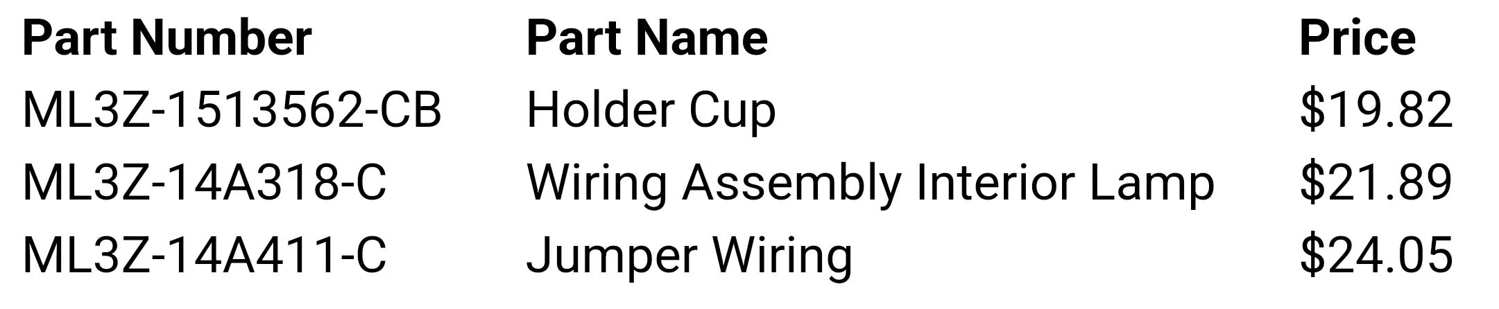

3,819
6,973
I ordered mine from Varsity Ford
Ford F-150 Lightning Cup holder light installation/media bin light/glove box light Screenshot_20220711-113257_Chrom
Reactions: GDN

Thank you both, each of those were a dollar to a couple of dollars more when I looked them up at those locations, not sure why. I had checked Tasca and ordered from there previously.
I have a cup holder but my sister has a '22 Superduty and figure once she sees this installed she will be wanting it too.
ML3Z-14A318-C Wiring Assembly Interior Lamp $22.37
ML3Z-14A411-C Glove Box Lamp $24.58
ML3Z-1513562-CB Cup Holder $20.26
