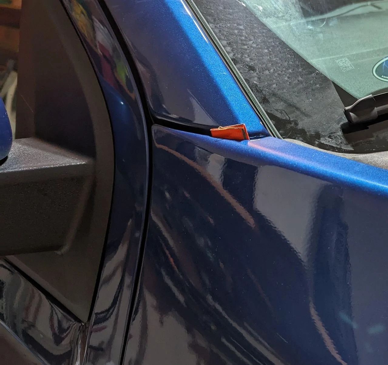

This was another fail, and the creaking came back.
I looked closely at everything near the A-pillar and windshield interface, inside and outside. I pushed on the front fender where it meets the A pillar. It produced the creaking noise. Had the wife sit in the car as I pushed and released the fender at the A pillar, and she confirmed that was the noise. So I wedged a folded up piece of Gorilla tape (orange in picture) between the A pillar and the fender. Pushed the fender up against the A pillar, and no creak. Took the truck on a decent drive and no creak. I think I finally cracked the code.
Not going to drive around with that tape wedged as shown in picture.
Have to go to the dealer for the latest 23B70 Battery monitor sensor software update, and will have the dealer look at this.

See my post immediately above. This was driving me absolutely nuts. In a previous life, I was an engineer in a factory, and I am a hound dog when it comes to troubleshooting. Try pressing back and forth against the front fender just below the junction at he A-pillar on the passenger side. You can see where I have an orange wad of Gorilla tape wedged there.
Funny thing, the tape slipped out a bit, and the noise came back. I gently pulled the fender back and shoved the tape back down in the gap (without any tools), and the noise disappeared again. Hopefully, this is it for you. I spent a lot of time on the vent trim with absolutely no luck.
Please post to see if this is it. Sometimes the dealer service is quite worthless in these situations.
Thanks, I will try this and repost with the result.
