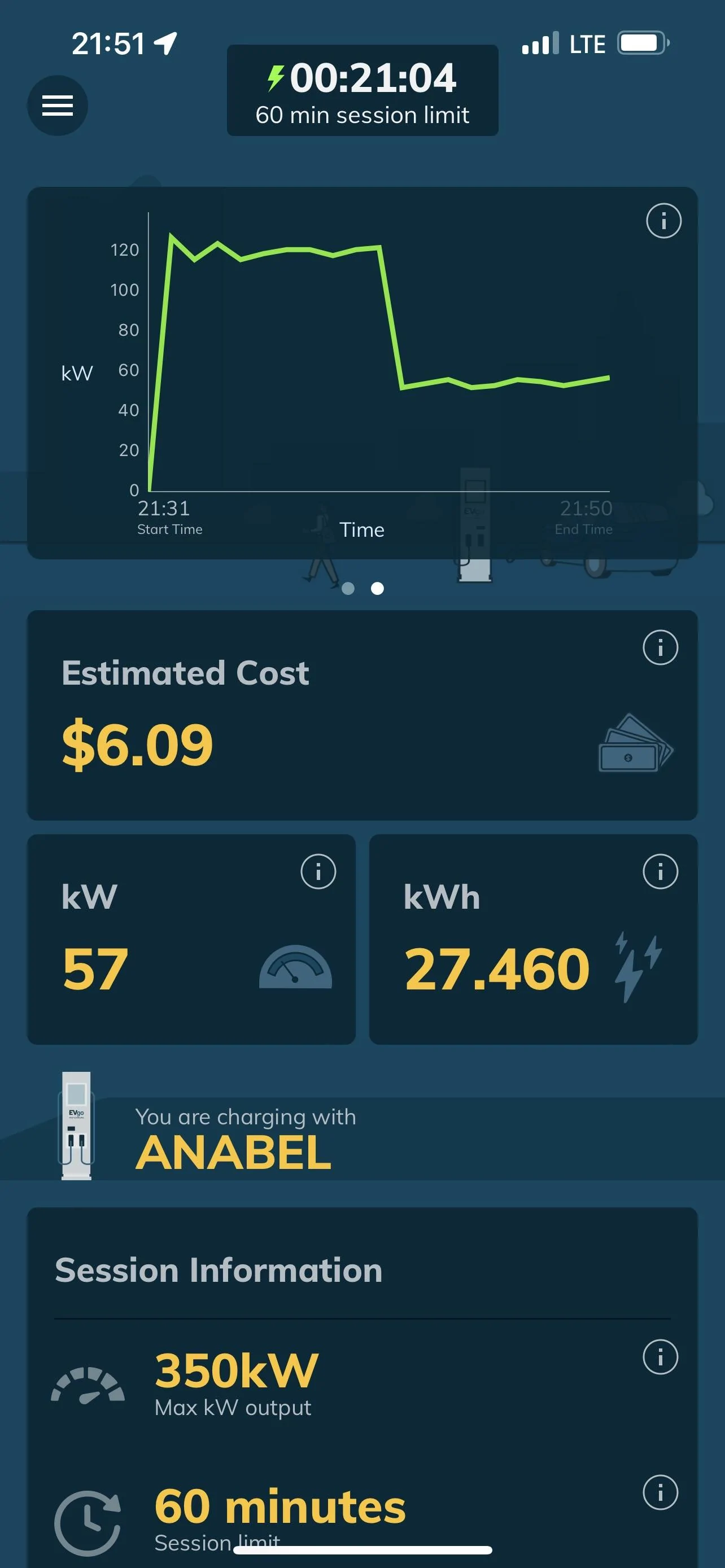

FWIW, my latest 3 DC fast charges over the past 4 days (I’m not concerned):
  1. 120 kW rated EZStop - unknown manufacturer: 64-90% SoC (26%) in 58 min, 35.76 kWh delivered; no Peak recorded.
  2. 350 kW (newly installed) EVgo: 66-87% SoC (21%) in 21 min, 27.46 kWh delivered; ~130 kW peak.
  3. 150 kW EA: 73-93% SoC (20%) in 41 min., 29.762 kWh delivered; 97 kW peak.
Just curious why you were charging up to around 90% each time (and why you were DC charging with so much charge left). Unless you need it to get to the next fast charger, you should stop DC charging around 80% as it drops off fast after that to protect the battery. That is true for just about any EV.

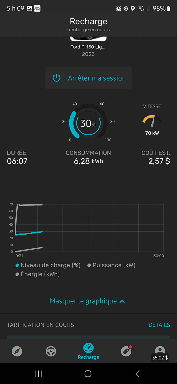

I've had my Lightning (XLT SR) for about a month and a half, and I have never seen my charging rate go above 72kW at a DCFC station. For a while, I thought this was normal, but I've seen many people online talking about their charging curve, and it sounds like I should be seeing around 120kW at least. I've used multiple chargers at different locations, and I am often the only vehicle there. My SoC when plugging in has been anywhere from 10% to 70%, so it's not the expected drop-off above 80%. The one I have used most frequently, I have seen other vehicles charging above 150kW, so I know it's not the charging station.
Am I doing something wrong? Is anyone else experiencing this?
I have the exact same problem! I can only charge at a maximum of 70kW.
May I ask if you were able to find the issue?
It ultimately ended up being what Yellow Buddy suggested, and was just poor charging infrastructure in my area. My truck was fine, the other vehicles I saw that were charging faster must have had higher voltage battery packs. Now that I have access to Tesla, I regularly see charging rates of 150kW+.
If you can, try to find a higher amperage charger. If you're in a rural area, you might have to go somewhere a bit more urban. Unfortunately it is not easy to find the amperage of a fast charger advertised anywhere, the best method I have found it to look at the comments on PlugShare and see if a lot of people complain about their charge maxing out around 70kW.
