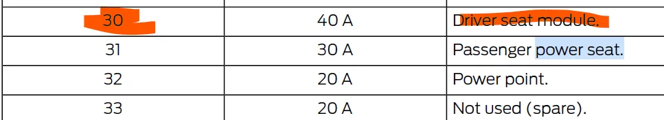

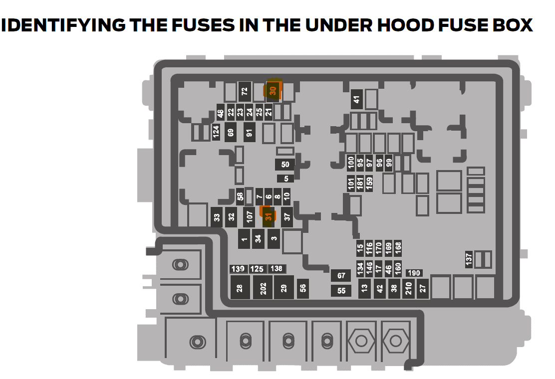

Anyone know of a fuse, or a plug under the front seat to the seat heaters? They are on high and I cannot turn them off because the screen is dead.. There is a 40 amp fuse for front seat stuff in the front, but I don't want to pull that, it seems like it would be for other things also. There are a ton of plugs under the drivers seat.

Pullled that 40 amp drivers seat module fuse. The seat heaters still remain on lol!
Got to be getting fed from somewhere else. Crazy
12,112
12,743
Sorry that didn't work.

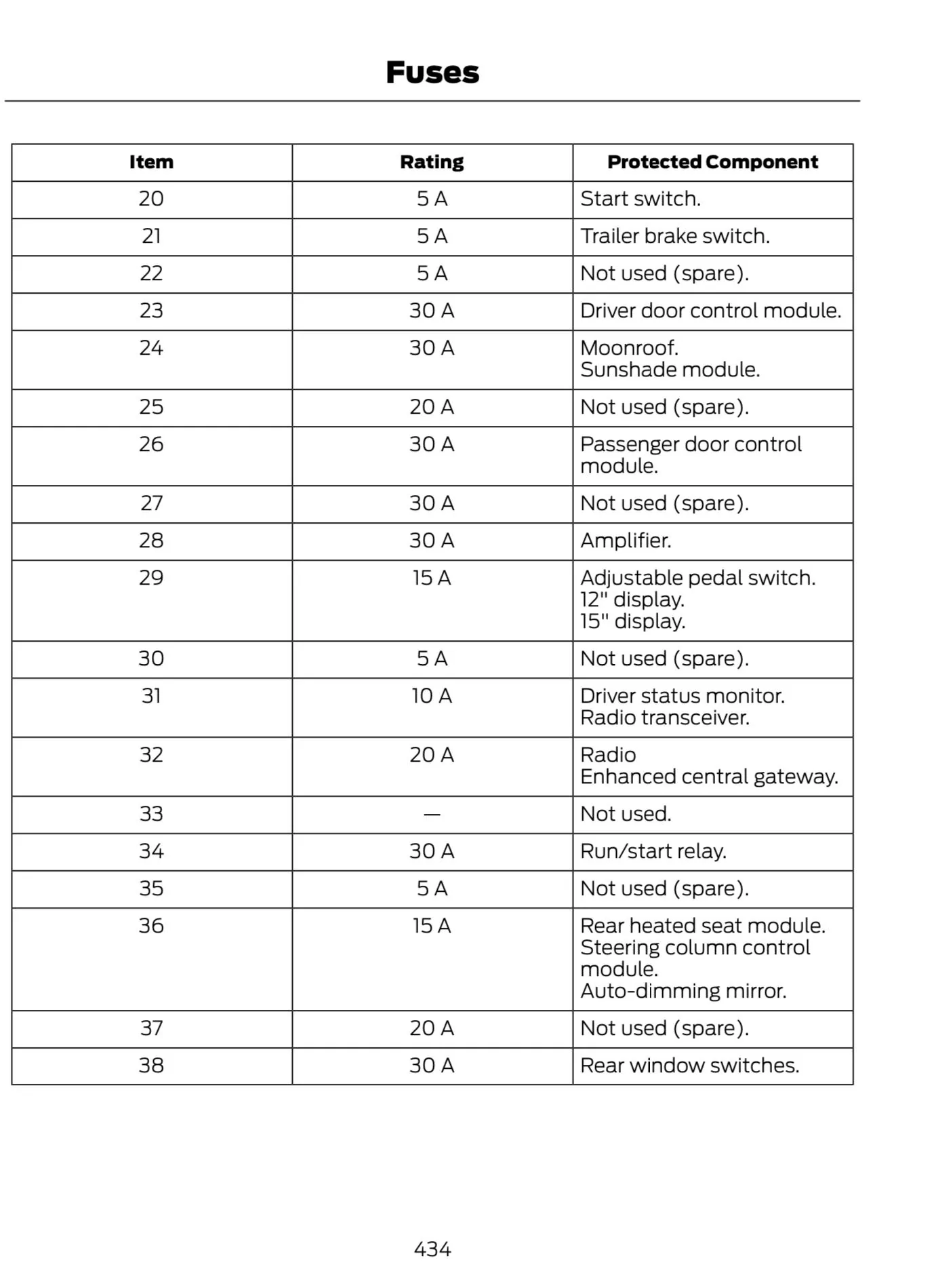

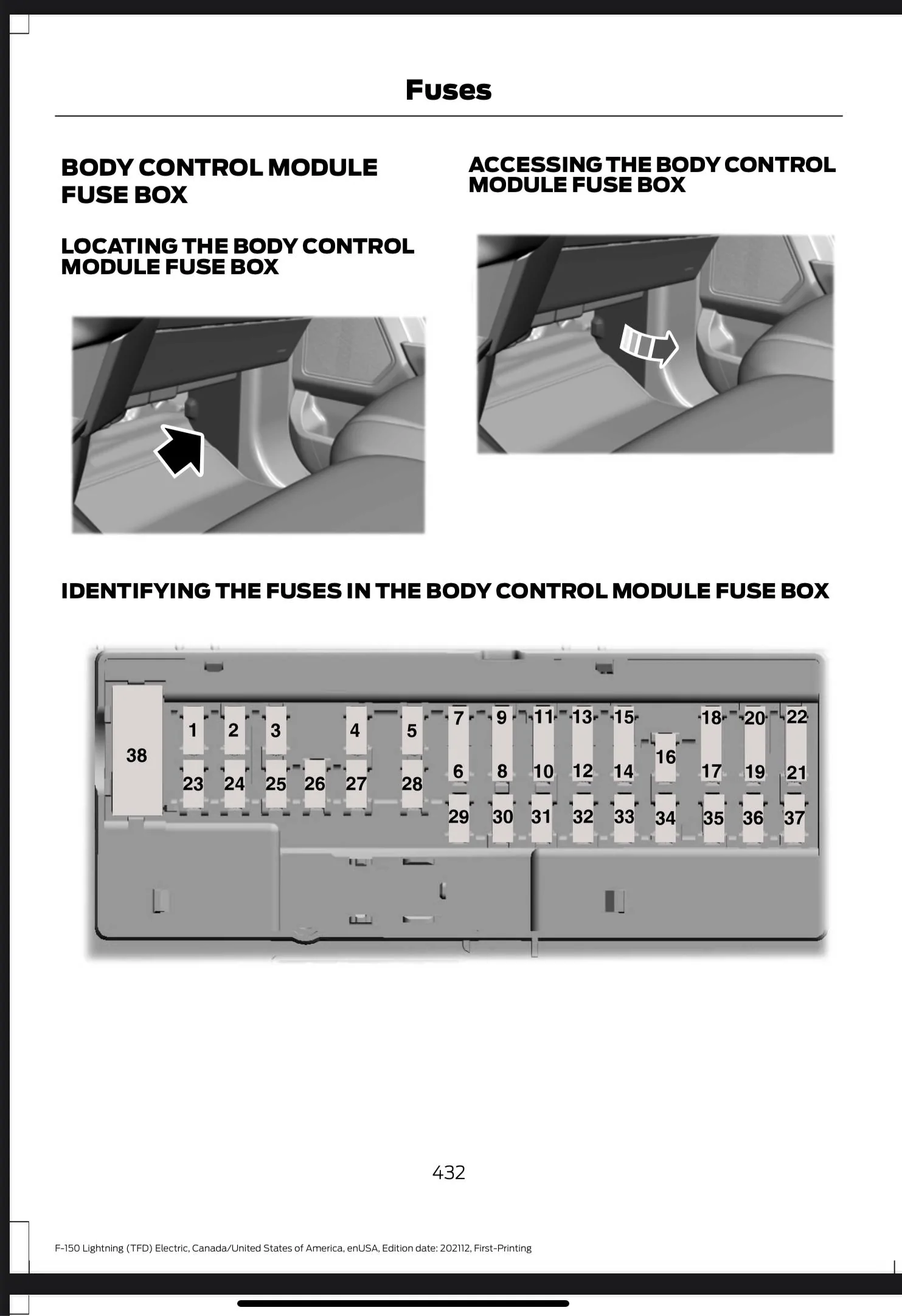

MJDore
Sep 10, 2022
122
175
SE Michigan
2023 Lightning Lariat ER
Finance
Fuse 32 on passenger side fuse panel is the one I pull when I get the unresponsive modem issue. It’s described as radio central gateway in the manual.

Anyone know the under seat plug for the TED module in these trucks?
