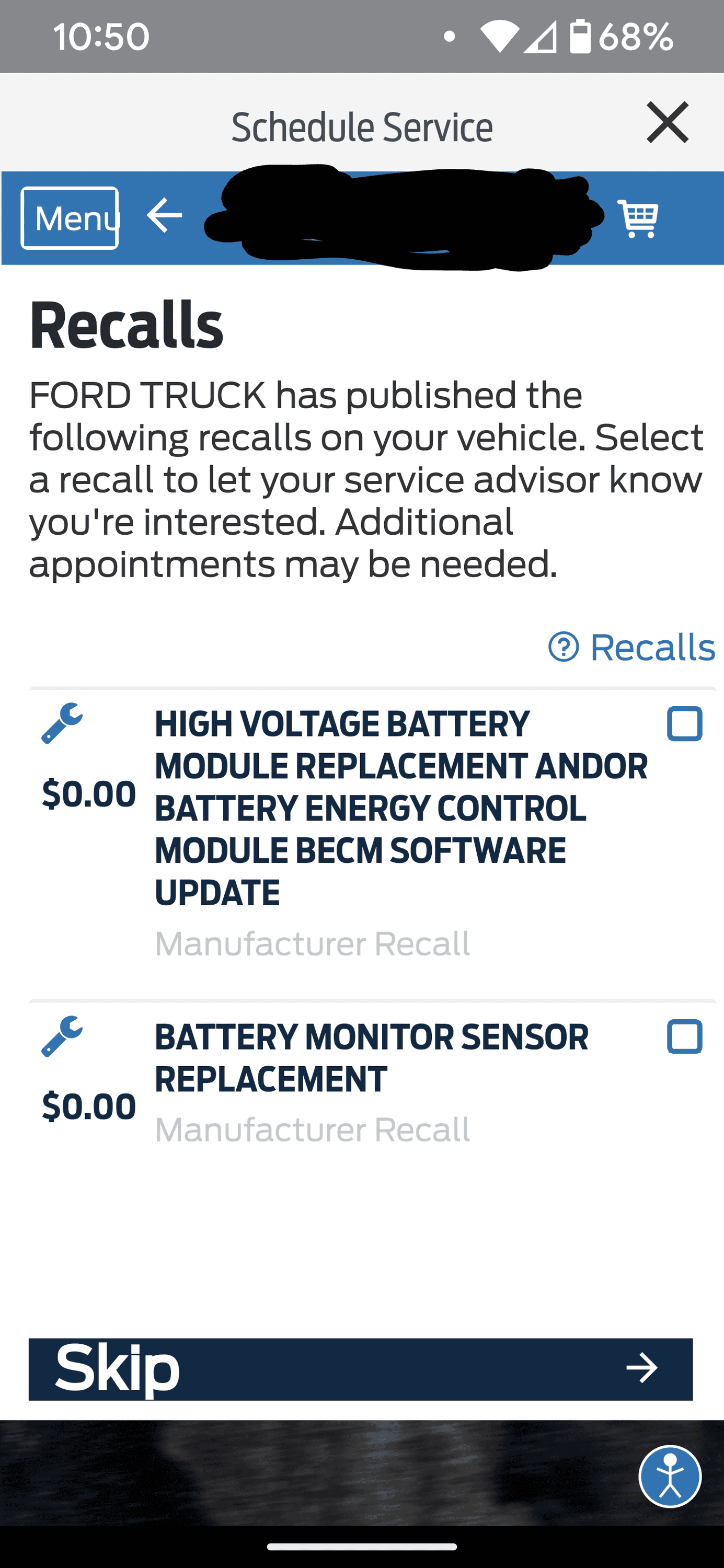

Just bought an XLT ER from Ford dealer. I've had it two days and it threw the HVB fault telling me to pull over. (Of course the happens Friday evening during heavy traffic.)
I had it towed to the nearest Ford dealer (but not where I bought it.)
I come to find out it has two mfr recalls pending. My VIN is 53xxx.
What are the chances this is an easy (software) fix and won't have my two day old truck at the dealership for a month waiting on parts?
Second question is that I was reading that it is against the law to sell a new vehicle with open recalls. What kind of recourse should I seek if it's sitting at dealer for an extended period?

Unfortunately they might not have run the diagnostic on the HVB after flashing the new BECM software, they "Should have seen a potential issue then.
Technically it's a CSP not a recall, though ford had requested all in stock trucks have the software remedy applied and HVB diagnosis checked before sale.
Get ahold of the Ford BEV team for an approved loaner vehicle, if a battery module needs to be pulled, it could take anywhere from [less than a week to several weeks] pending parts and the tech's availability where your truck is currently parked for service

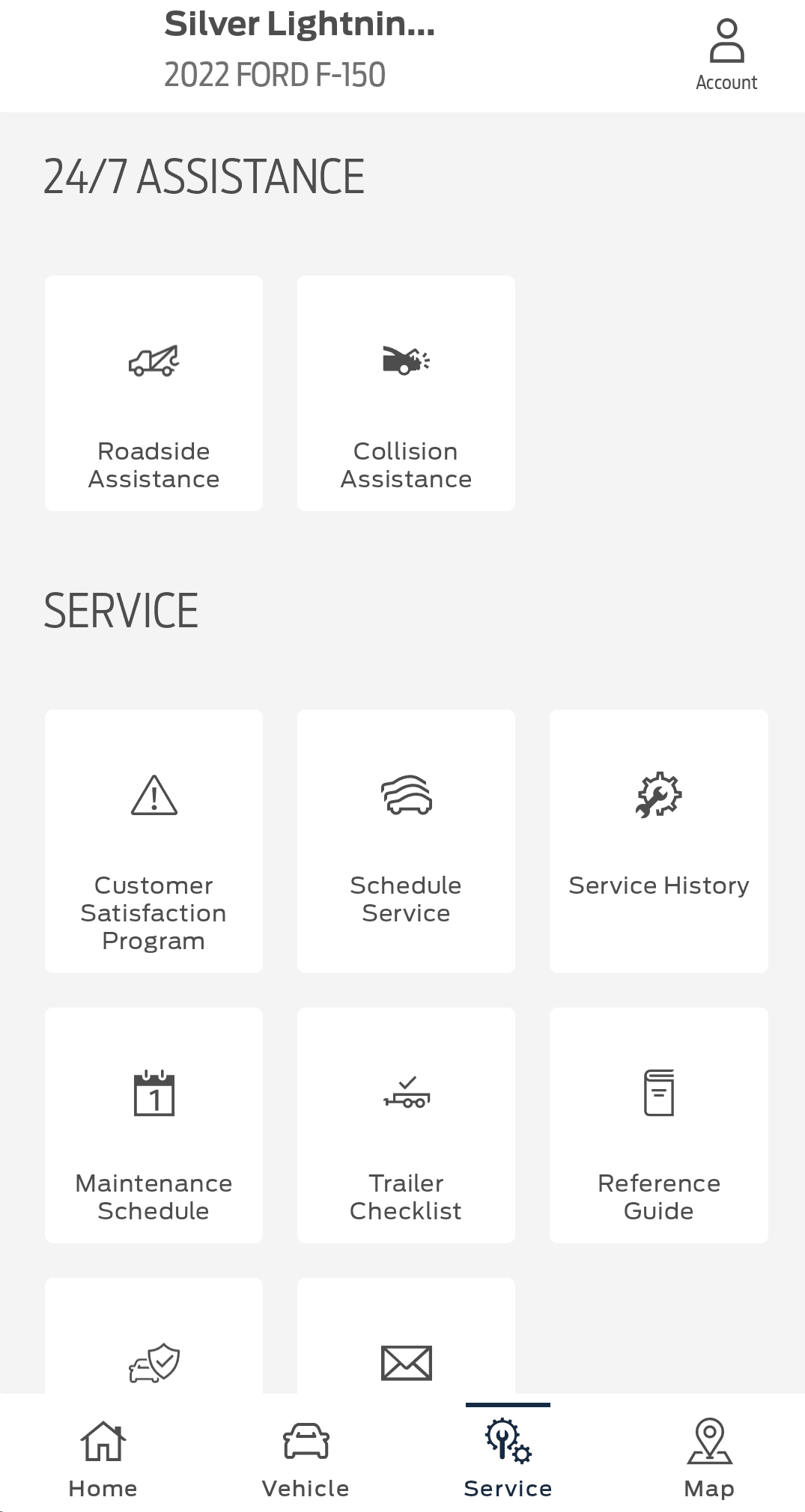

You should be able to see the CSP's listed in your Ford Pass under the Service tab > Customer Service Program.
Also actual recalls have their own tile under Service tab, mine is hidden at the moment since my last recall was for the tailgate light and wiper motor replacements, previously done.
Thanks for the info. I guess I'll find out sometime next week. It's at a large dealership service dept and hopefully has more expertise than the rural dealership that I bought the truck from.
Sorry to hear about that. Hopefully it is fixed soon and you'll have a chance to love the truck.
Not sure what app you were using there but as @TaxmanHog pointed out, those were not recalls but Customer Satisfaction Programs. So not subject to a stop sale. Also the BECM CSP is sometimes not cleared by the dealer after the software update is applied because it could still throw a fault (like yours did).
Good luck.
