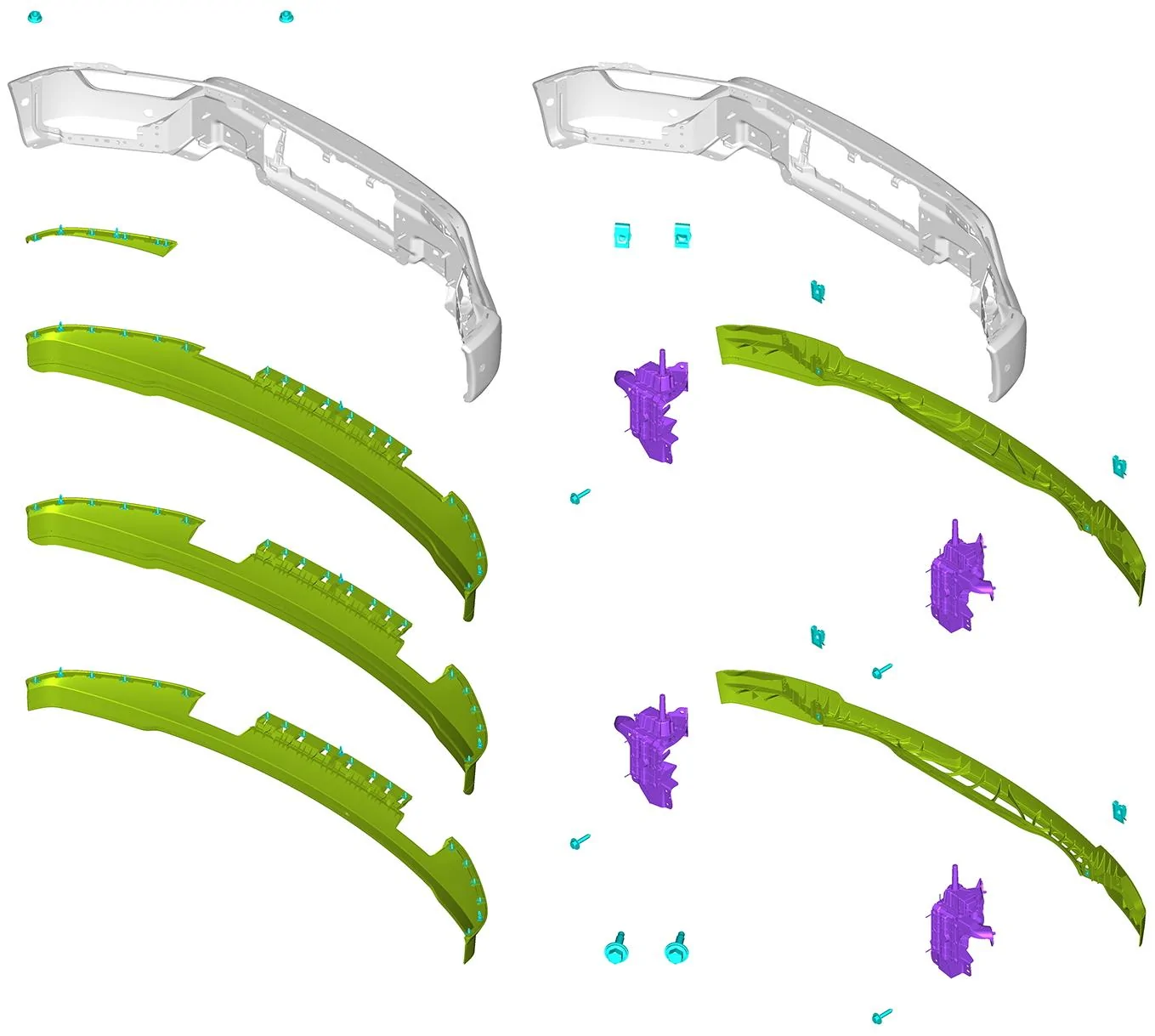

Just in case anyone else is curious, here are what I think the part numbers are for what I needed for my 2023 Lightning XLT. Those seem to be hard to track down from what I have read in the forums. Please confirm since the descriptions seem a little odd to me.
P/N Description
NL3Z17626C Front Valance Panel
NL3Z17626H (Actuator) Valance Panel Bracket. Trim - Left, Front, Lower
Parts List Diagram
