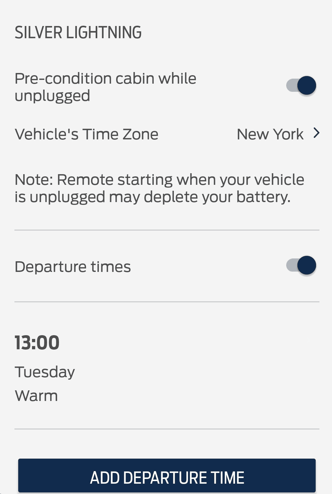

I'll assume everyone is at Fordpass app version 4.32.1 which is the most recent version that was to fix some glitches and issues with departure time. I haven't used it in a while, but just set up a scheme for this afternoon [Tuesday] I'll see how it goes, if it worked, then later try to delete it via the app and confirm in the truck / Sync screen that it was deleted.

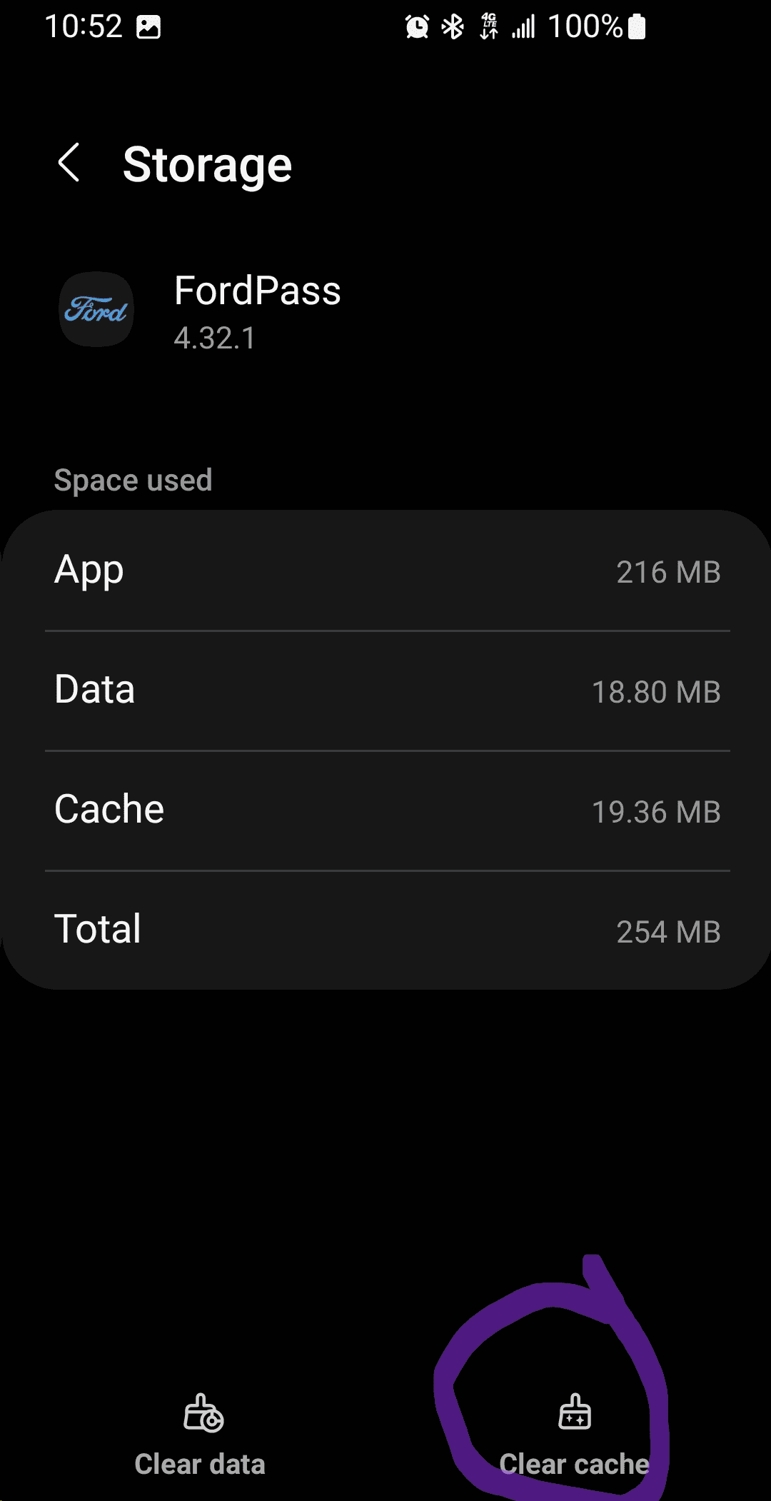

BTW, try force stopping your app, then clearing only the cache, might help / might not
PS DO NOT clear data or your PAAK settings and pairing will be hosed.

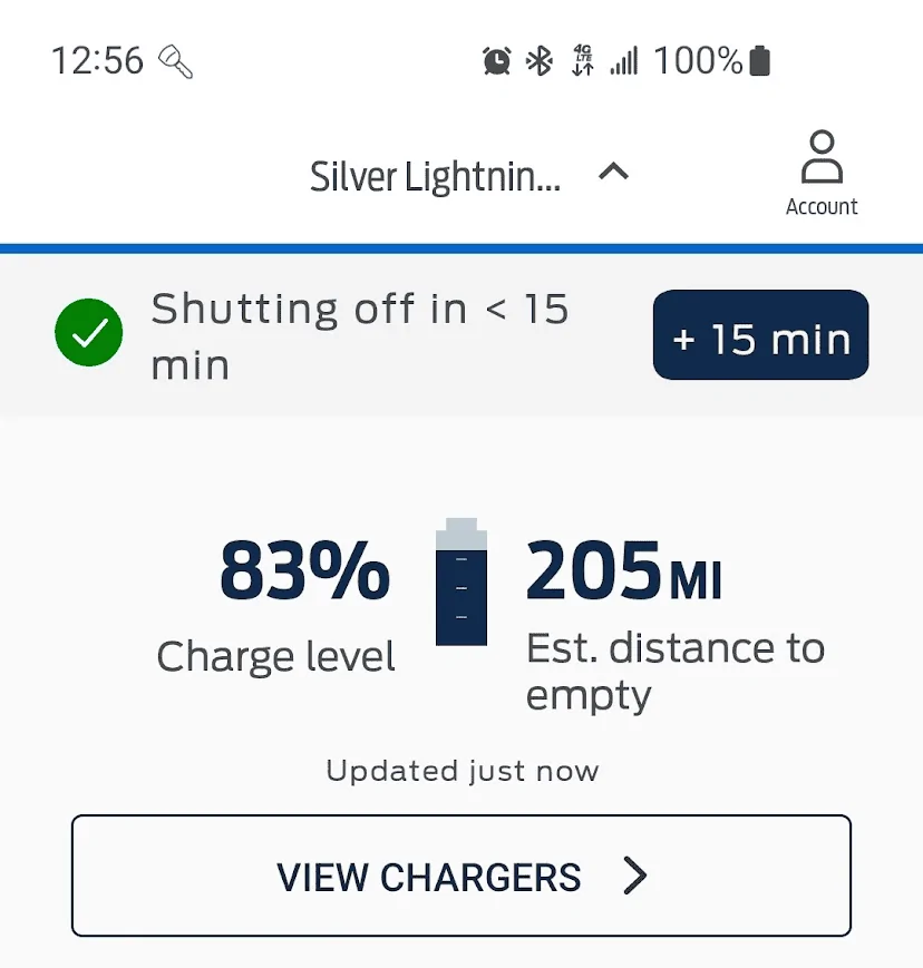

The departure time event kicked off the remote start session at 12:55:30, it will run for my preferred 15 minute cycle and the truck will be 1/3 ready by my standards at 1300 hrs.

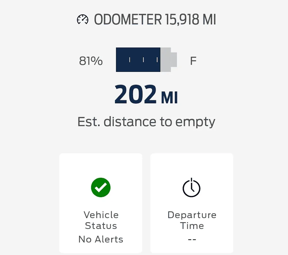

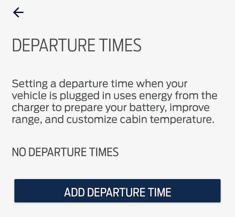

After we arrived at our destination, I used the app to delete the recently executed scheme, it cleared from the app just fine, I then force stopped and cleared the cache just to make sure that I didn't have a false message that it had cleared, after restarting the app, the scheduled event list was empty
Ford F-150 Lightning Departure time issues 1708457044283
Ford F-150 Lightning Departure time issues 1708457059224
After dinner, returned to the truck and confirmed the departure times were erased as requested via the app.
Only thing I can suggest to the OP is clear the cache, force-stop, restart the app and switch off the timer or delete all the schemes.

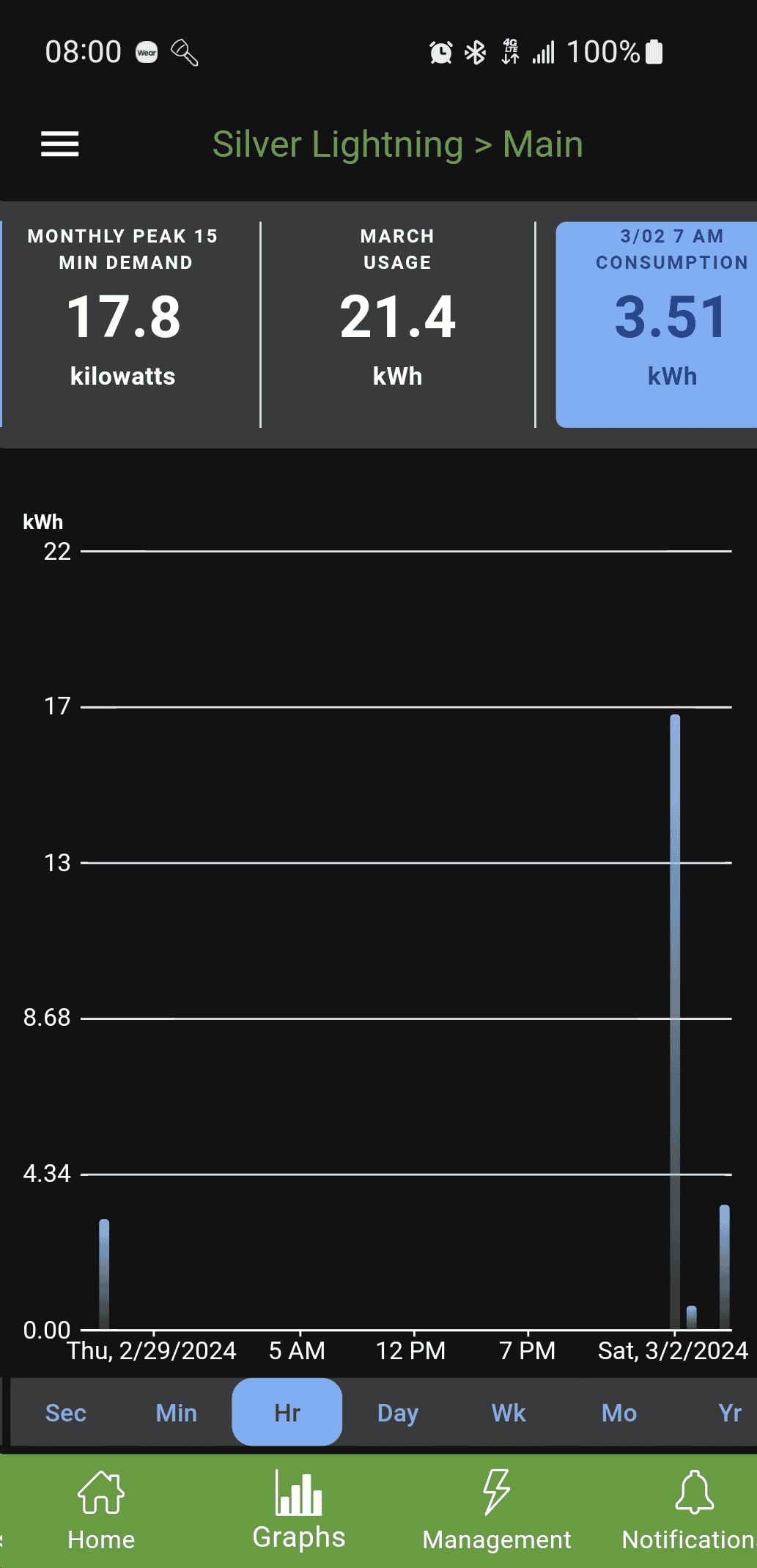

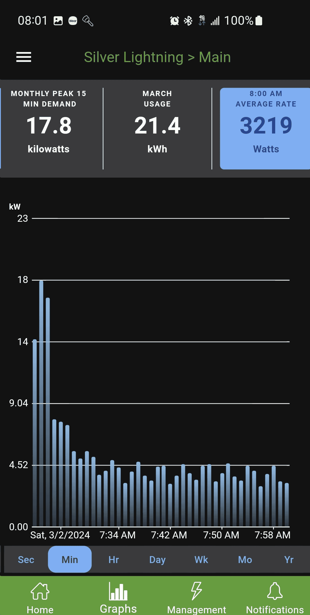

After the most recent couple of OTA's I retested setting and executing departure times, this session is while plugged in, I set it for the truck be ready at 7:50 to maximize cabin warm up phase, I will let continue to run until 8 am, all appears to be working normally.
The system decided to begin the process at 7:20am, there was little need to pre-warm the battery since my charging schedule had run from 4am to 5:02am pulling in 17.9 KWH with related heating, early morning temperature was 33°, it's now 37°.
Total energy to prepare for drive is 3.51 KWH over 40 minutes
Ford F-150 Lightning Departure time issues 1709384421265
