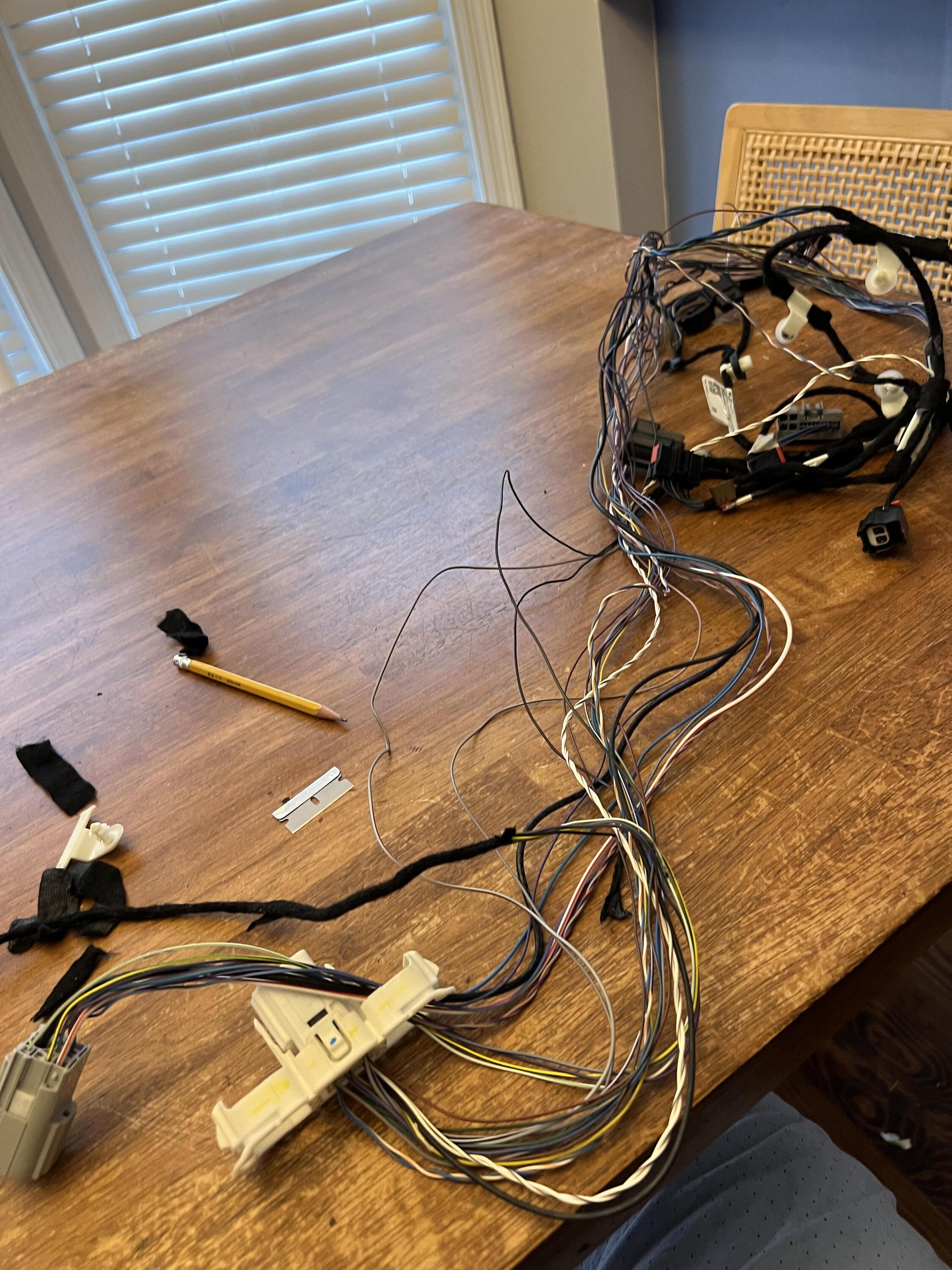

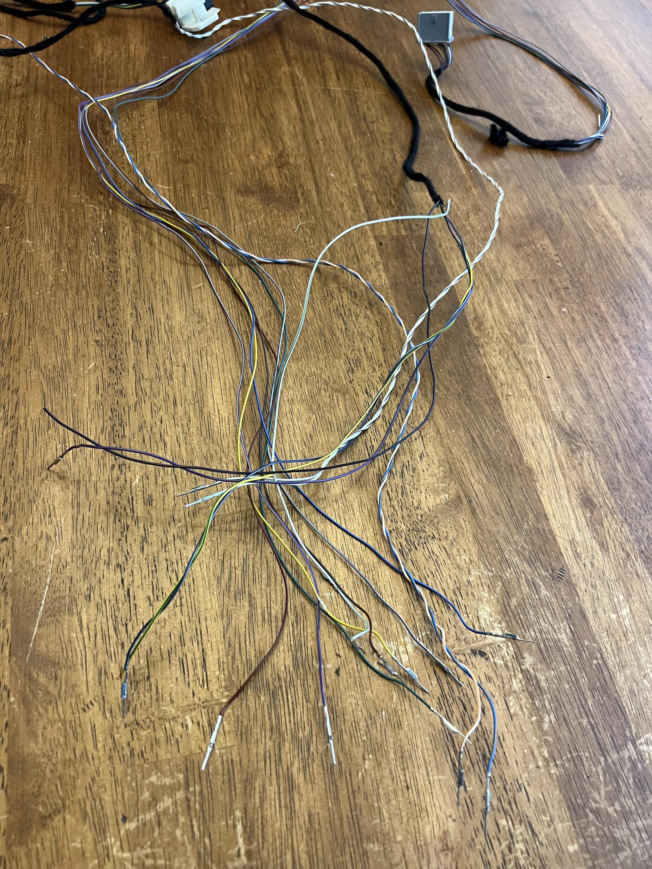

Thank you Zach! Got your harness in yesterday. Took the tape off and unpinned the connectors...
Ford F-150 Lightning DIY: Installing Passive Entry To A 2022 F-150 Lightning XLT unnamed
The plan is to use the twisted pair wires for the ANT signal and single ended wires for GND / PWR. Ordered some cloth tape to wrap it all back up.

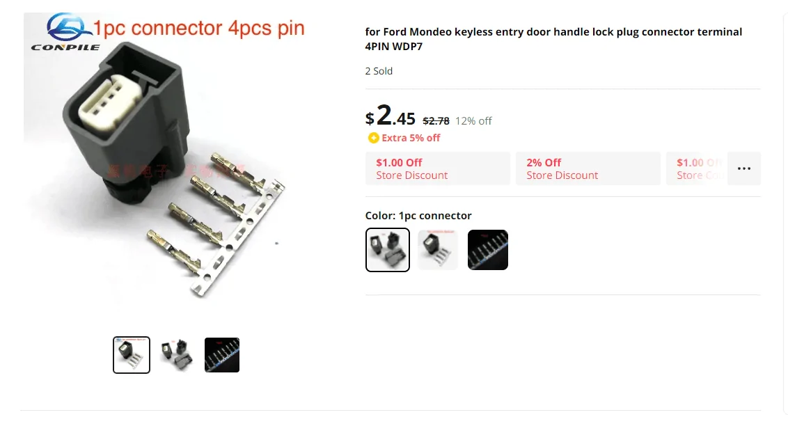

I believe I found the connectors on aliexpress and they should be here in the next week or so. fingers crossed

The plan is to add the wires to my existing harness for both front doors.

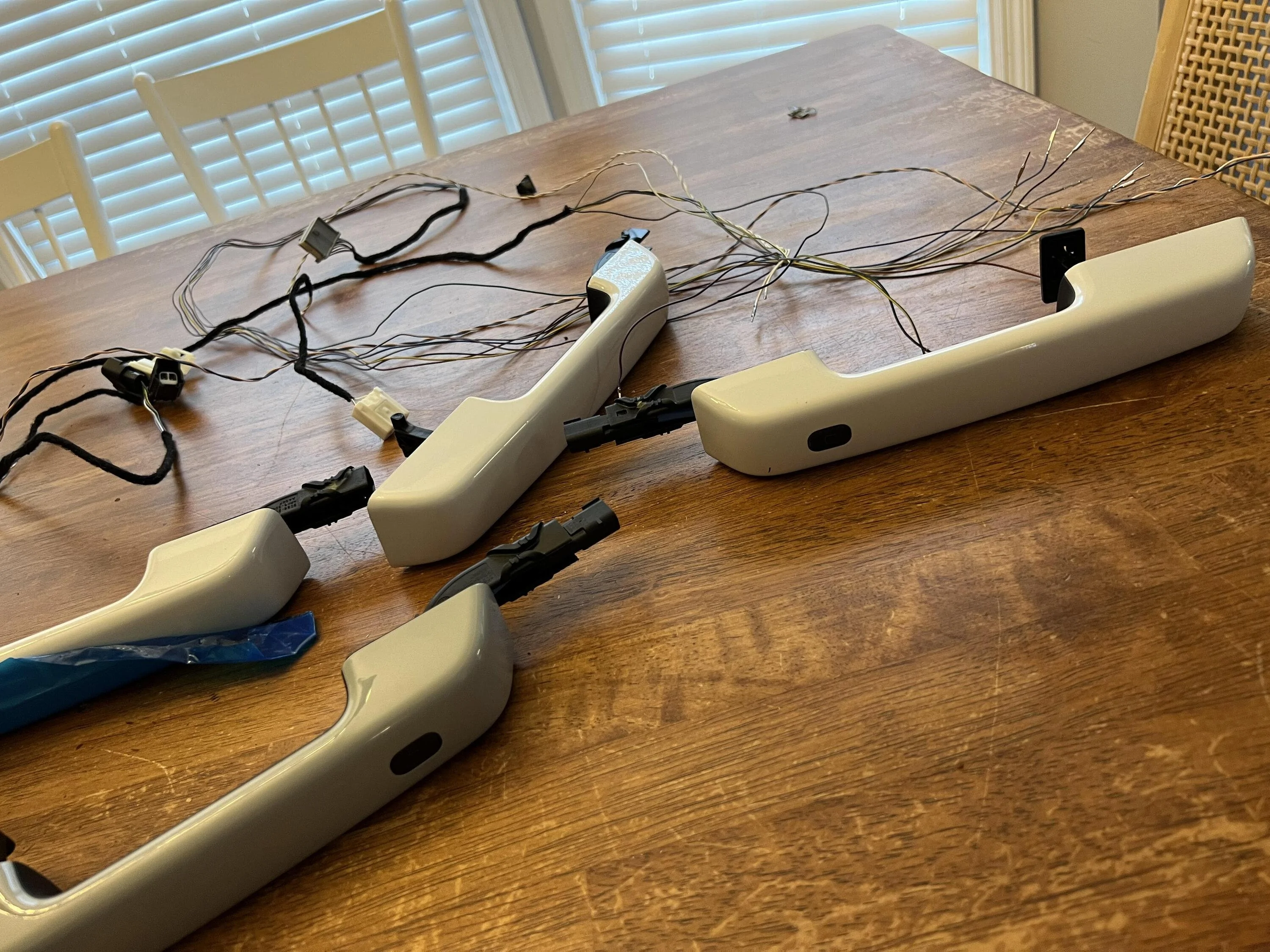

I like painted door handle look so I ordered some on ebay. Got the door handles handles in... Now I just need the china door handle connector to piece it all together....
Ford F-150 Lightning DIY: Installing Passive Entry To A 2022 F-150 Lightning XLT unnamed (2)
Stay tuned....
Stay tuned....

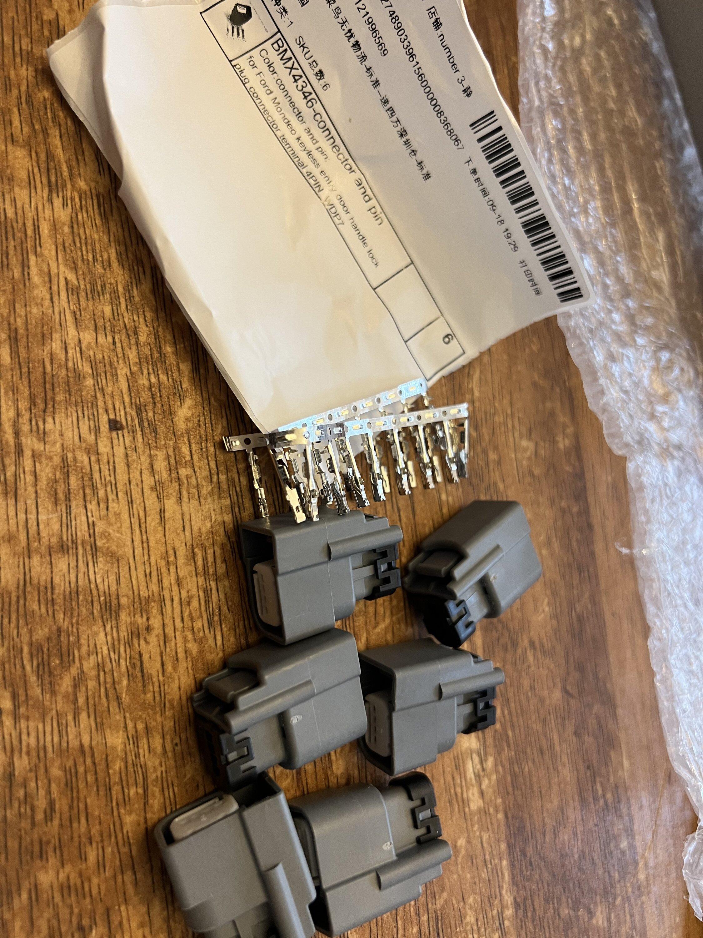

The mailman decided to drop off the China connectors just now! Whooo… now to start the install.
