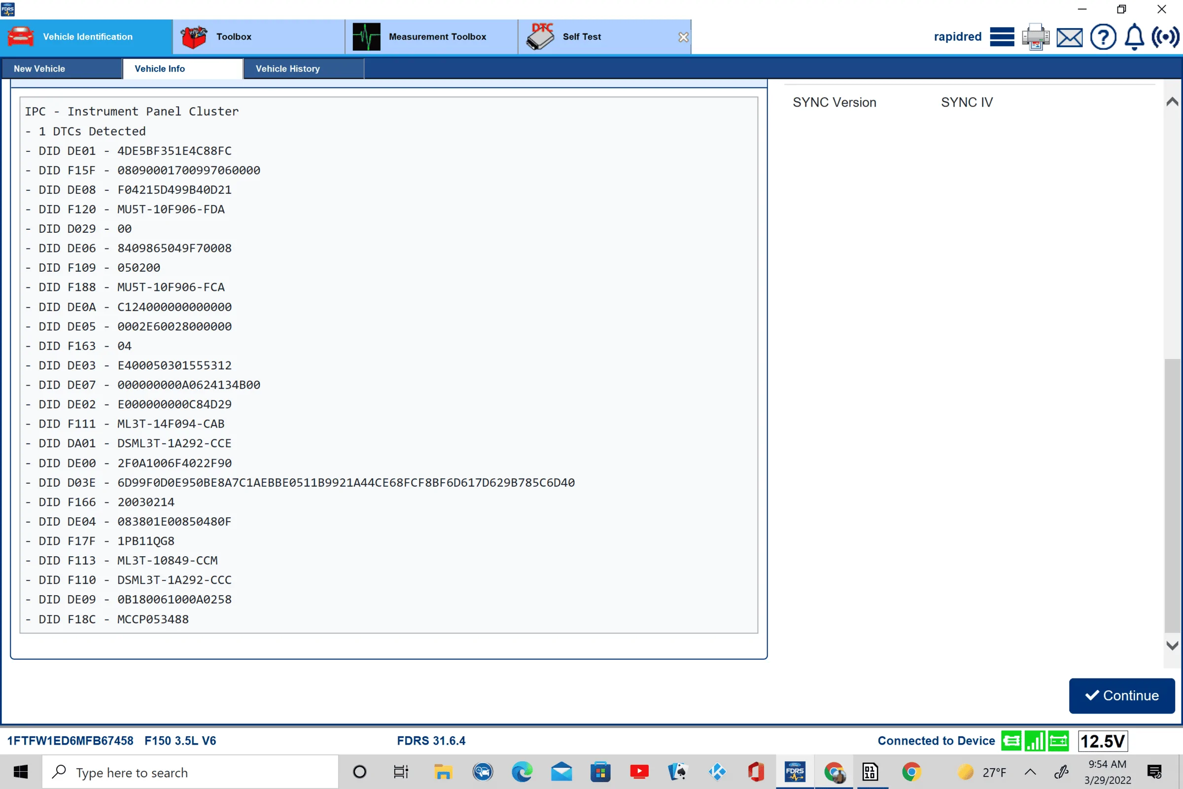

Sometime during a series of SW updates, not sure exactly which update, I lost Heated Steering and Heated/ Cooled seats functions. The rear heated seat buttons work, they are located on the center console facing the rear seats. The 5 On/Off buttons controlling the Heated Steering wheel and driver /passenger heated-cooled seats do not work. They are side by side and located on the dash underneath HVAC controls. The fact that I lost steering wheel and seat functions at the same time, and the buttons are side by side on the same row, make me think its a single problem.
Using FORScan I have changed AB 720-05-02-5xxx-xx__ to 720-05-02-0xxx-xx__ and then back to AB in an attempt to wake things up. This had no affect. There is a DSC in the IPC
Code: U2100 - Initial Configuration Not Complete
Status:
- Previously Set DTC - Not Present at Time of Request
- Malfunction Indicator Lamp is Off for this DTC
Module: Instrument Panel Control Module
Could this DTC be the issue? I have not been able to clear this DTC using FORScan. Any suggestions would be greatly appreciated.
If that is the error you have you may have the issue other have had where one half of the update installed only.
in fdrs when it first loads and lists the modules select ipc
at the bottom there will be a readout of all the info send me a pic of that info I’ll know if I can fix it for you like I have for a few others

thx @Jesse-Infotainment , my FDRS license has run out. Been trying to fix this with nano and FORScan. It is time to bite the bullet and get the Mongoose /30 day license?

I re-uped my FDRS, here is a pic of the screen. Let me know if you need anything else. Really appreciate you looking at this.
