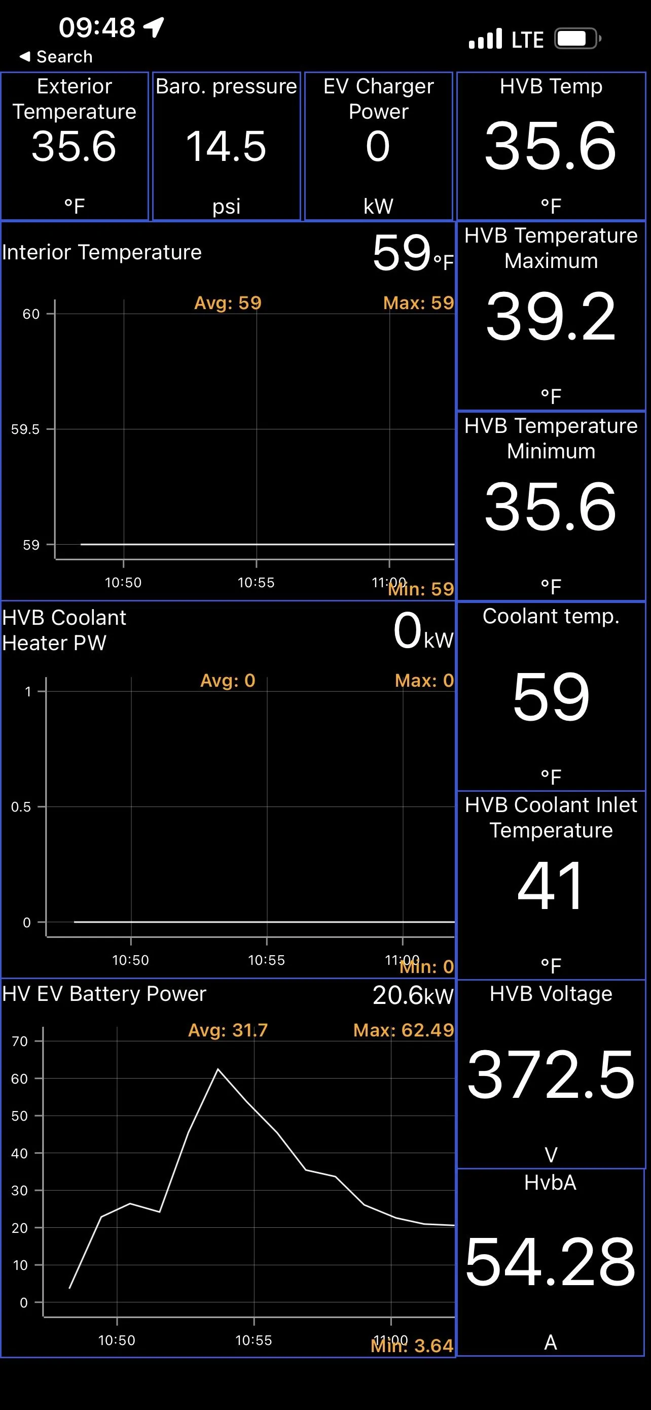

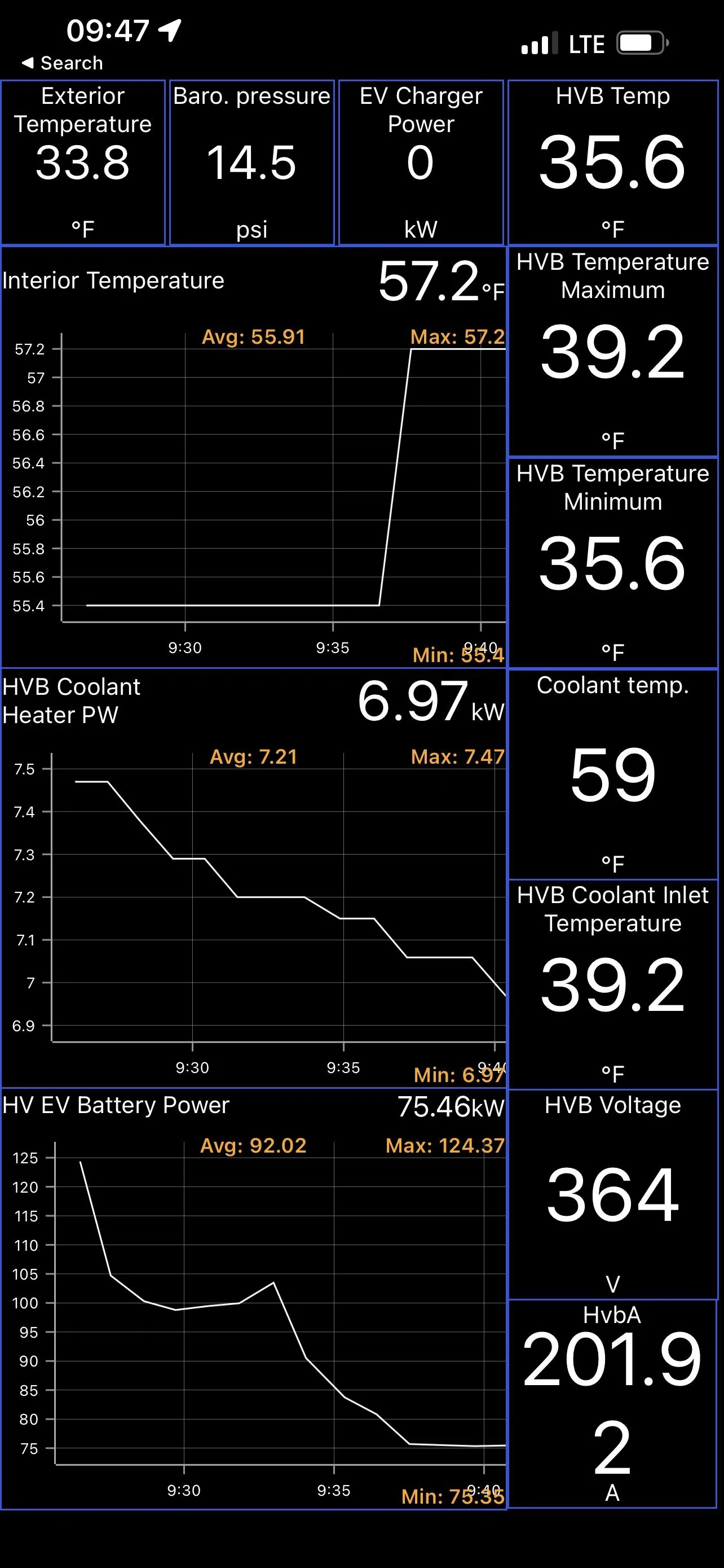

Ok, now that I think I‘ve got the E-Heat PW PID identified, I put together another CarScanner Dashboard to use for my future Preconditioning/Battery Temp Control Power Demand testing.
I tried the new dashboard out this morning … the attached screenshot was at ~5 min. into a cold start. I noted the Coolant Heater only appears to draw power when heating the cabin. I’m seeing an initial spike at the beginning of the drive in the 8-11 kW range which settles down to the 2-4 kW range as the cabin continues to heat…in one case dropping to zero for a moment as the cabin heater cycled. Also, I found it interesting to see the HVB temperature vs. the coolant temperature
These screen shots taken ~1 min apart while driving at ~45 mph….

Thanks for the two dashboard posts with the dynamic driving info. Very interesting data on the battery temperature in both posts.
It looks like the battery "coolant" temp is starting to warm the battery up from the initial cold start. Have you noticed how much the battery will warm while driving?
Not yet…I’ve just done a two short (~10 min each) cold start drives today to test my newest dashboard that were only at 25-45 mph (https://www.f150lightningforum.com/...itioning-detail-information.13353/post-280639).
The Coolant Temp held constant at 59 degF while the Battery Temp stayed close to the outside air temp. I definitely need to get it on the freeway and heat those batteries up?
I’ve downloaded the CSV files from today and will look at the data to see if sufficient to analyze. I’m also still reviewing the limited number of PIDs visible to CarScanner to see if there are any others that will provide supporting data points.

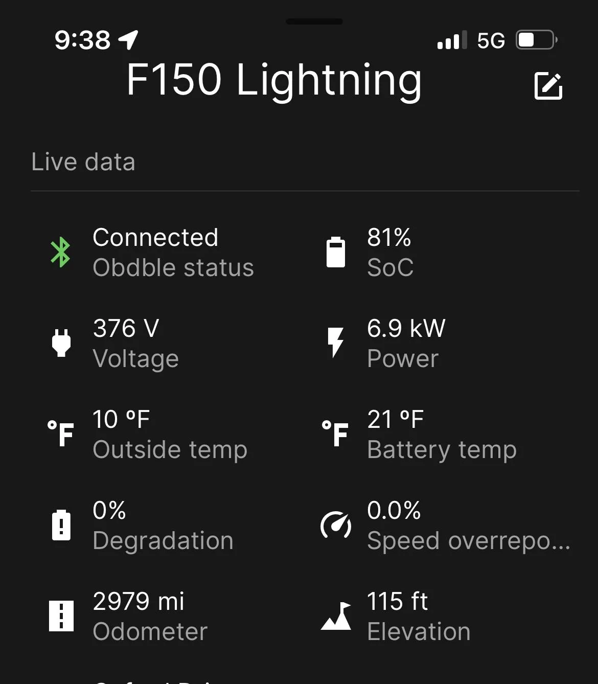

My battery temp hit a low of 21 degrees yesterday. I would love to find the battery heater sensor. Just got car scanner app so messing with that. Today Within 3 hours of shorts drives and stops my battery temp dropped almost 20 degrees today from 55 to 38 degrees. Seems like once battery temp drops below 30 power starts to drop on dash indicator.

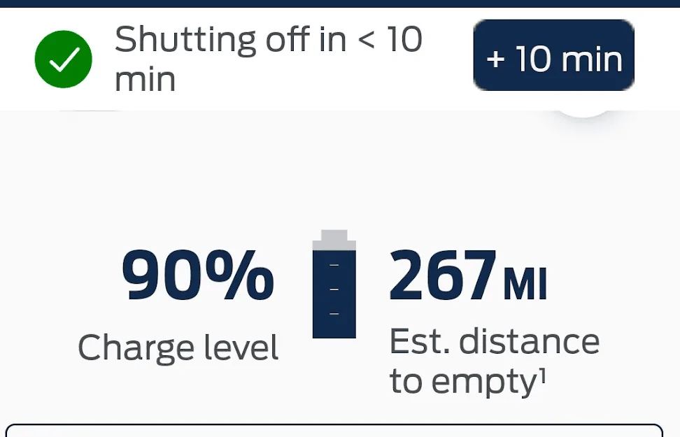

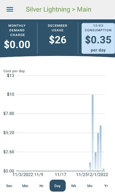

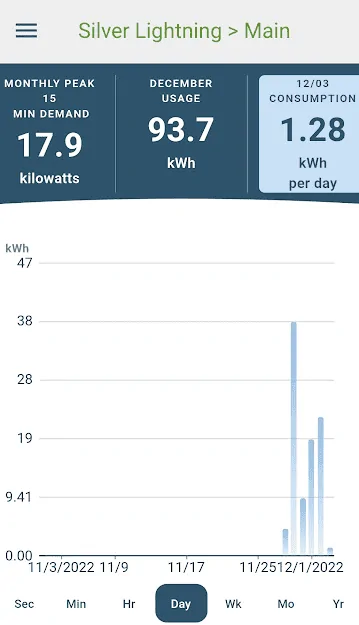

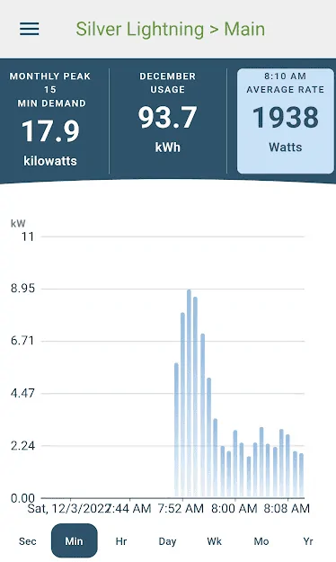

Saturday morning test, involved no pre-conditioning, just using remote start, ran it for 20 minutes with ambient temp of about 54º, last night my range was 270 @ 90% and it was much colder then compared to this morning..... yet still dropped 3 miles.
Ford F-150 Lightning Does anyone have Lightning cold weather preconditioning detail information? 1670080785203
Substantially different power consumption for a remote start compared to preconditioning, peak draw was just a hair under 9kw, it stepped down aggressively by the minute, by the eight minute it was hovering around 2kw until the 20 minute session was finished and truck shutdown. Note that during pre-conditioning the cabin heating continues to run past the target departure time. Only 1.28 kWh was consumed from shore power, in my market that's worth 35 cents.
Ford F-150 Lightning Does anyone have Lightning cold weather preconditioning detail information? 1670080419601
Ford F-150 Lightning Does anyone have Lightning cold weather preconditioning detail information? 1670080447135
Ford F-150 Lightning Does anyone have Lightning cold weather preconditioning detail information? 1670080482676
And most importantly, the steering wheel was warm.
I think I'll reserve "pre-conditioning" for battery health when it's really cold, otherwise remote start for 10 minutes should be sufficient in most cases.
