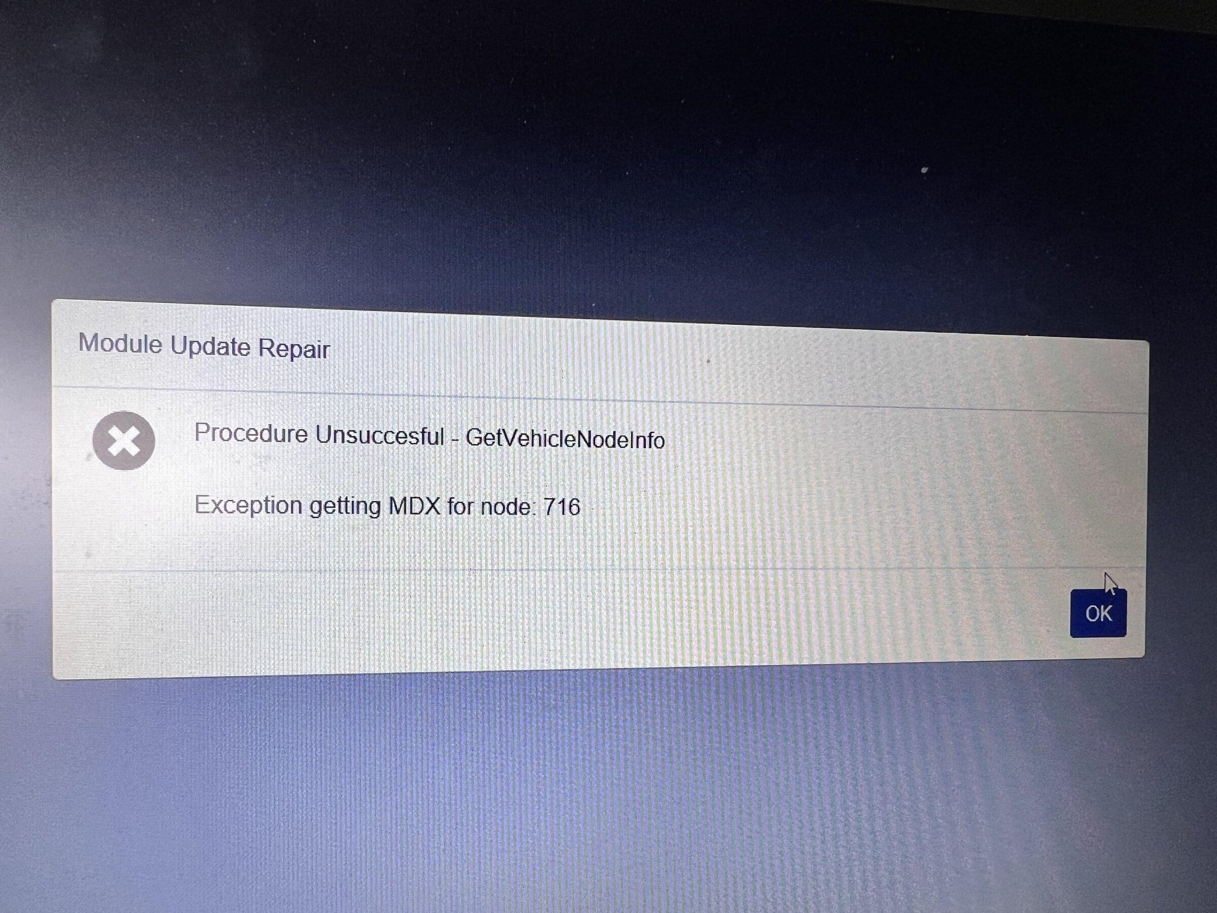

Whoskyle
Kyle
Jun 29, 2021
270
AZ
2021 F-150 XLT
Quick update for all, when trying to perform the TSB, I kept getting this error. Trying to figure out what is causing it. Jesse said Gateway, but no idea what to do next

Given the cost of the USB-A to USB-A cable and the USB Ethernet adapter, I think I may just buy them at some point to have them on-hand should I need them in the future. Could be $20 now to save me days of headaches down the road.

Try logging into FDRS with the flash drive in the USB port and running a self test on the APIM.
Tried this a couple times to no avail. Updated everything else except APIM. Adapters on order for TSB.
