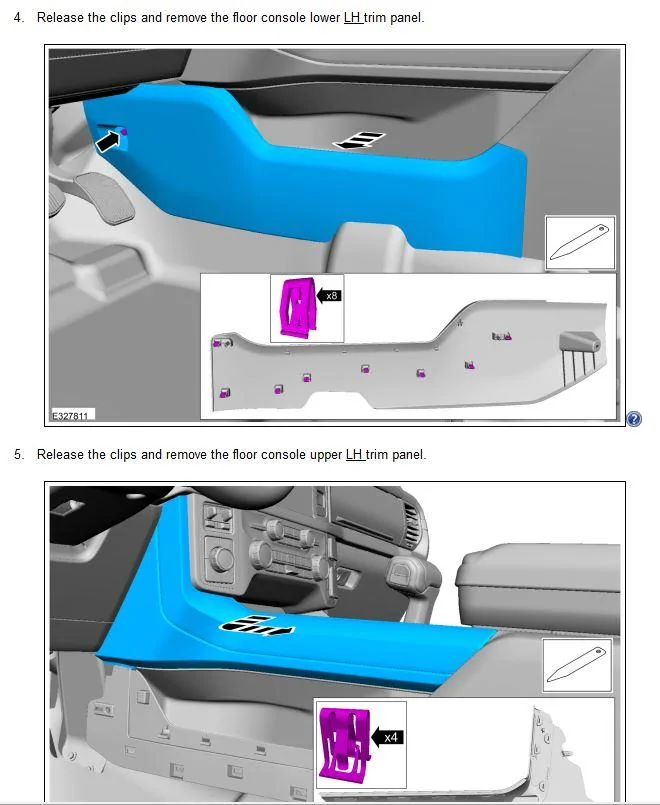

NOTICE: Ford has recently released a TSB 22-2117 that addresses the stuck APIM update issue cause by the failed 1.7.1 OTA. I am attaching this TSB to this post. Anyone willing to test it out ? Apparently, all you needs is FDRS, an USB mini adapter (something like this), an USB A to A male cable (something like this). If you already own an FDRS license, this is an additional $12 investment. Definitely worth a try.
You will need to access the APIM direct programming interface by removing the driver side floor console side panel (details are in TSB), connect the USB mini adapter to the exposed interface then connect the USB A to A male to the adapter and to your PC. You need to have your Mongoose VCI connected with FDRS running as well to execute the procedure described in the TSB
Iceman, I did the TSB today. Used the following parts:
https://www.amazon.com/dp/B015ORX70S?psc=1&ref=ppx_yo2_dt_b_product_details
https://www.amazon.com/dp/B009GUXG92?psc=1&ref=ppx_yo2_dt_b_product_details
https://www.amazon.com/TRENDnet-Eth...rendnet+usb+to+etherne,electronics,137&sr=1-4
You need those and the mongoose. When you follow the TSB it says to remove the lower console panel but you need to remove the upper as well (see my picture). When you do this in FDRS, it will use the mongoose to reprogram some stuff first. Then it has you turn the truck off and download drivers. When you do this, the file you download installs the driver installer but not the driver itself. Navigate to C:\program files (x86)\sync drivers installer to find the actual installers. There should be an install.bat file somewhere in that folder. Run that before continuing in FDRS. Once you do that follow the prompts. For my truck I needed to use both the USB male-male AND ethernet adapters to recover the truck. Side note, you CAN'T use one of those combined USB hubs with ethernet- the APIM will reject it with an error. Once it is done it does some type of configuration on the APIM which I had to retry once or twice. Once the procedure finally finished I had a sync version and the update buttons were no longer greyed out. From there I ran the USB APIM updates and have since gotten myself to 21281. Let me know if you have questions, this should help those driving around with USB sticks in their truck hoping they will update at some point...
https://www.amazon.com/TRENDnet-Ethernet-Network-Compatible-TU2-ET100/dp/B00007IFED/ref=sr_1_4?crid=3IP8B0TWFG2Q0&keywords=trendnet+usb+to+ethernet&qid=1648443868&s=electronics&sprefix=trendnet+usb+to+etherne,electronics,137&sr=1-4
How long did the TSB take to do?
