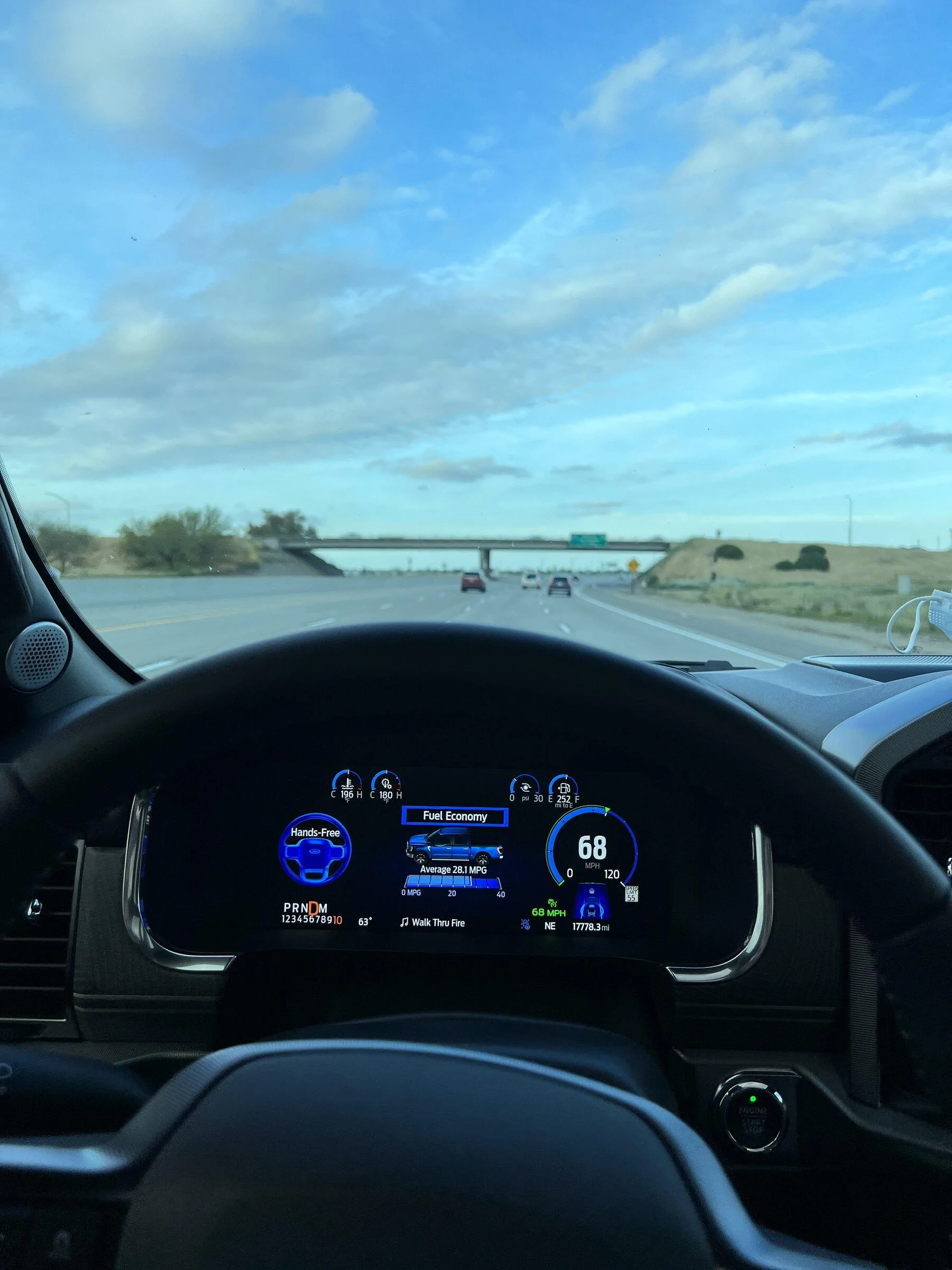

Anyone else notice that after all the updates are done, that the green arrows for your blinkers are in a different spot? Other than that, BS seems to be working pretty good on the highway from my commute! Hands free and 28 on the highway ?
Yeah mine moved, don't think I'm a fan of them in the far corners honestly.
