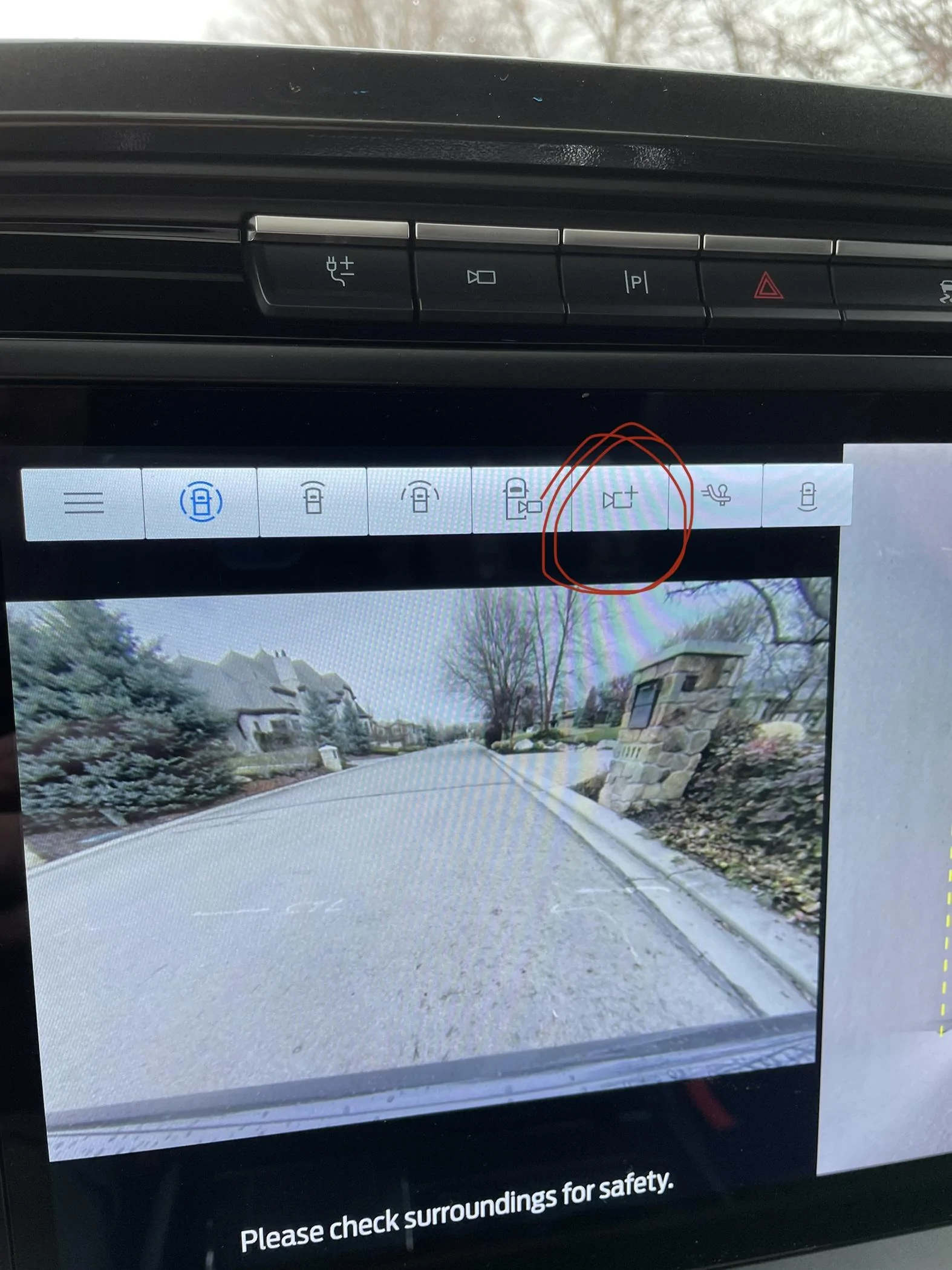

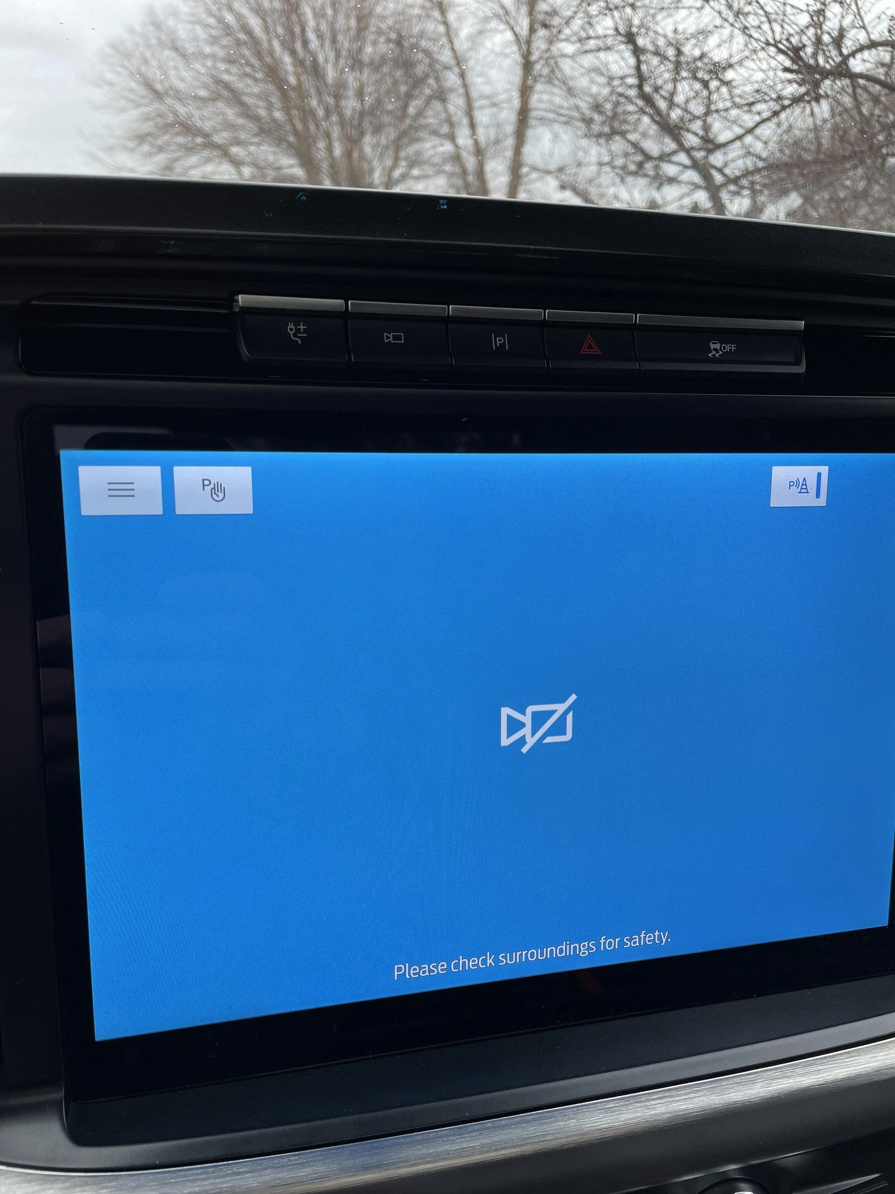

Anyone getting this “add camera” icon? Trailer camera maybe?
Yes this is for the trailer camera option in Ford Accessories. Only thing is you may need to check your rear trailer connector to see if it has all the wires populated as a lot of the Job 1 and some Job 2 trucks only had 2 wires populated. If you only have the two wires in the connector then the rear harness needs to be replaced which is around $100.

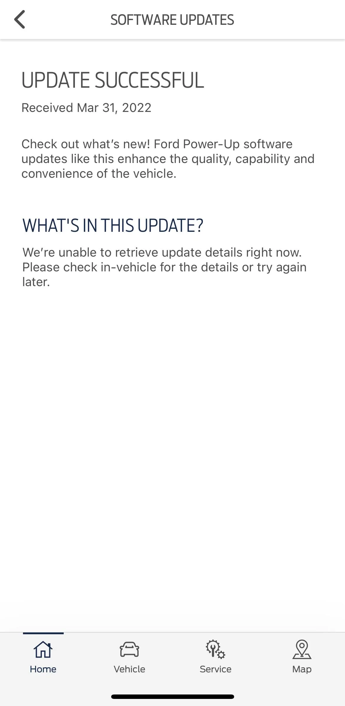

My OTAs are back online now that I’ve fully updated 2 weeks or so ago to BC and latest APIM.
Uncertain on any changes.
Went out to truck, and it said update successful. Details: digital owners manual.
Note: I’ve always had the digital owners manual option in the display.

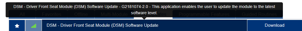

Anyone seeing a new DSM update?
Not sure what it entails, but not wanting to go through the whole running boards not working again situation.
I did it last night. My running boards are fine.
