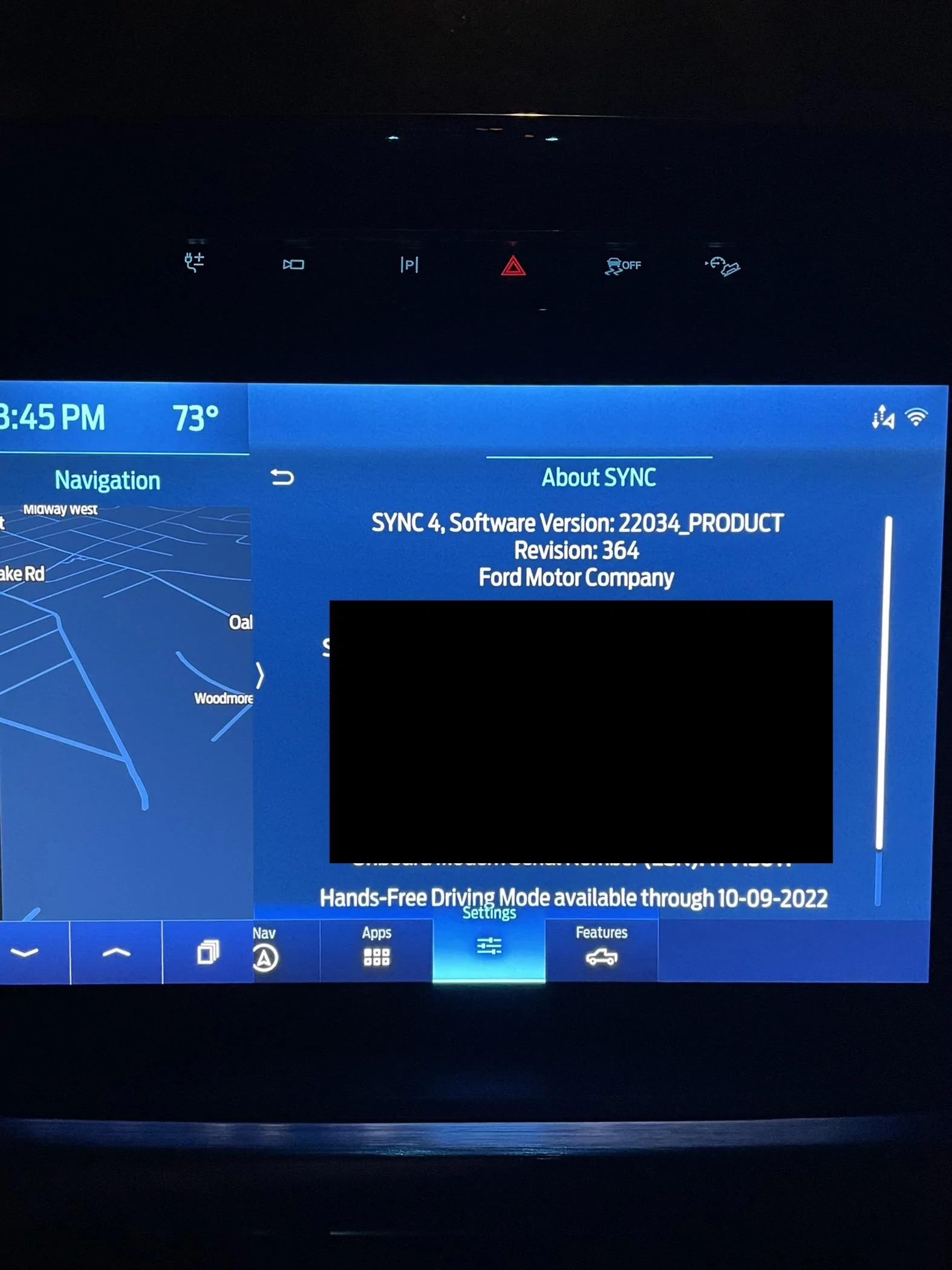

Hello F-150 Friends,
For those of you that updated the APIM and broke free of the software updates; has anyone seen the sync screen change to where you don’t have any access to the menu buttons on the bottom? This happened after I got blue cruise activated. I’ve completed a hard rest of the APIM and nothing changes.
I think if it sits over night it make correct itself.
Did this happen right after the update, or is it a hit and miss
