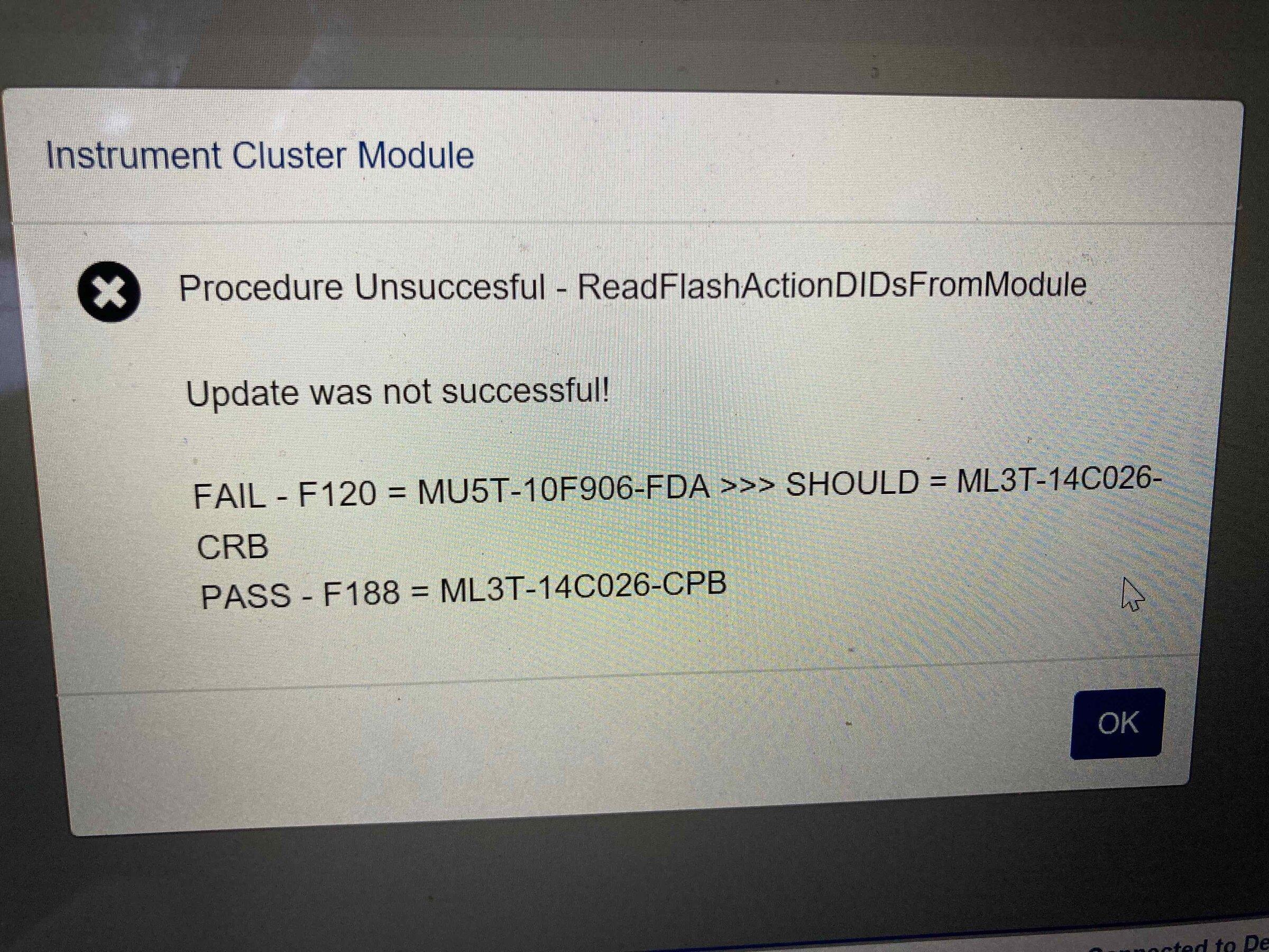

I finally had a chance to spend the day yesterday with a Mongoose and FDRS license. I have a 2021 job 1 and was hoping to finally get BlueCruise.
I had about 15 updates to install. There was no APIM update listed. All of the updates installed successfully with the exception of a GSM update that won't seem to go away and my Instrument Cluster Module. It gave me the attached error and then the update disappeared from my list. My sync version is still revision 244.
I saw a previous poster had a very similar issue a couple weeks ago and reported it solved, but I'm not sure what the resolution was. Any ideas on how to keep moving my updates forward? Thank you!!
VIN: 1FTFW1ED0MFA94376
Good morning! Could you please send us a private message with your VIN and dealership information? I would like to look into these update concerns for you on my end. Thanks!

Dec 13, 2021
2021 F-150 Limited
Manufacturing (ODM)
SSM 50671 - FDRS ALERT - 2021 F-150 - Instrument Panel Cluster (IPC) Programming Failures
Some 2021 F-150 vehicles may experience an Instrument Panel Cluster (IPC) programming failure during Programmable Module Installation (PMI) and/or Software Update with the Ford Diagnosis and Repair System (FDRS) which states either The Module Configuration Has Failed, Would You Like To Retry? or Procedure Unsuccessful- RestoreDE0x_Range Exception Writing Configuration To Module. This may be due to the gateway module (GWM), accessory protocol interface module (APIM) and/or telematics control unit (TCU) not being at the correct software level to support an IPC software update. Perform all available software updates for the GWM, APIMand/or TCU. When these software updates are complete, continue with PMI and/or software update of the IPC.

FordConvert
Craig
Aug 11, 2021
54
Utah
2021 F-150 Lariat PB 502A
Builder
I got the same thing. Overnight "nap" cured it for me. Nothing else worked including a 3 hour nap, reconnecting/disconnecting, rebooting, etc.
I tried it again after a couple days and it worked. Truck needs a nap sometimes like I do, I guess.
