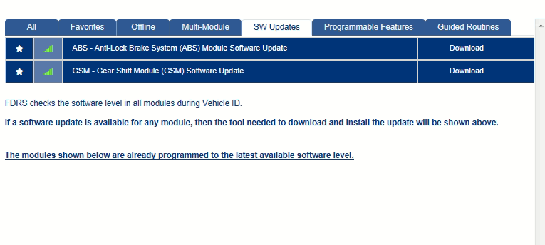

A PCM update came available for all Power Boost today
Jesse, thanks for that. I've updated the PCM this morning, took about 5 mins.
Any tips on getting the pesky GSM to clear? I've done it like three times now.
No, nothing you can do about it.

For anyone esle that is not a Power Boost there should be an ABS update available for you

Any intel on what the ABS update helps with or enhances?

Yep see the ABS update today. Have a modified ABS value (enabled rock crawl mode on non-FX4) so I guess I better undo :unsure:

Just finished the ASB update. 501A with Copilot 360 Assist.
Software P/N
Before: ML34-2D053-AJ
After: NL43-2D053-CA
I had a DTC in my IMPA for not communicating to the ASB module after the update. Cleared it and it hasn't returned yet.
No idea if it fixed or update anything.

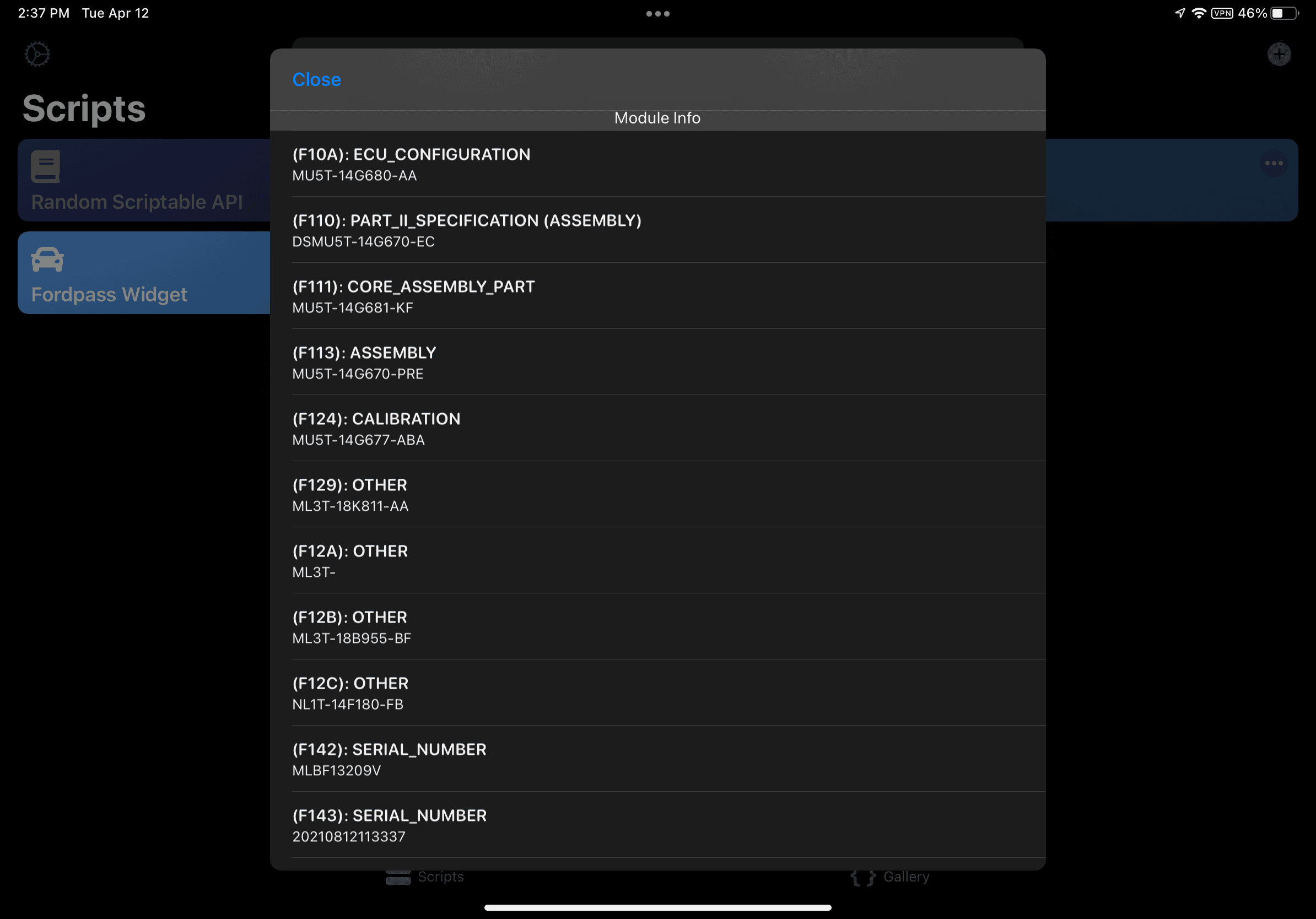

@Jesse-Infotainment , is this normal on the APIM? The ML3T- under (F12A). This is a job2 and it’s never had an APIM Update, so not related to an update. Just curious if others see the same thing; Seems odd.
Mine also shows this. I have a BC enabled Job1 2021
m seems to report in a few odd ways .. not sure why but it does even in fdrs
