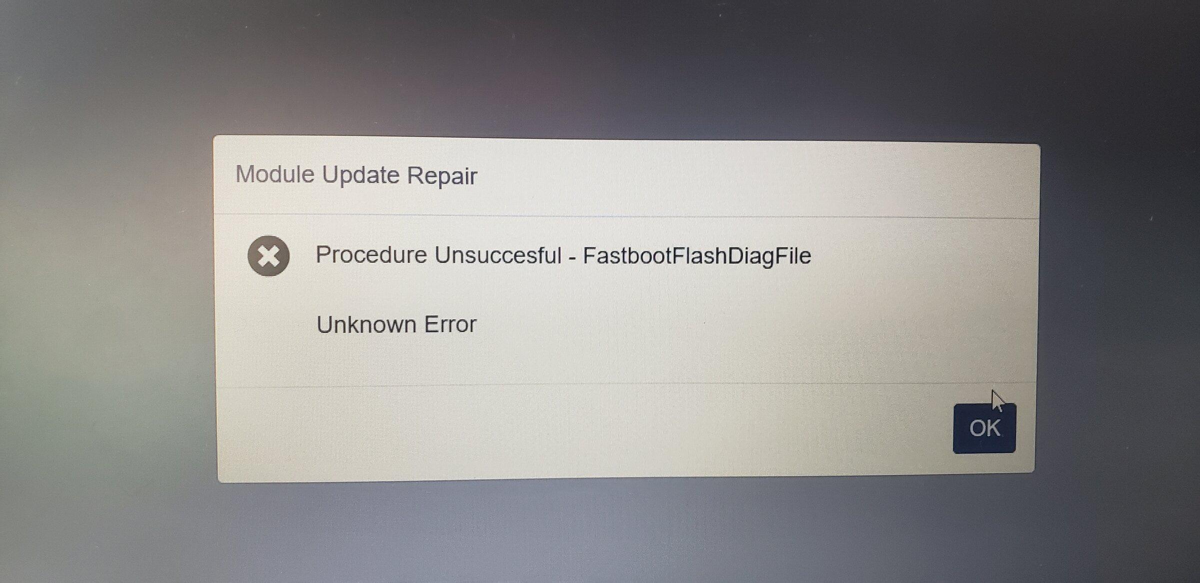

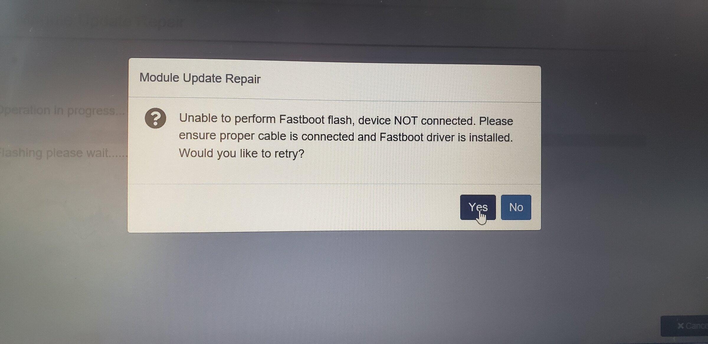

no, cant get past the fastboot issue. something wrong with drivers or something? maybe an old laptop?

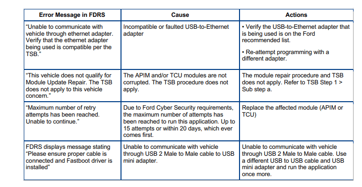

Hey Steve - The table below shows the various error messages and actions on page 18 of the TSB. I think your error is the last one.
