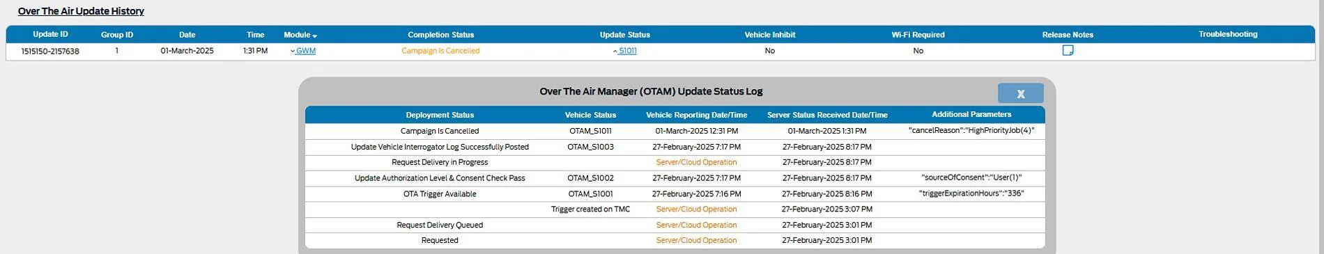

Also, I just logged into Ford Service Info and see that the same GWM update I'm attempting has started OTA on 2/27/25. It shows Update Status VIL Generation.
When I look at the Software Updates screen on the truck's screen, it shows the GWM Update with status Not Completed.
Would the truck inhibit USB updates while it has an OTA update in progress?

@Kansan The OTA for the GWM was canceled on the server side, so it will not come in OTA. The OTA was sent to your truck on 2/27, the truck pinged the server back, but the files were never downloaded and the OTA was canceled due to "high priority job" (whatever that means).

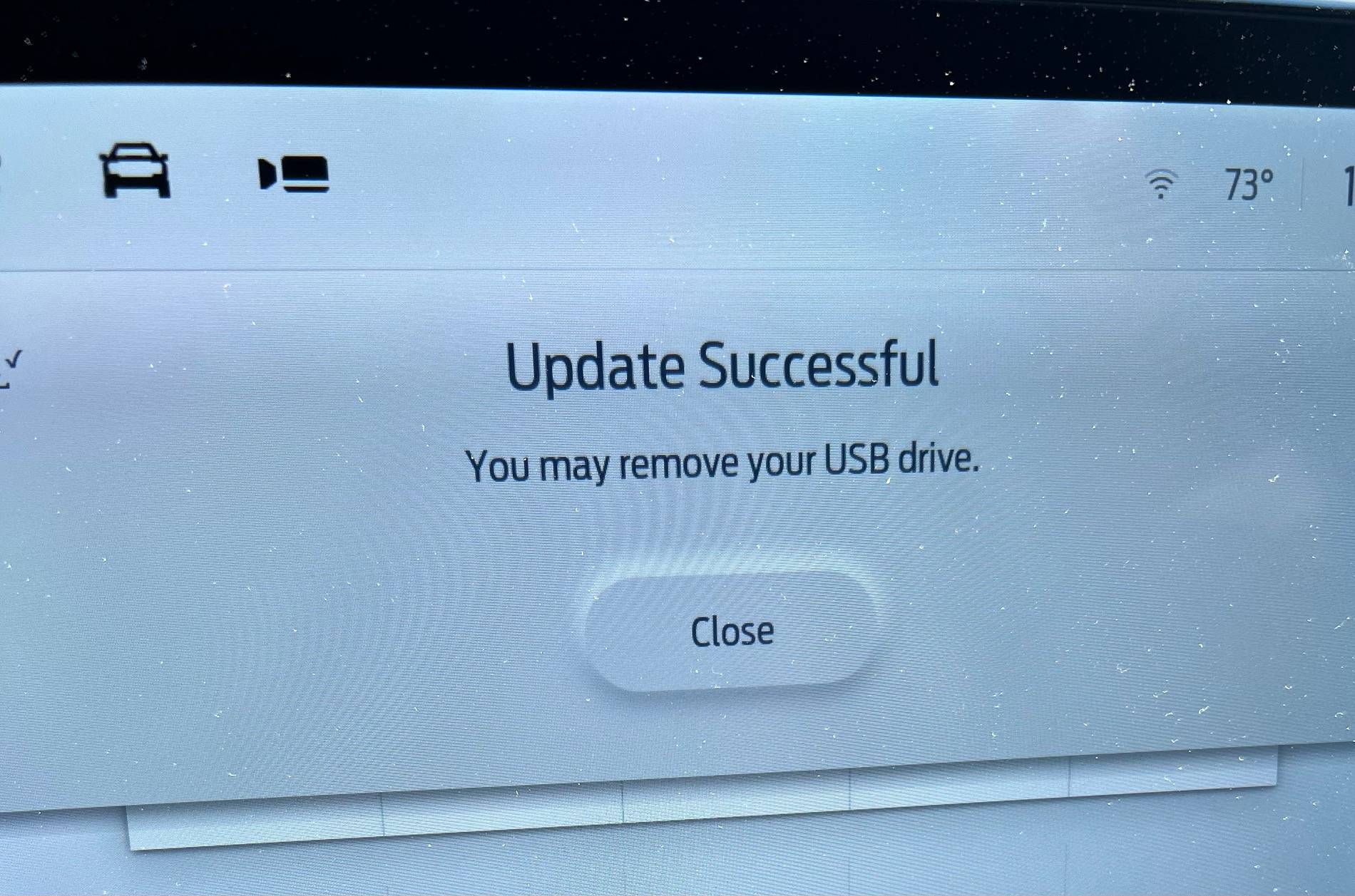

The USB update should say "USB Indexing" on the top left of the screen within a minute of you inserting it. For the update to actually kick off, it can take 2-15 minutes before the message saying "USB update in progress" pops up on the screen.

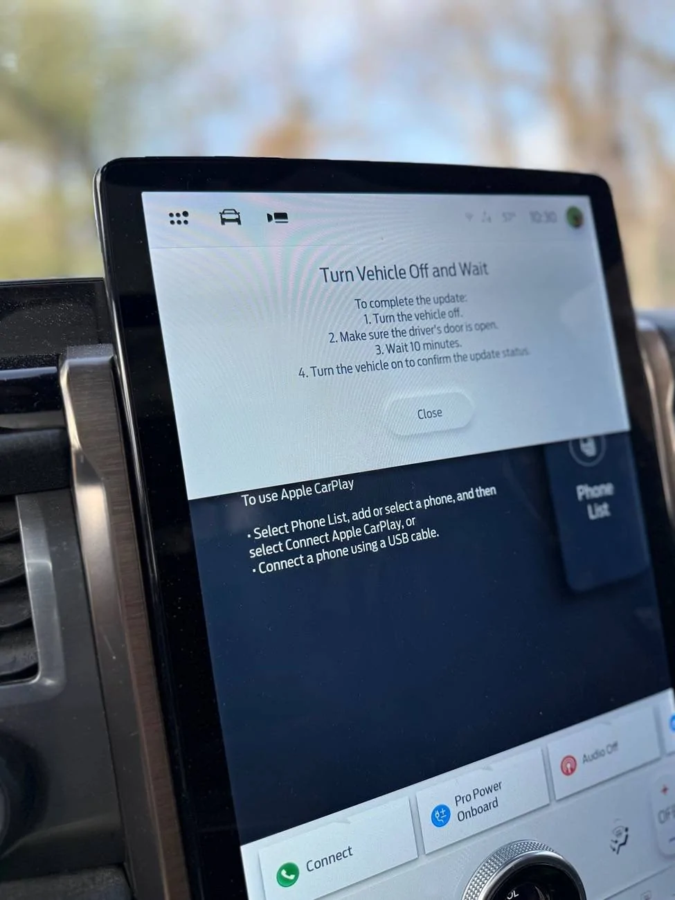

After rebooting the GWM, the usb was recognized right away and programmed in just a few minutes.
Thank you for your help!

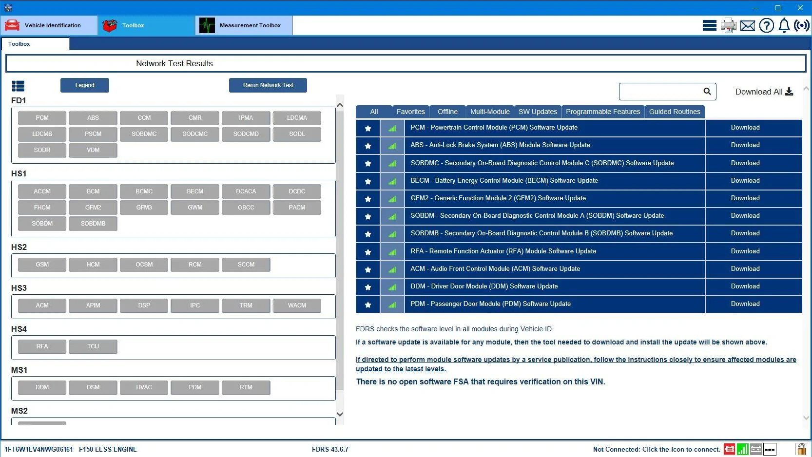

2 Mar 25 and there's a complete set of powertrain updates out for my '22 Lariat ER today. I was holding off updating the door modules that came out last week until something more substantive came along. I guess this is it. :)
Ford F-150 Lightning Lightning Software Updates using FDRS Lightning_Powertrain_2-Mar-25
I checked two '23 models and they don't have these updates.
I checked two '24 models but they do have them.
Maybe they're still working on the validation for the '23 model versions (that's happened before with other updates).

I installed all of these updates this morning . Very quick for so many updates at just under a half hour , so you will be staying in your vehicle during the process . No issues but the updates draw a lot of amps. I attempted to the updates out of order by clicking the BECM update first which then failed . I started again from the ABS update and they all installed in order without issue . Afterwards, I tried to run the RFA and ACM updates again to get them to clear and of course they did not clear . Will see if my quarter mile time improves after the update.
