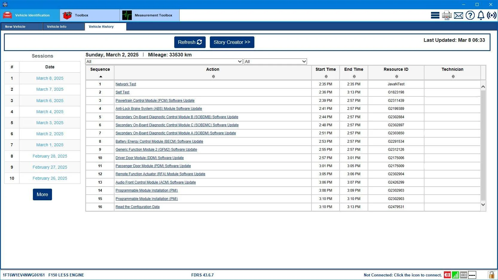

Ford F-150 Lightning Lightning Software Updates using FDRS Lightning_Powertrain_2-Mar-25FollowU
The powertrain script started at 2:39 when I selected the PCM and hit "Run". Right side column is how long each module took according to FDRS.
PCM
2:39​
0:02​
ABS
2:41​
0:03​
SOBDMB
2:44​
0:04​
SOBDMC
2:48​
0:03​
SOBDM
2:51​
0:02​
BECM
2:53​
0:02​
GFM2
2:55​
0:02​
Powertrain scripted update end
2:57​
Total time for all powertrain module updates was 18 minutes.
Both door modules took 4 minutes each.

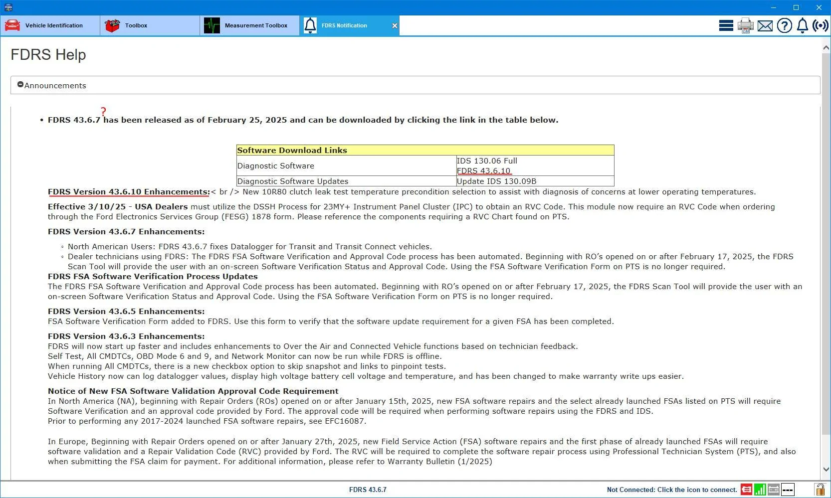

FDRS 43.6.10 is out this morning. The info page is still a work in progress though apparently.
Ford F-150 Lightning Lightning Software Updates using FDRS FDRS_43-6-10_Announce

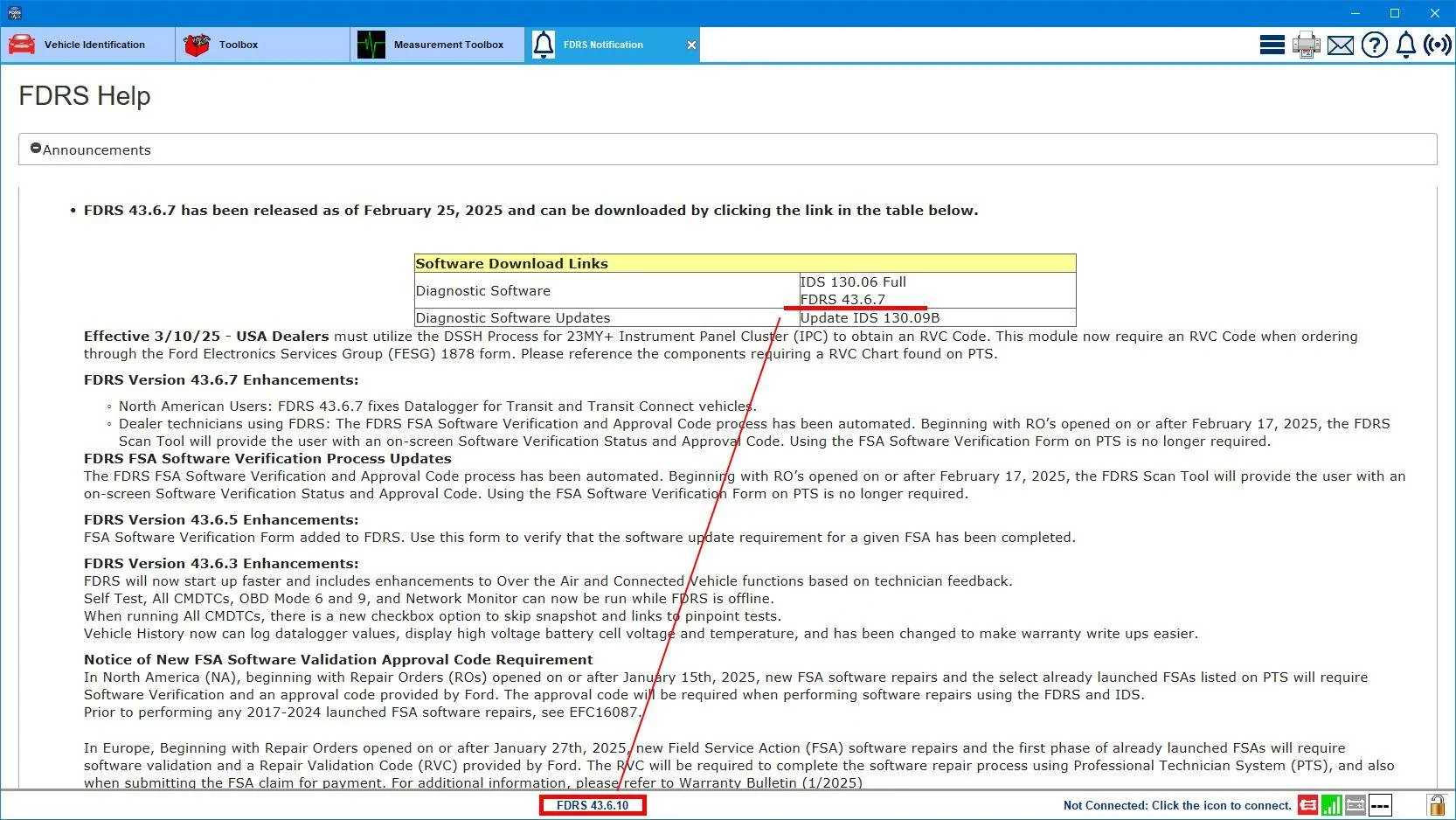

Or maybe not? Actually? Not sure?
I guess somebody is rethinking the whole "Do I send out this update or not" thing....cause after I installed 43.6.10 the help screen reverted to showing 43.6.7 as the latest revision. I know it's not April 1st yet...but....
Ford F-150 Lightning Lightning Software Updates using FDRS FDRS_43-6-10_Announce_or_maybe_not
I'm gonna stick with the 43.6.10 I just installed to see what happens 🤓
