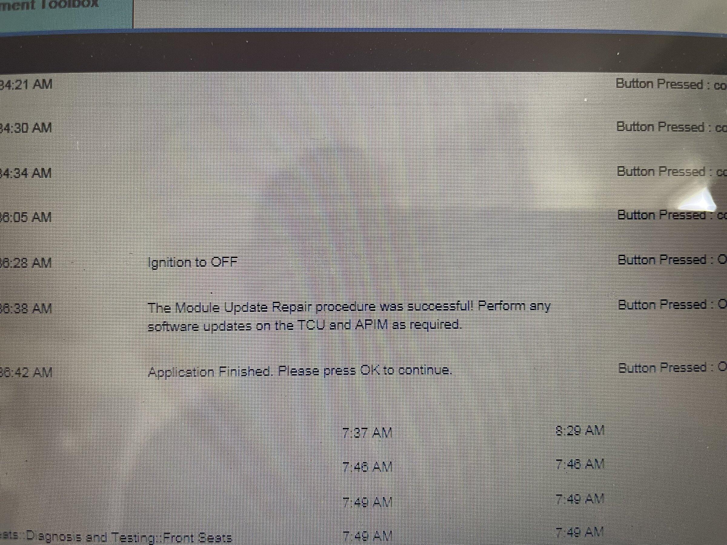

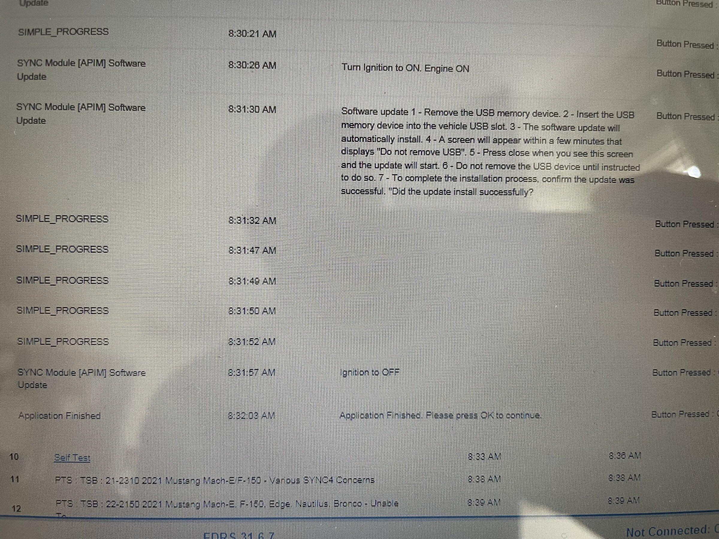

Woohooo the dealer actually fixed my stuck truck!!! I didnt think they would. The managed to run the Module Repair and got the APIM to update!! Cant wait yo get it back next week to run the rest of the updates. Have a GWM IPC and PCM update waiting for me.
So I'm guessing that by mutual agreement between you and the service department the original intent was to just fix the stuck APIM and then you'd take it back to do the rest of the 21G01 updates? Is that it?
i asked them to get me to the Blue Cruise level but they said they cant being that its not officially available to everyone yet. I guess only people in the early access program. So they are just getting me unstuck, so ill be doing the rest of the updates on my own once i get it back. Waiting for them to get a part in for the drivers seat lumbar next week and then i should have my truck back.
Well clearly there's a gross misunderstanding on their part.
In addition they haven't read the instructions for 21G01 that tells them how to do it and were published at the end of last month.
I had to school my service department cause they thought the same thing and kept telling me the "BlueCruise" update files weren't on the server for download. (Well I guess they aren't if you're only looking for something labelled "BlueCruise Update").
And it is *officially available* to everyone who purchased a 21 Job 1 Mach-E or F-150 with the Ford Co-Pilot360™ Active 2.0 Prep Package.
That Early Access Program only applies to Over The Air updates, not to techs who are getting paid under program 21G01 to do it using FDRS at the dealerships.
Wow. Unbelievable this sort of nonsense is still going on.

Yea they seem clueless. Im just happy to be unstuck. When i spoke to them dropping my truck off their response to the Blue Cruise was… we dont have “Blues Cruise” yet. … as if this is what I was asking for ?
