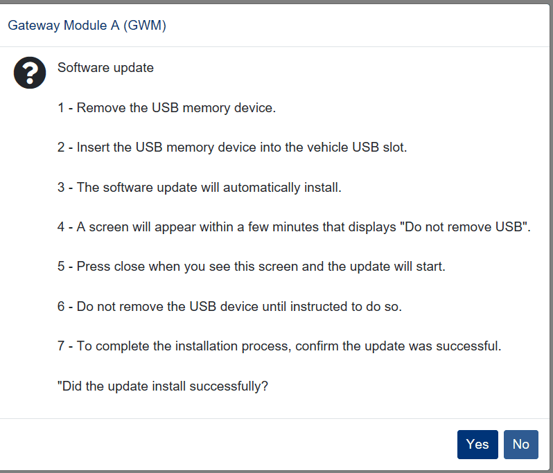

quick question. When doing the USB GWM update, Do you leave this page open until a success update after restart?
Yep, I left it open, and clicked Yes once I got an "Update Successful" message on my Sync screen

@iceman77 how long for the APIM update? Still waiting after almost 2 hours with the truck running... :(
APIM update should not take longer that 15-20 minutes from the point when it instructs you to "Not Remove the USB Drive" on your Sync screen. You should get this prompt minutes after inserting the USB drive into the truck's media hub. Once update is installed, you should be presented with "Restart Required" message. If you haven't received the prompt on your Sync screen, your APIM update did not kick off and there is no point waiting. It is possible your APIM is the "limbo" mode after failed 1.7.1 OTA just like many users on this thread experienced.
