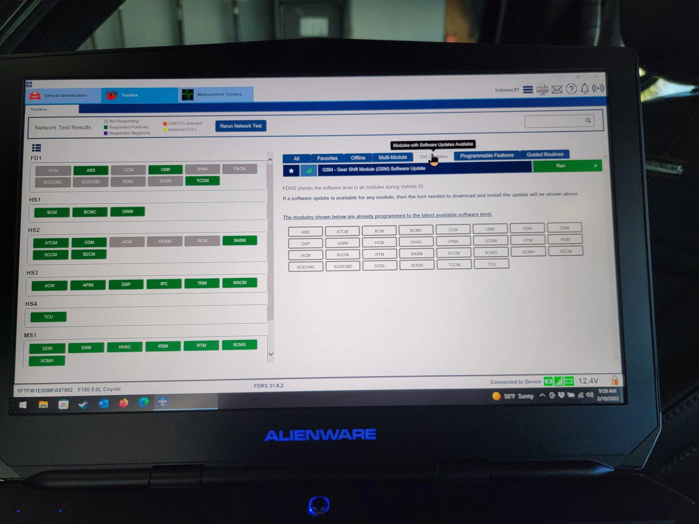

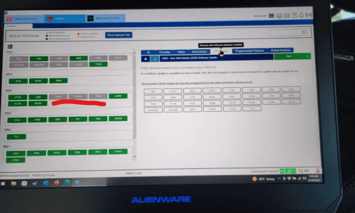

Anyone know why sometimes not all modules show green? I can run a network scan and the green boxes change almost every time. This isn't my FDRS, but same idea. I usually only have 4-5 boxes green at a time.
Ford F-150 Lightning ECU module programming guide using FDRS 1645291367653

Is your truck in the key on (no start/engine off) position?
Some modules need power to show up.

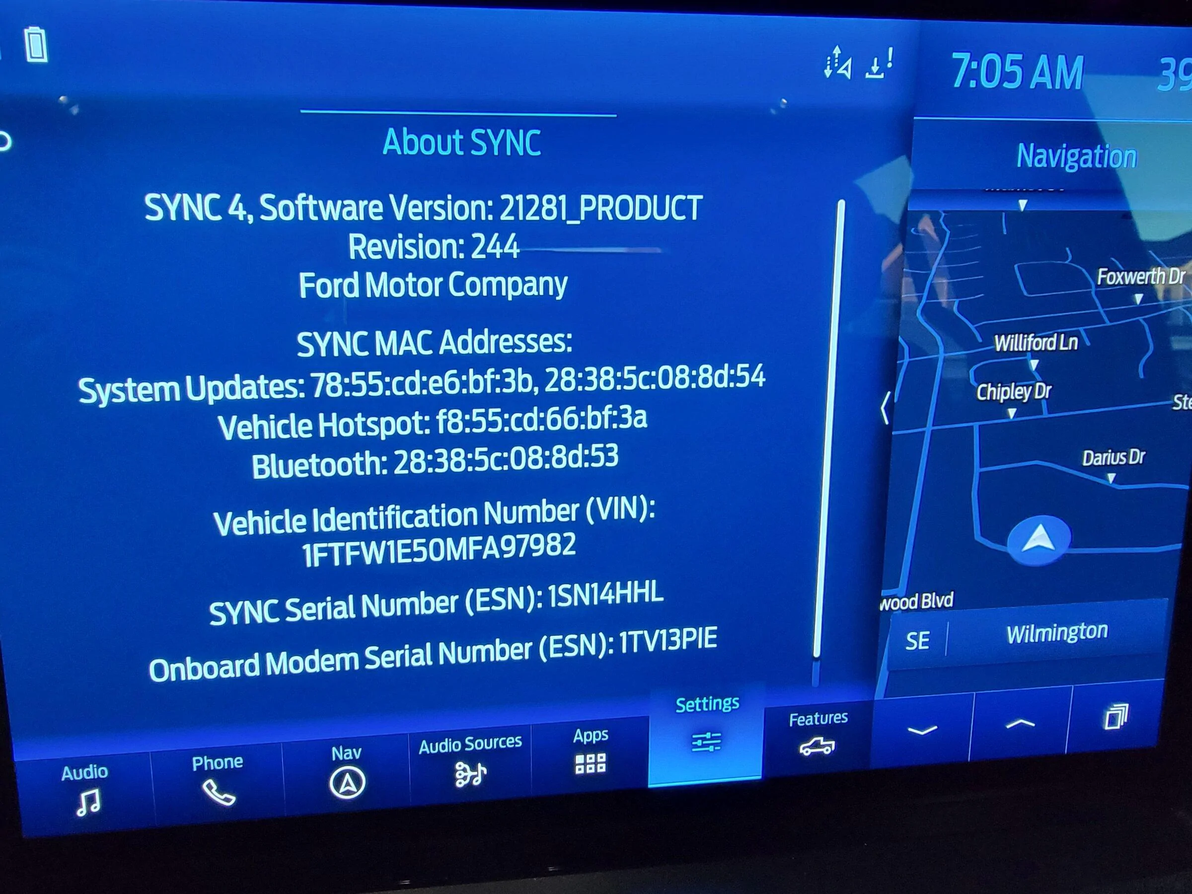

I told the service dept. on Thursday that despite them ordering a new APIM, I would get the module updated.... can't wait to see what they have to say. Gonna shove this down the tech's throat come Monday:
What sync version were you coming from? I'm just curious as if anyone from 20312_PRODUCT Rev 243 has had success. I'm stuck on the dang APIM update.
I had the prior one 21146_PRODUCT Revision 145. Suggestion, make sure your GWM is updated first, then disconnect your battery for approx. 15mins and leave the memory stick in the USB slot. Reconnect battery and charger/maintainer and you should see the update start again with the popup about "Do Not Remove USB", close it and the update should start again. Don't worry what FDRS shows... let me know if this helps
Im in the same boat as you 20312/243. No updates and USB update not taking. Got a Platinum Powerboost. Been trying for 2 weeks now to get the usb update to go without any success. Had one small GWM update with FDRS but it didn’t help.
