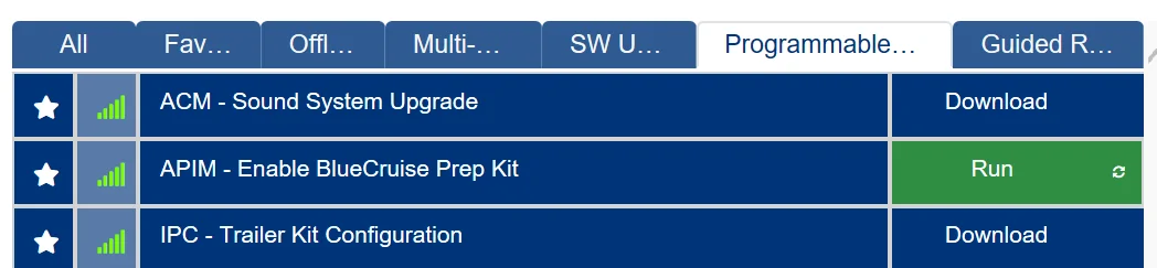

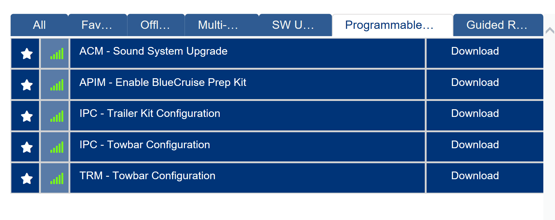

So I was tinkering around in FDRS, has this always been there? APIM - Enable Blue Cruise Prep Kit?
I didn't look for it so I don't know if it was there
As for the restart loop, I'm still the only one who got out of it by removing the USB stick AFTER shutting the truck down. Upon restarting the truck I got the "system updated" or "update successfull"... I can't remember which.
It was the APIM restart loop and I'm not exactly recommending anyone to do the same, but at the time I had tried everything else documented to get out of the loop and felt like I had nothing to lose.
i sure as shit don’t remember seeing that

I can confirm I also have the APIM enable Blue cruise now showing in fdrs. This was not available on Sunday. @Jesse-Infotainment would you happen to have any info on this. Would love to plug in to my truck and run it but I dont have the time until next week. Especially if it can take as much as 2-8 hours to run
I dont. They had something similar a month or so ago. It must be real this time. I will dig to see what I can find in regards to this.

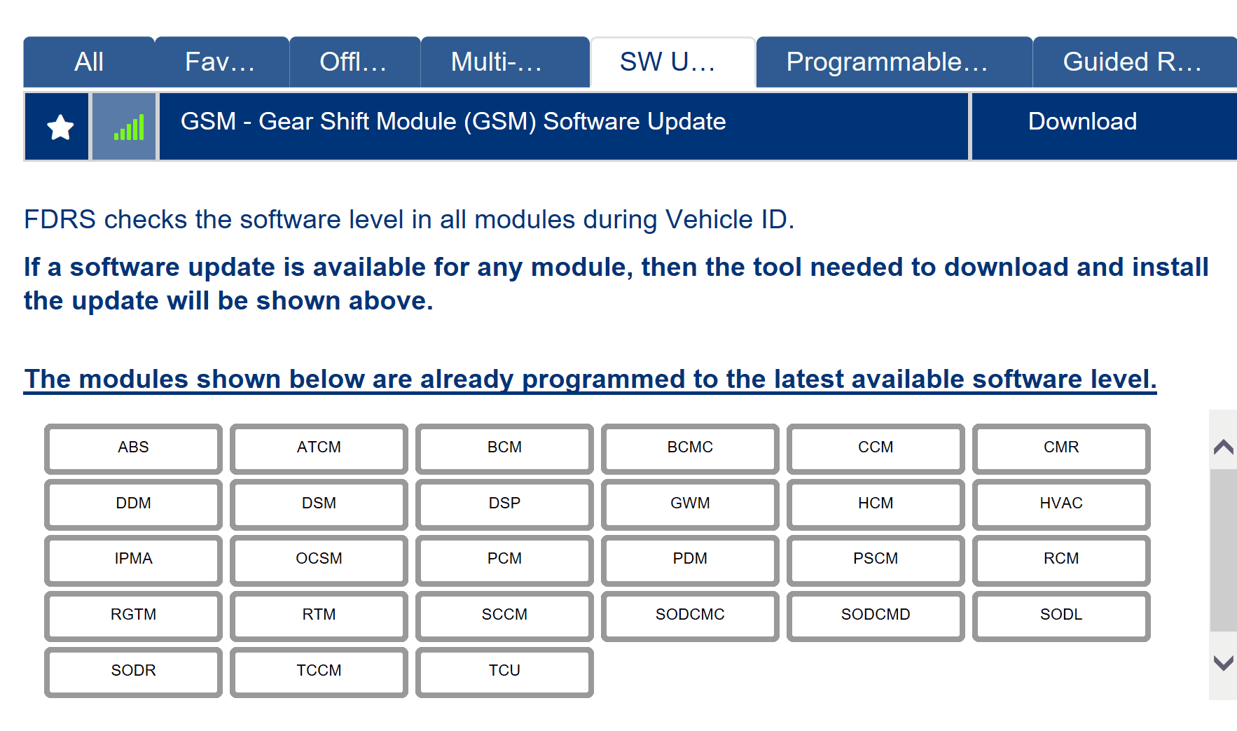

Has anyone checked to see if there are any new updates available in FRDS today?
If anyone checking on the daily feels like helping me keep an eye out here is my VIN 1FTFW1E80MFA24380.
I'm hoping the IPC is available soon :|
I have checked your VIN in FDRS. You don't have any outstanding updates, only GSM is showing up:

but, in the Programable Features, you have a new Options for "Enable BlueCruise Prep Kit":
