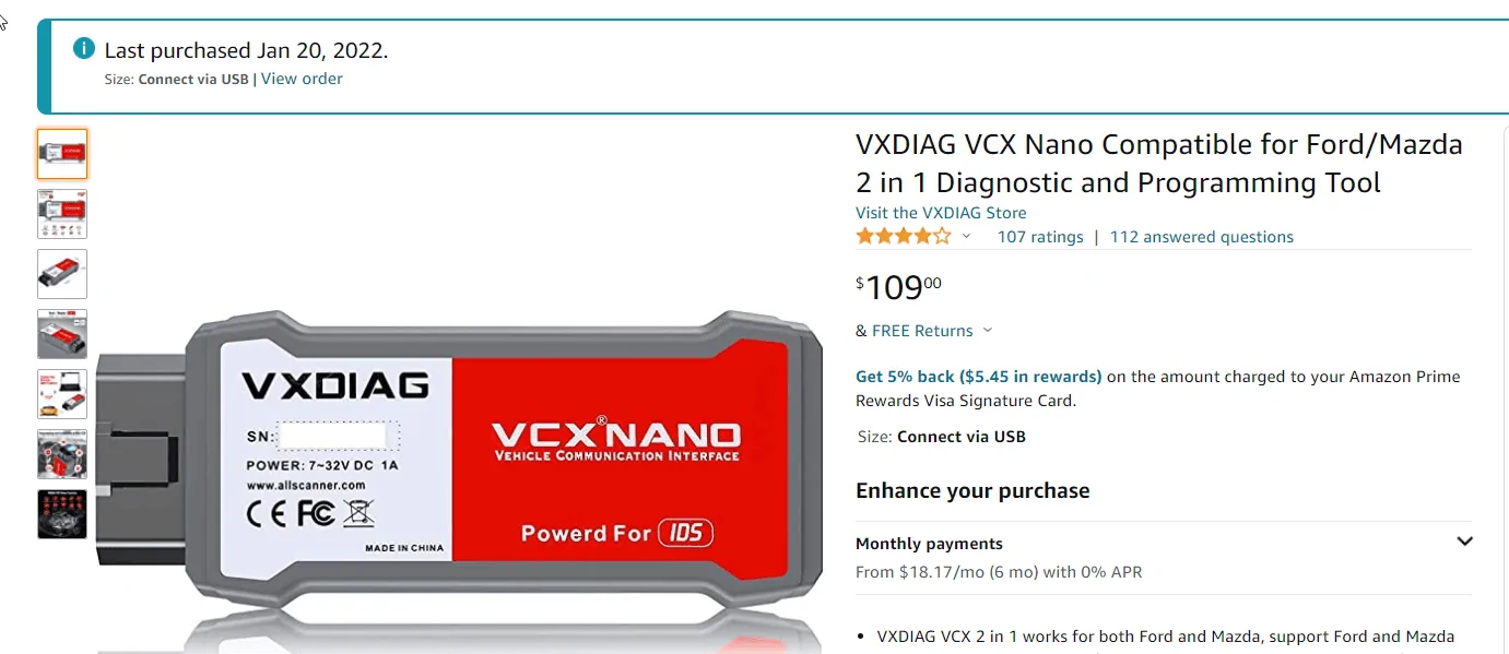

Anyone looking to buy a VCX Nano?
I'm selling mine for $85 shipped USPS priority to anyone in the US. I've had good results with it Going to upgrade to the Mongoose since I plan on doing more than the occasional update. PM me with any questions.
