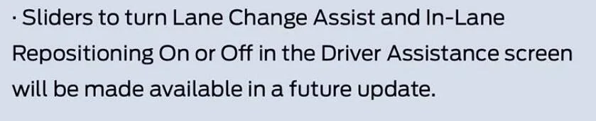

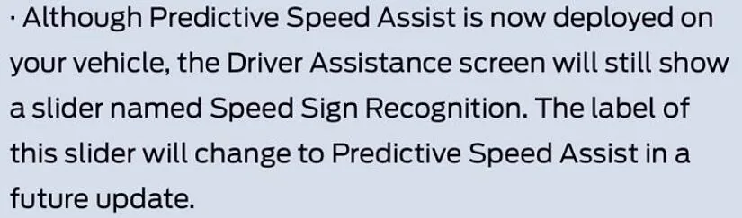

The release notes that were posted on the OTA BC 1.4 thread indicated that you now had all the functionality (Lane Change Assist, In-lane Positioning, better engagement, better in-lane stability). Then the notes said this:

So like Walk-away lock you get the functions pre-enabled but no way to disable.
Completely different experience than those doing this via dealer updates/FDRS/FORScan.

They do, but they don't have the toggles to turn it off if you don't want to use it. Same thing with the Mach E 1.3 OTA. Lane change etc works, but you don't have buttons without FORScan.
