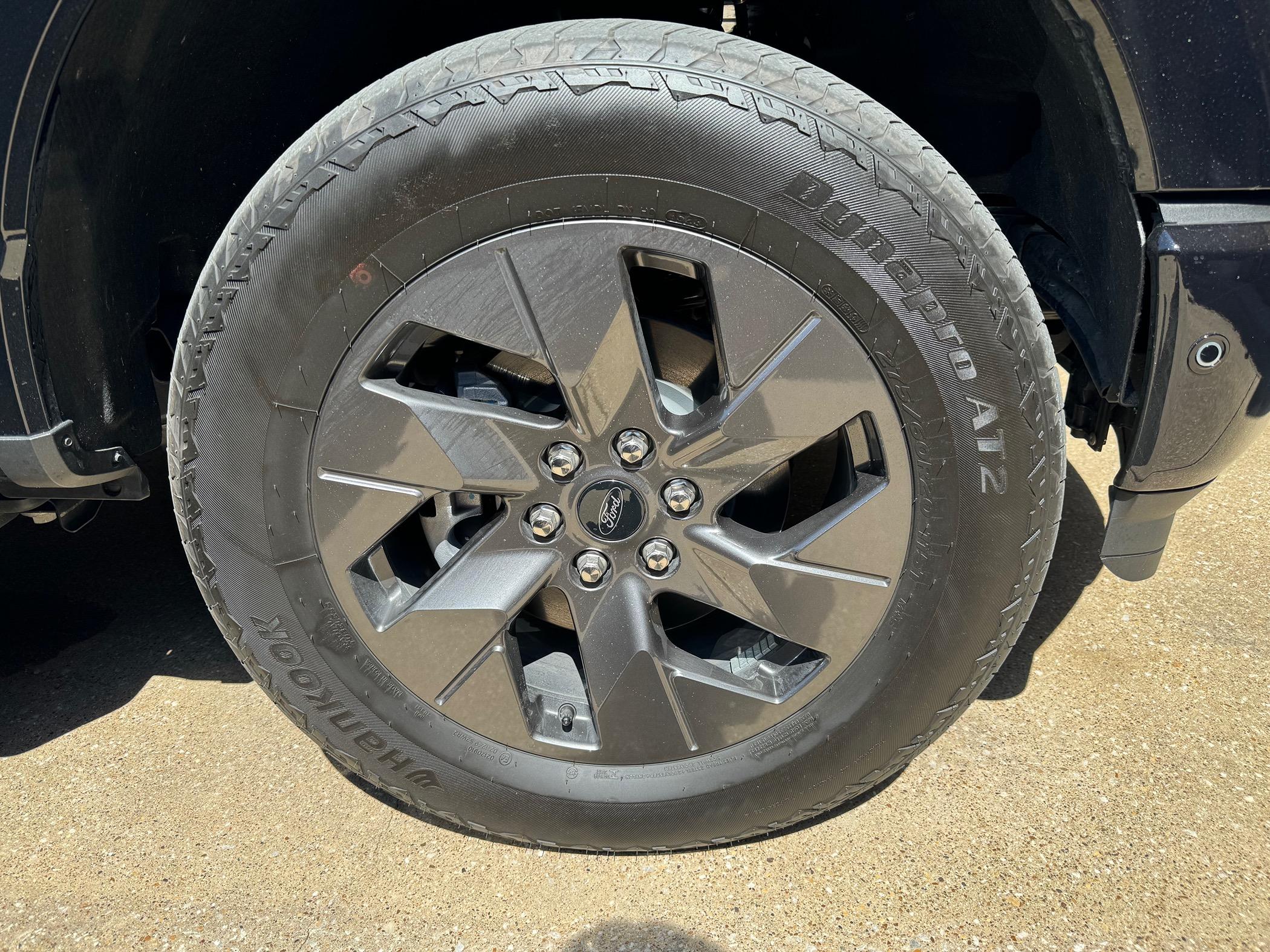

36psi is spare tire, 42psi is your normal tires. In any case, your truck sounds fine, the temps and wind are your issue most likely. I assume those tires are also stock size too.
This is reality for us, it's a brick and a amazing m/kwh posting is misleading from most experience and pretty much ever review I've seen.

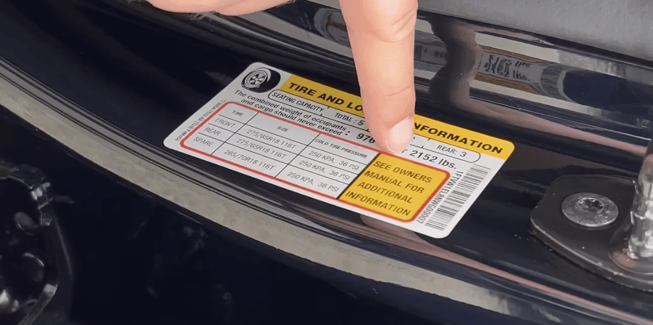

Nope. Look on the door tag of a truck with AT tires.

Tires should be inflated to the recommended level. 44 cold for a 36psi recommendation is 22% too high. AT tires from the factory are 36. Non-AT are 42.
I'm not trying to start an argument - I'm genuinely curious if my understanding is incorrect...
I know extreme over/under-inflation can cause uneven wear, but apart from the extremes it was always my understanding that lower pressure gives a softer ride, and higher pressure gives more efficiency (harder tire -> less rolling resistance). So you just need to find your personal preference in the tradeoff. I don't give too much consideration to the door sticker recommendation because that value is designed to maximize softness for stock tires. My rule of thumb has always been to inflate somewhere about halfway between door sticker recommendation and max PSI printed on the tire. (Unless max is something like 80 PSI, in which case I don't do the halfway rule.)
Change my mind.
