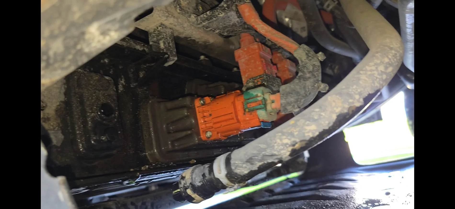

Looks like the exact same thing that happened to me. As I said in the thread, my dealership said it's possible that the pack would need replaced, but I was fortunate and it didn't. This guy apparently wasn't as fortunate. I went out and took a quick (bad and out of focus) pic of my skid plate where that gap is and you can see where much of the paint has been worn off by debris and can also see both the HV and coolant connectors in the gap.
Wow, thanks for the shot... so have you (or others) figured out a skidplate or other solution for this? Wonder if Ford is aware of this Achilles heel... :(
Thanks again for posting this

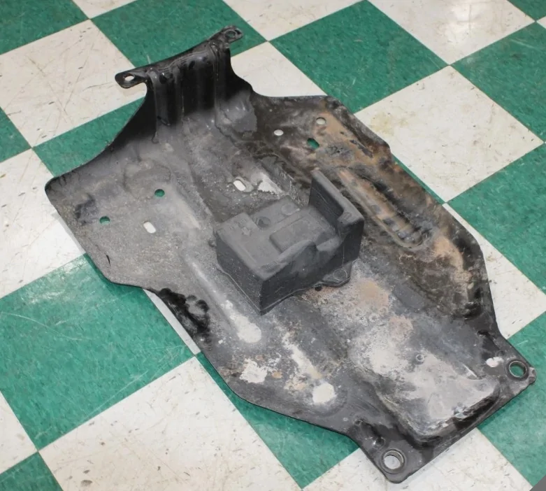

I just bought a front skid plate from a Raptor on market place. I hope to get some time soon to work on fitting that and also figuring what I'm going to do for the gap. My initial thoughts were to tack on some expanded metal to the plate to cover the opening but still allow drainage.
Please keep me posted on your efforts, both mods interest me greatly!
There is also 'perf' metal, where it's stamped sheet rather than expanded, and that stuff is quite a bit stronger, like this; https://www.ebay.com/itm/2050712324...fOJLqfuwLc3YjYQxnQ2kqmTqLw==|tkp:BFBMmv2n6_pk just fyi. GL!
