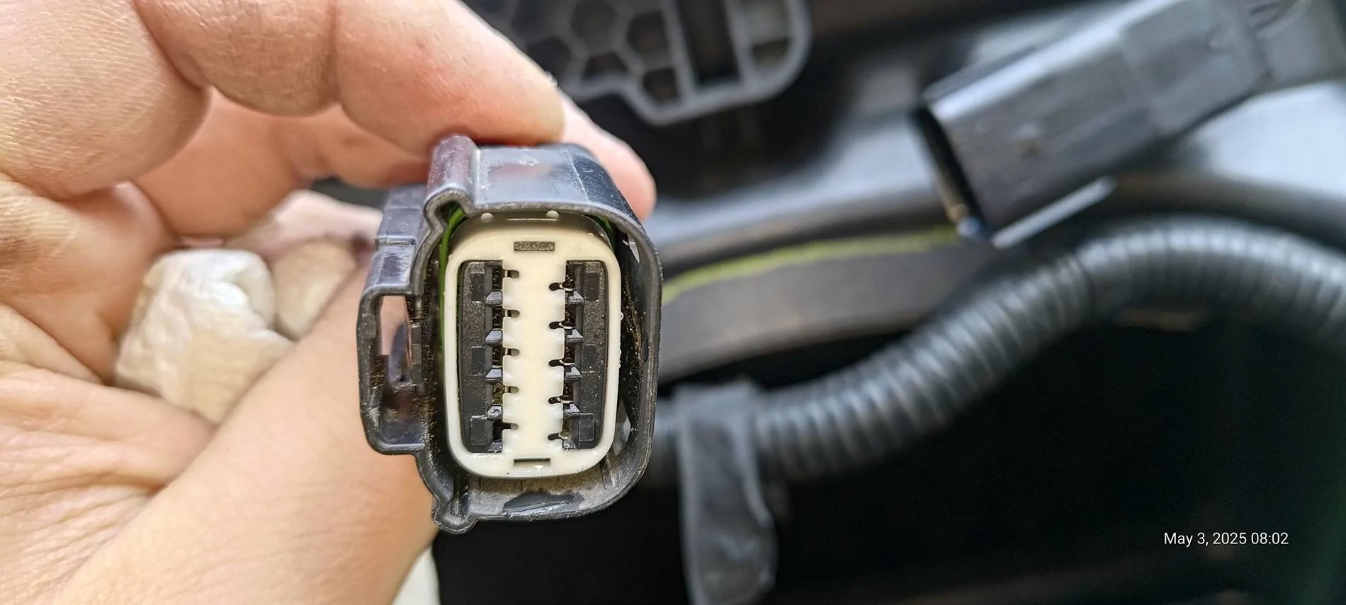

i have the same problem and had it in the shop last week, i refused to pay what they wanted to diagnose so took it apart to see what it could be .and this is what i find on the connector! not happy.

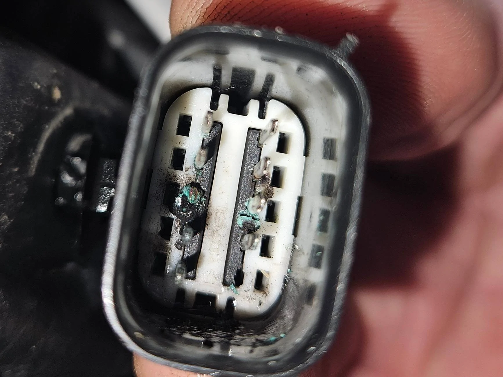

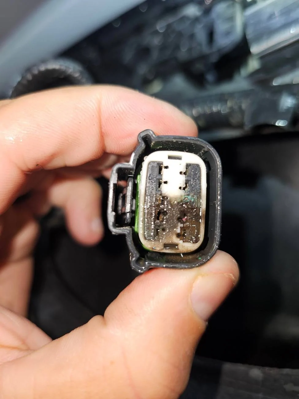

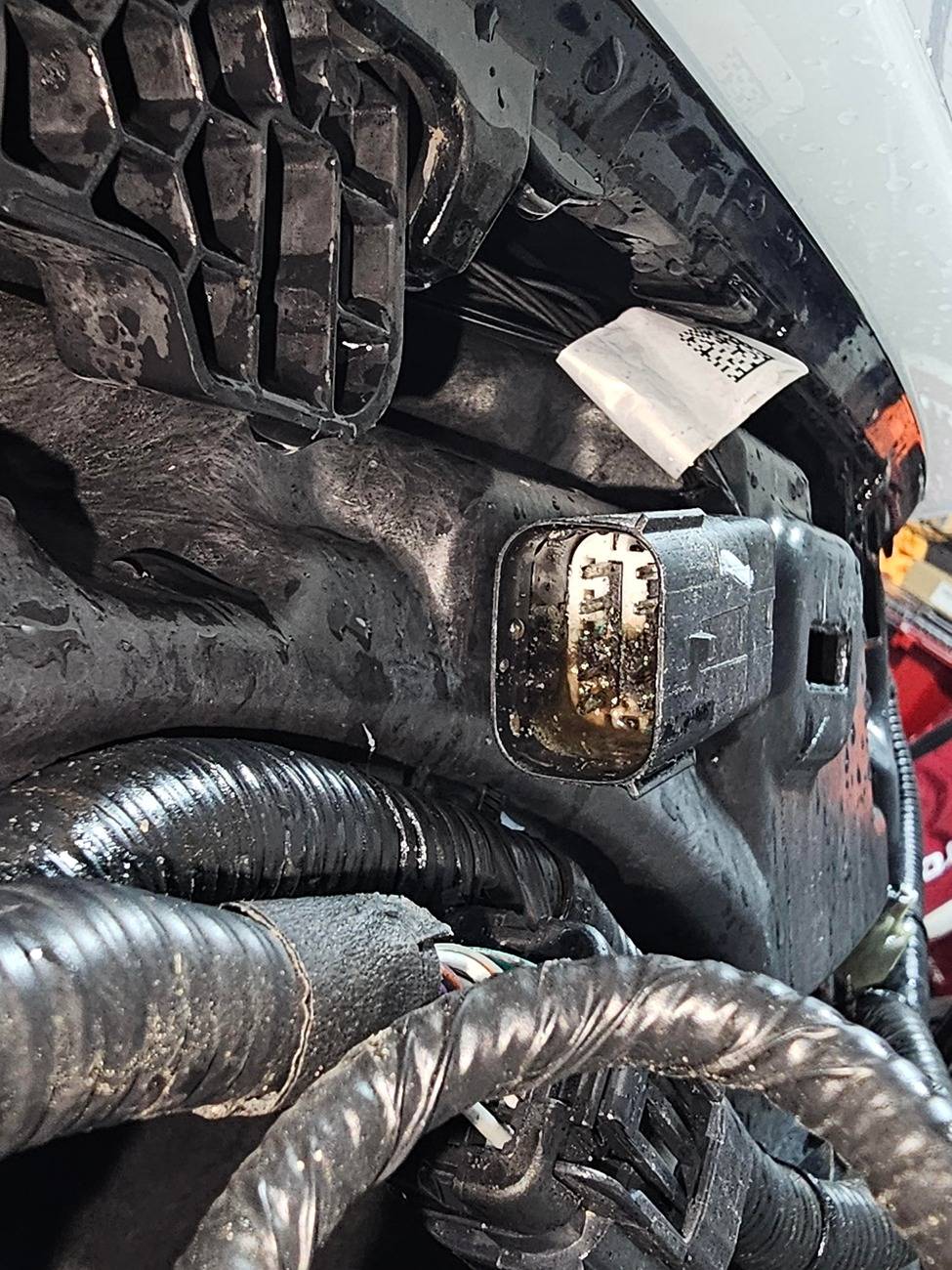

Meant to write this before i posted the pictures. Well color me officially Annoyed... had my truck in for some recent recalls so i asked the service manager if they could diagnose why the front light bar is half out. the said since it outside Bumper to bumper 44K miles i would have 2 pay 175 buck fee for diagnostic and they might need it for 2 days as the tech's need to get into all the panels and such... dropped the truck off Friday they had Saturday and Monday no calls, so i followed up. still said they needed it for recalls. Ford letter said 1/2Day work? Monday night Service manger calls back, apologizes said do i really need them to look at the light bar, its gonna be at least 5/6 hours of work, to figure it out and if its not deemed to be under warranty you will have to pay, so I said at this point no, since i was paying out of pocket for loaner. 50$ day. he said they could finish recall work tomorrow, which they did and i picked up Thursday night. He was nice enough enough to comp 2 days of rental since he agreed it shouldn't have taken that long and they had the parts. but no luck with light bar.
Fast forward to today. I decided to take e a look at myself. I pulled the trim and front grill all of 20 mins work. (thanks for the detailed write up @@shoopg) and when I pulled of the light bar electrical connectors plugs I see the tell tale signs of Green death on the electrical pins. and then the main plug is so corroded that one of the pins has completely corroded away!!! there is minimal waterproofing IMO on the connectors themselves but still this shouldn't not look like this on a 2 year old truck. there was lots of moisture behind the grill as it had rained the morning I decided to do this so to me there is a major design flaw and I'm guessing will be happening to many of us unless ford changed the design / location of these connectors.
What do we think this should should be covered under electrical warranty for BEV? or should ford consider this for recall. I really don't think i should have to pay to have this fixed. also if anyone knows the part number for the harness itself let me know as i cant find yet...

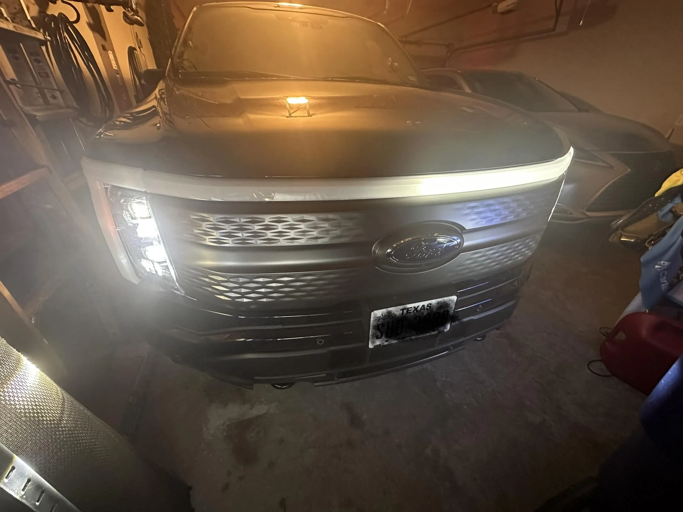

Anyone else having issues with their front light bar partially lit? Noticed last night the section around the passenger headlight and half the frunk not lighting.

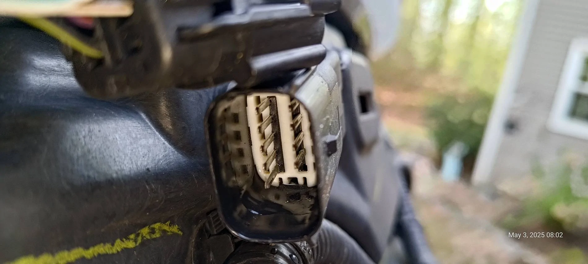

Just happened to me at 60k miles, connector looks okay, even though there was a decent amount of water. I dried it out and added dielectric grease. But I did noticed that the passenger side has a very faint blinking section

Did what you do help at all?
